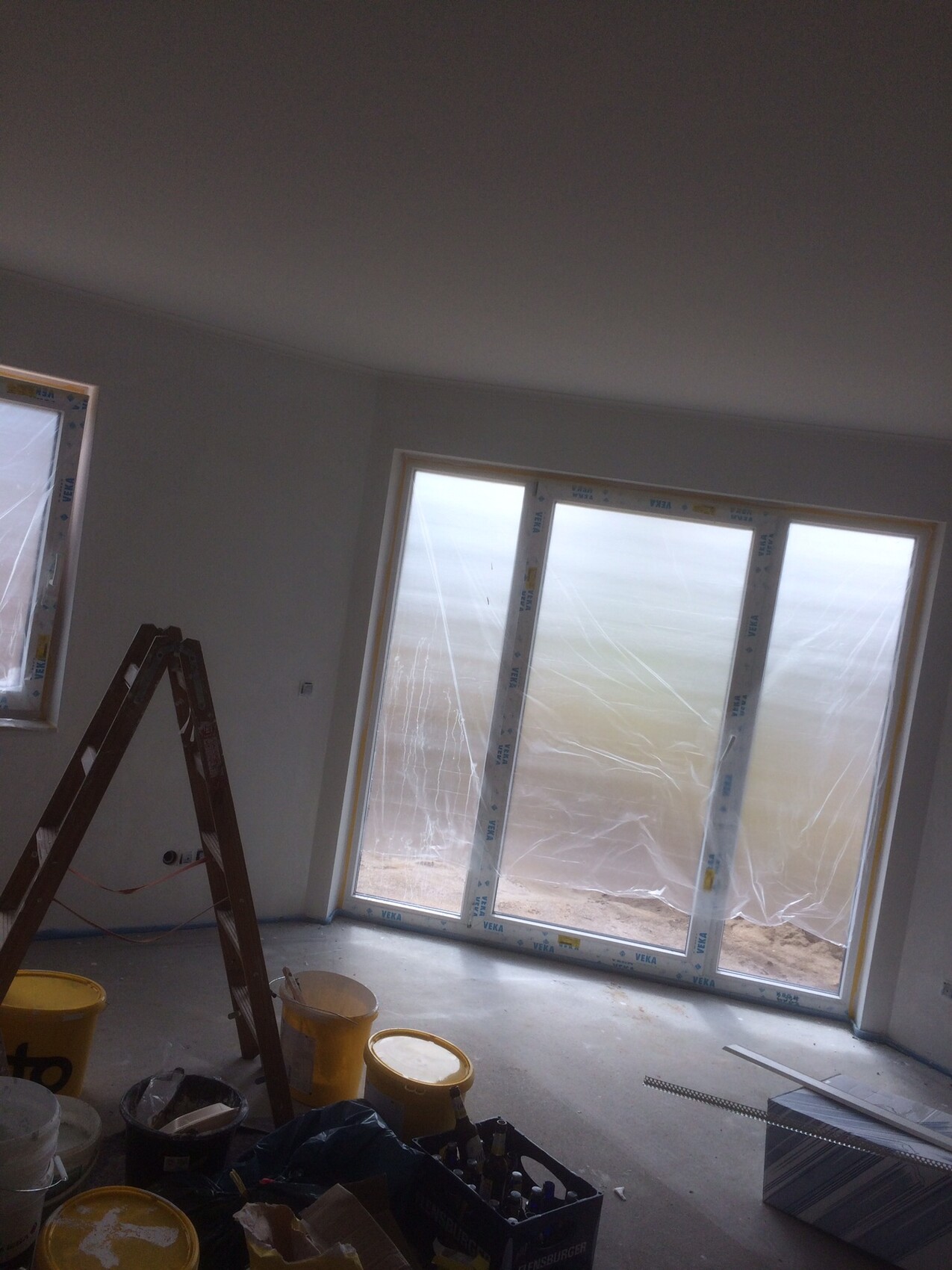

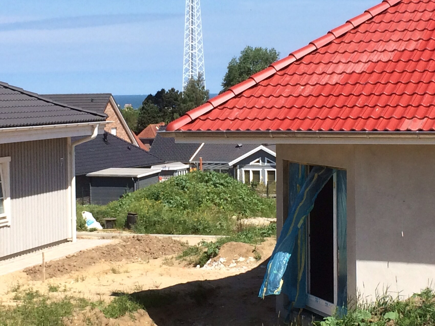

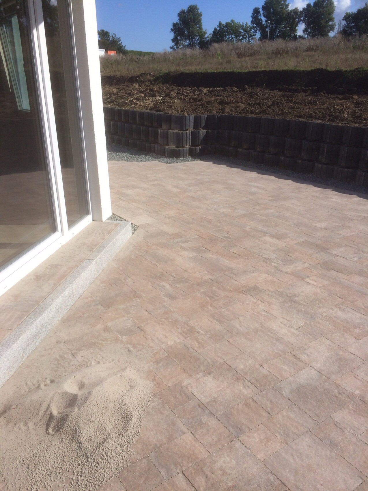

We have a house like this. We had to save some floor area ratio, so this was a solution. There were no additional costs, and we find the interior quite satisfactory and the exterior practical. I might add a support post later for aesthetic reasons, but it is not required structurally. Karsten
