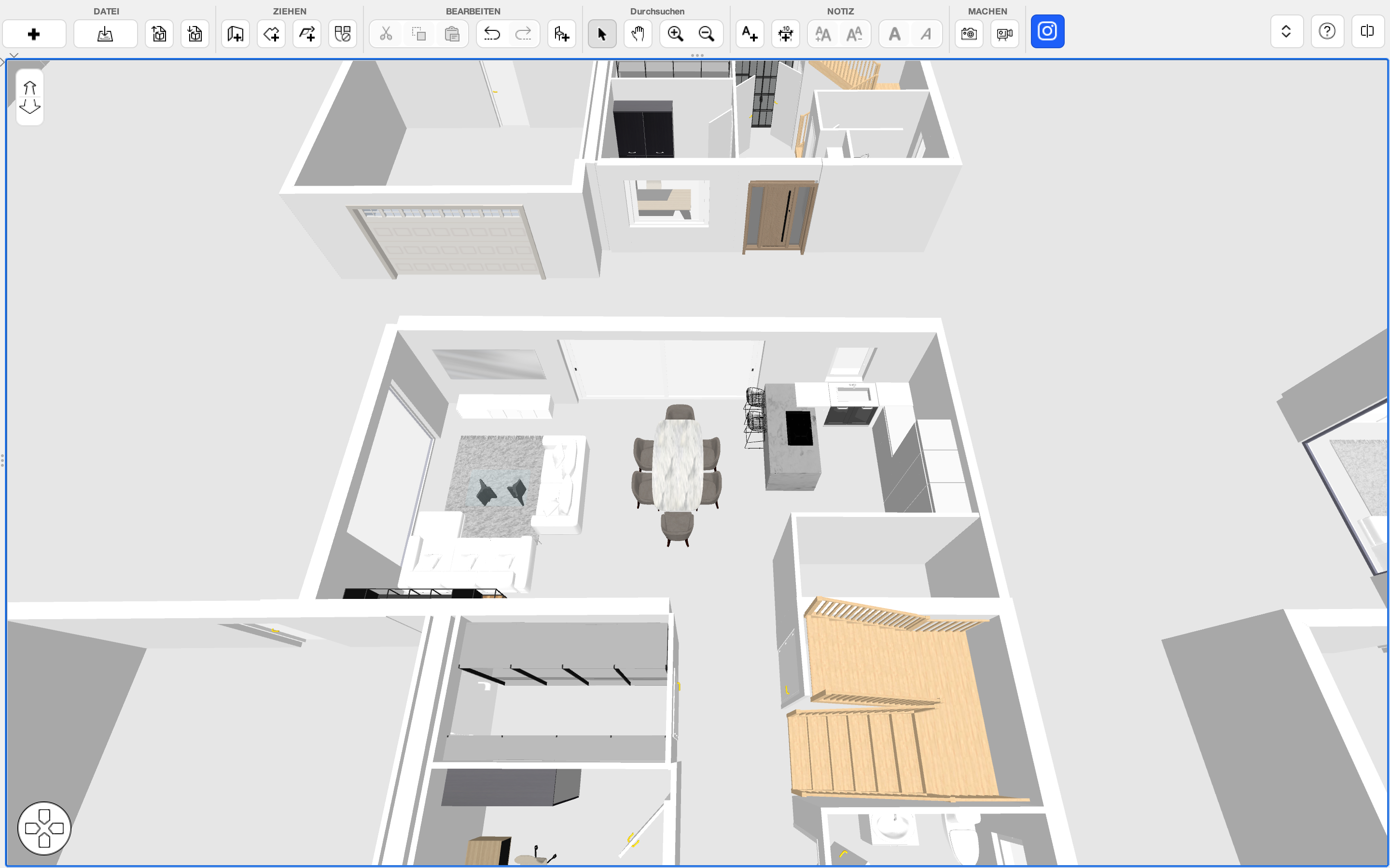

We are currently planning the construction of our house in Lower Austria, and I would really appreciate your feedback on our floor plan. I’m 22, my partner is 26 – he is financing the house. Because of that, it’s particularly important to me that the floor plan fits perfectly and that we don’t build in any costly “mistakes.” I’m in the process of optimizing it, but the longer you look at it, the more you get blind to it.
I welcome any comments, criticism, and suggestions for improvements – whether it’s about circulation paths, storage, lighting, furnishing possibilities, or just “this feels impractical” – these are exactly the things I’m trying to fix right now.
In addition, I have a few specific questions where I’m particularly unsure (list follows):
If anyone could answer or comment on even 1 or 2 of these points, I would be extremely grateful. Many thanks in advance!

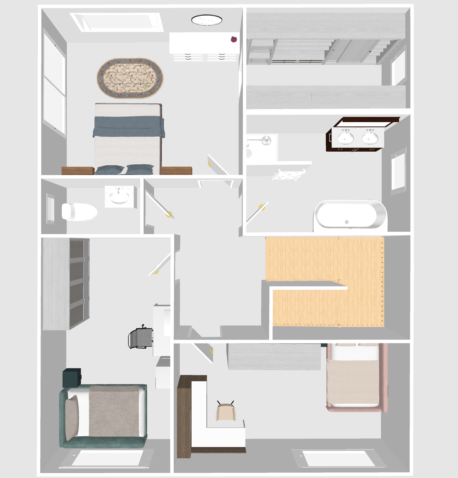

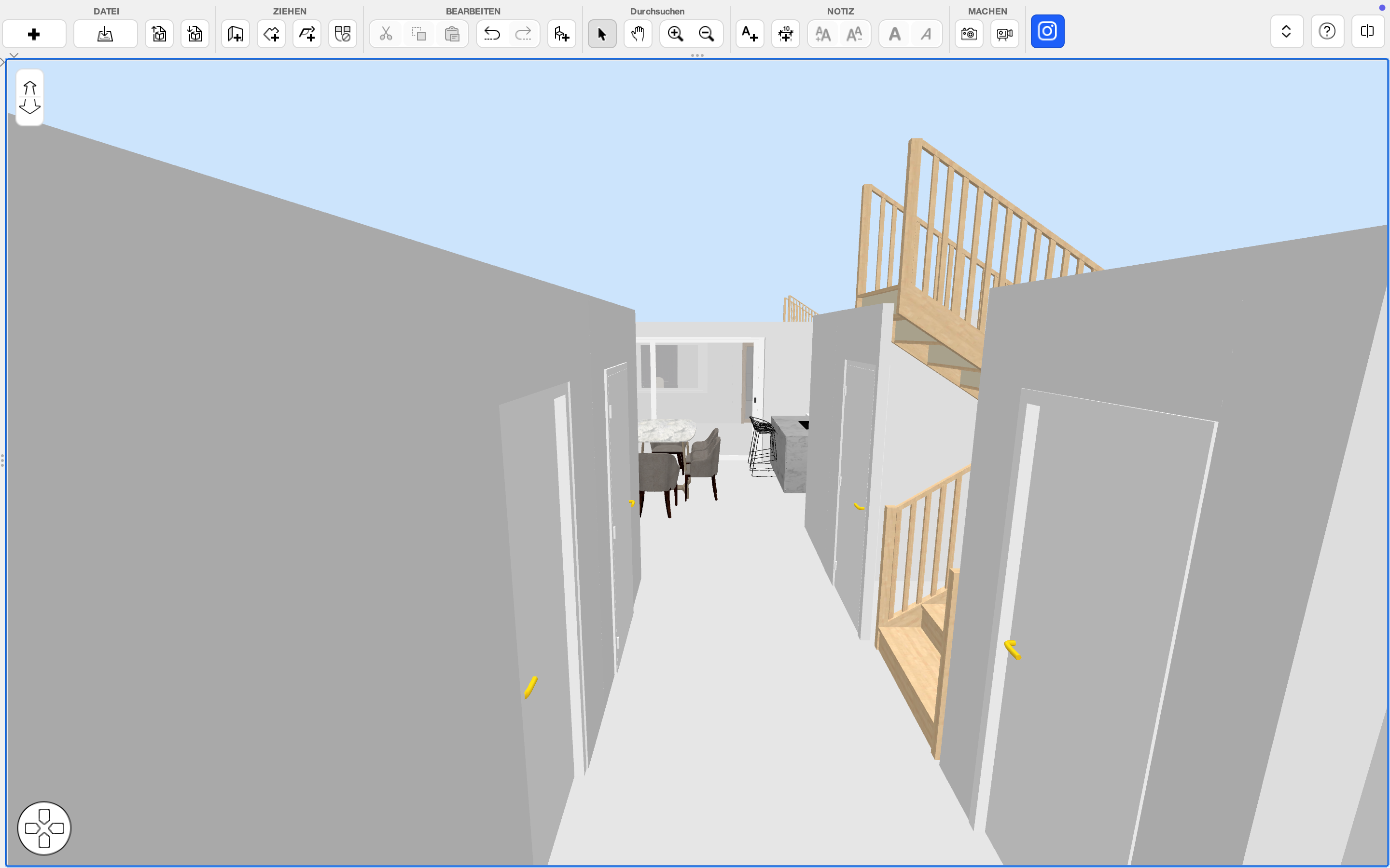

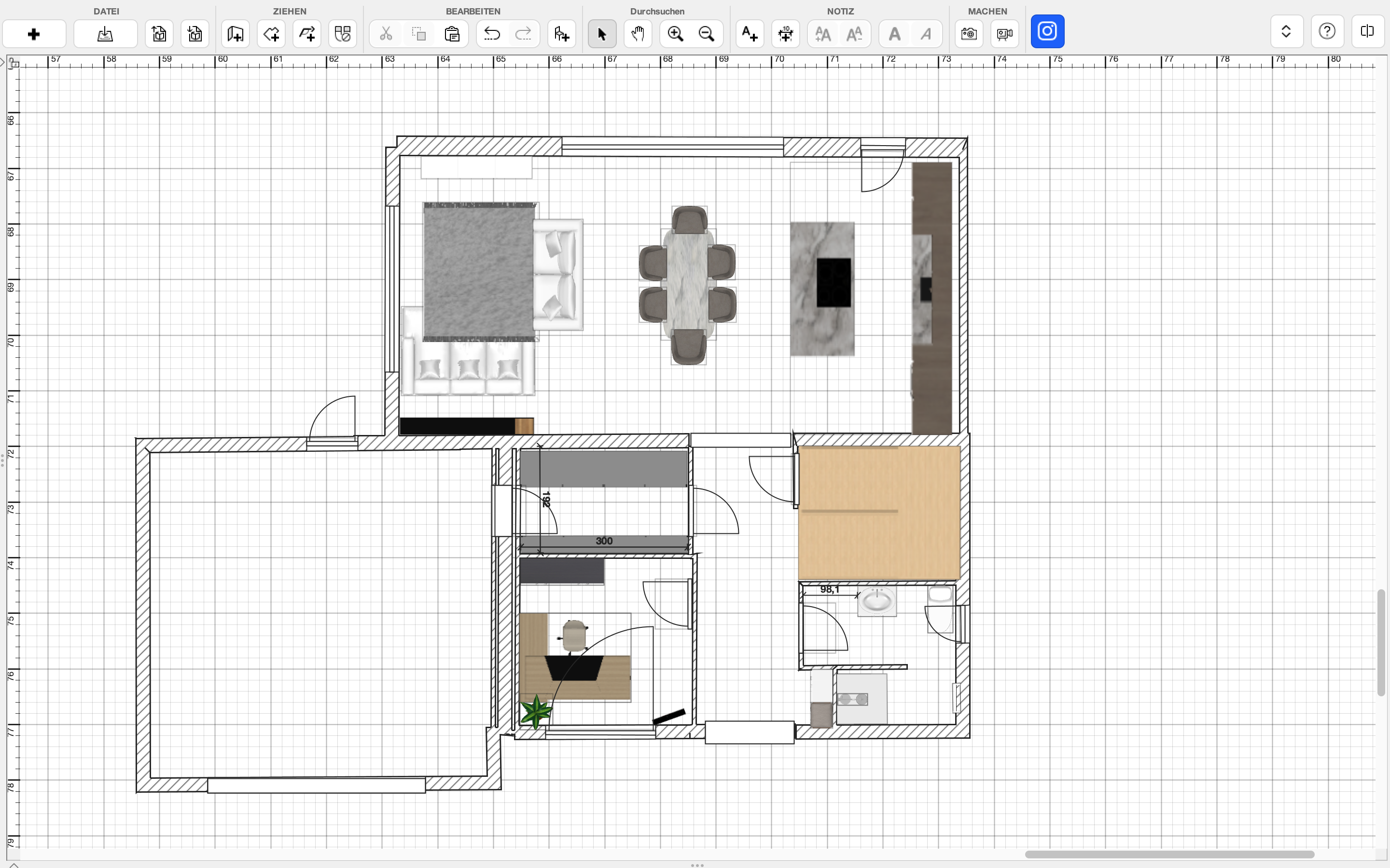

- Door swings – my partner would prefer all doors to open outward, which I don’t like at all… For which rooms would you solve this problem differently? If the doors open inward in different rooms (e.g., office, both children’s rooms), how far from the wall would you position them?

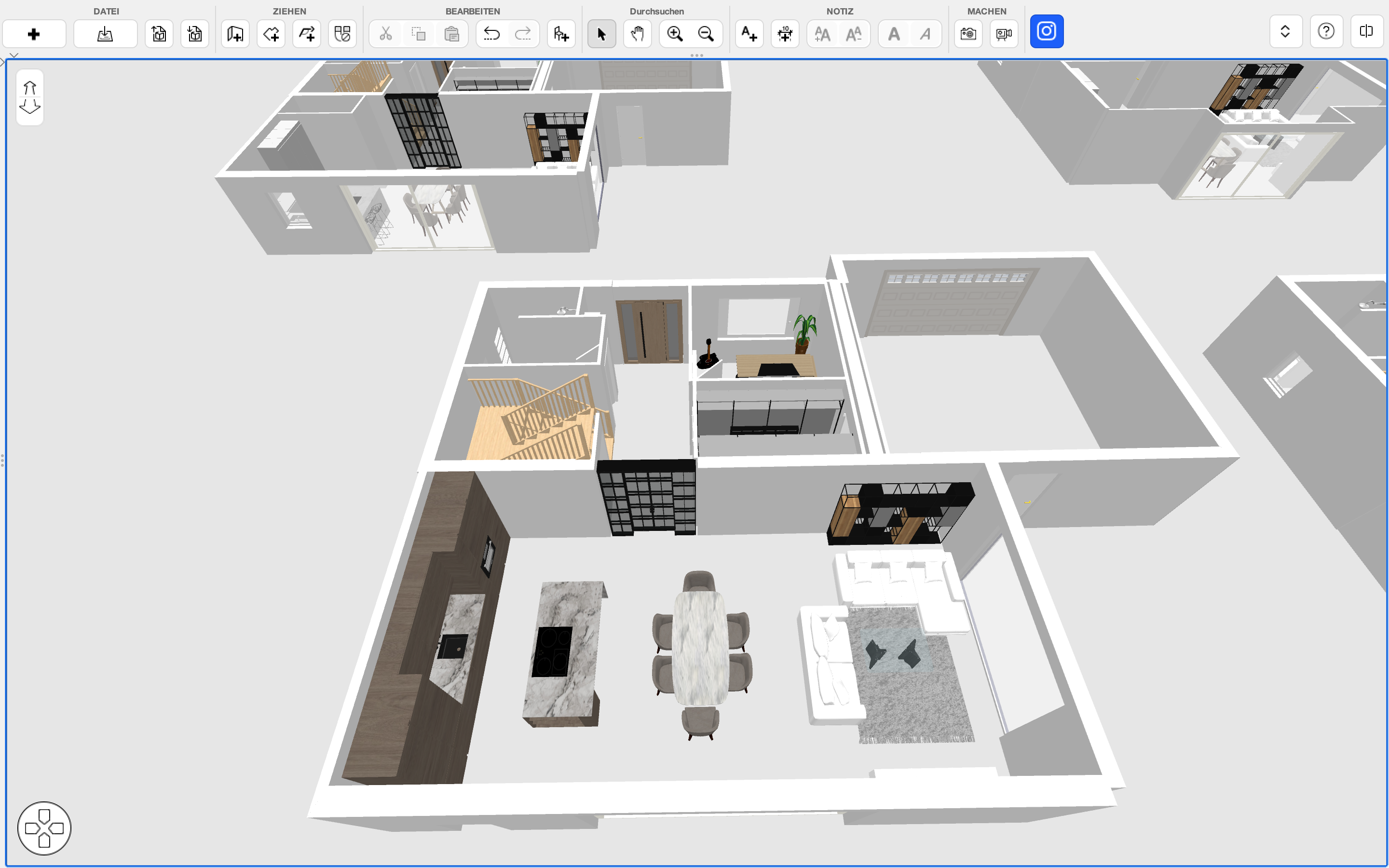

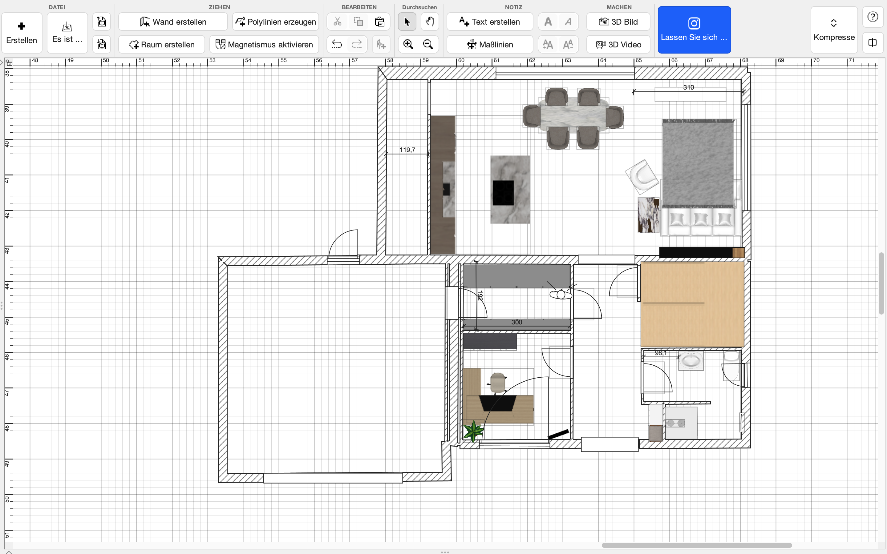

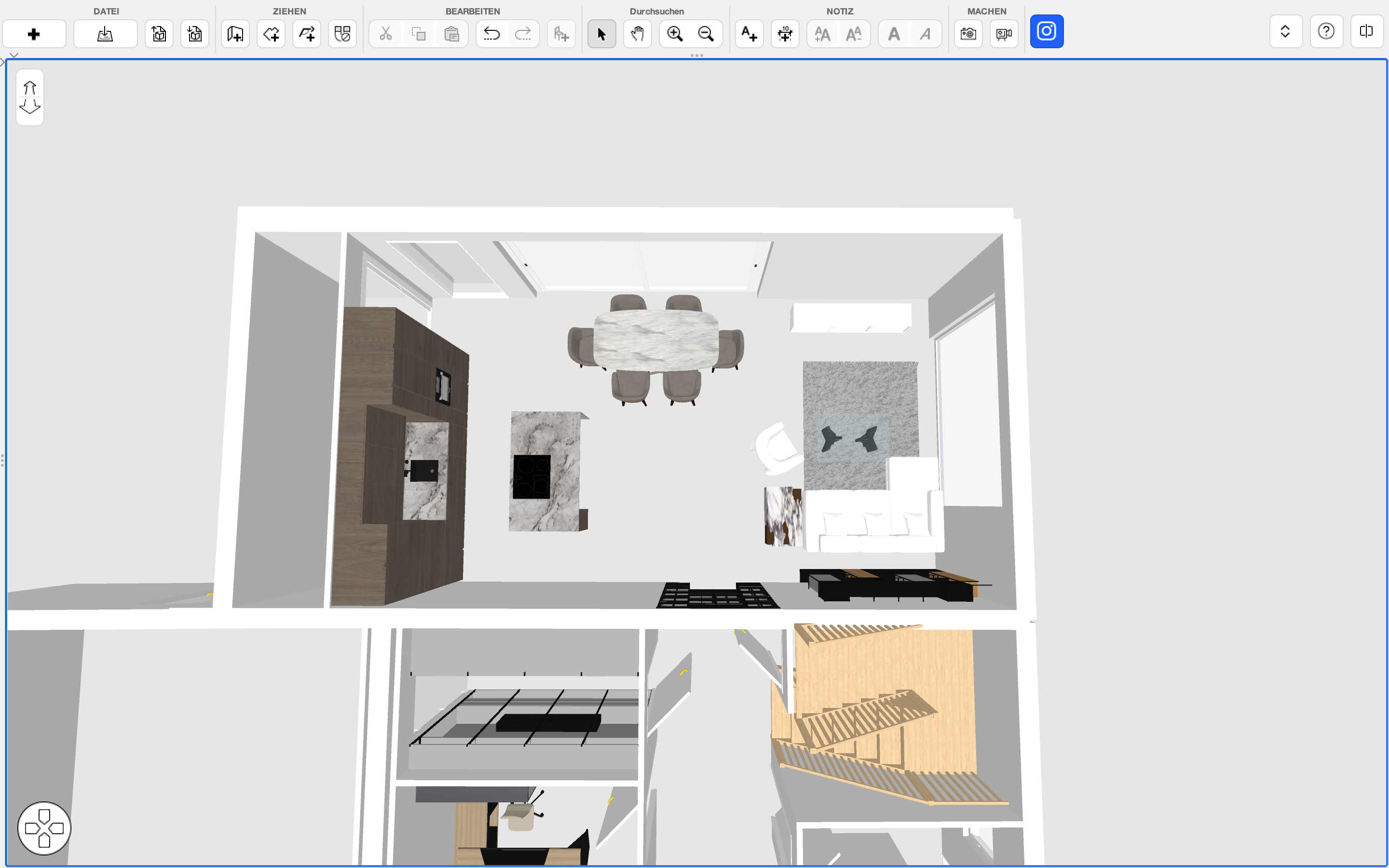

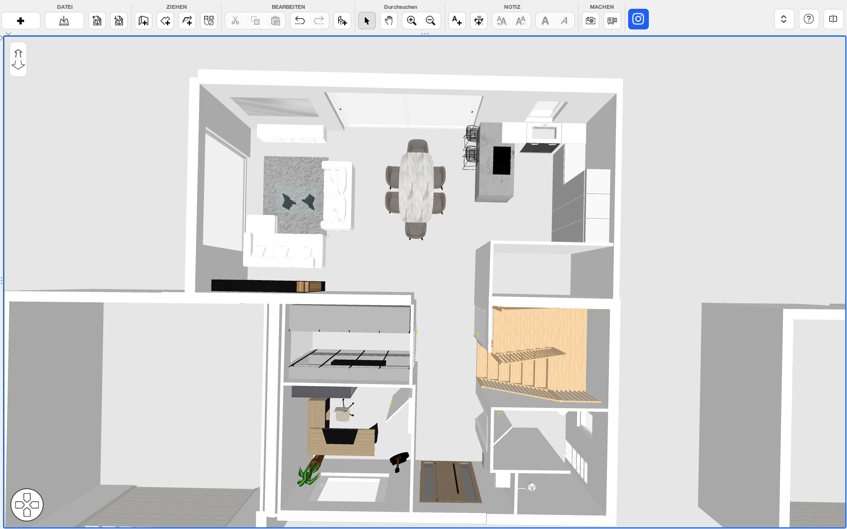

- I’m also not completely satisfied with the kitchen layout. Due to a lack of storage space on the ground floor, we’d likely keep the pantry but we’re currently unsure how. Ideally, if money were no object, I’d want a concealed pantry and as much cupboard space as possible, but that is expensive. If you have any suggestions about the kitchen layout, please share them (the furniture is only placed provisionally, but the location of the stove, sink, and dishwasher should work similarly) – would you put the window above the sink at a sill height of 1.15m (45 inches) (with a 95cm (37 inch) countertop height) or have it flush directly with the countertop?
- How would you place the door in the cloakroom? Currently, we have 60cm (24 inches) space on one side and 38cm (15 inches) on the other. I’m considering whether it would be smarter to leave at least 66cm (26 inches) at the top side for deeper cabinets and some clearance from the door (and possibly only a narrow shoe cabinet or a bench at the bottom side) – or to move both doors down to the bottom of the room and keep the rest as a more open passage (perhaps for a stroller or similar).

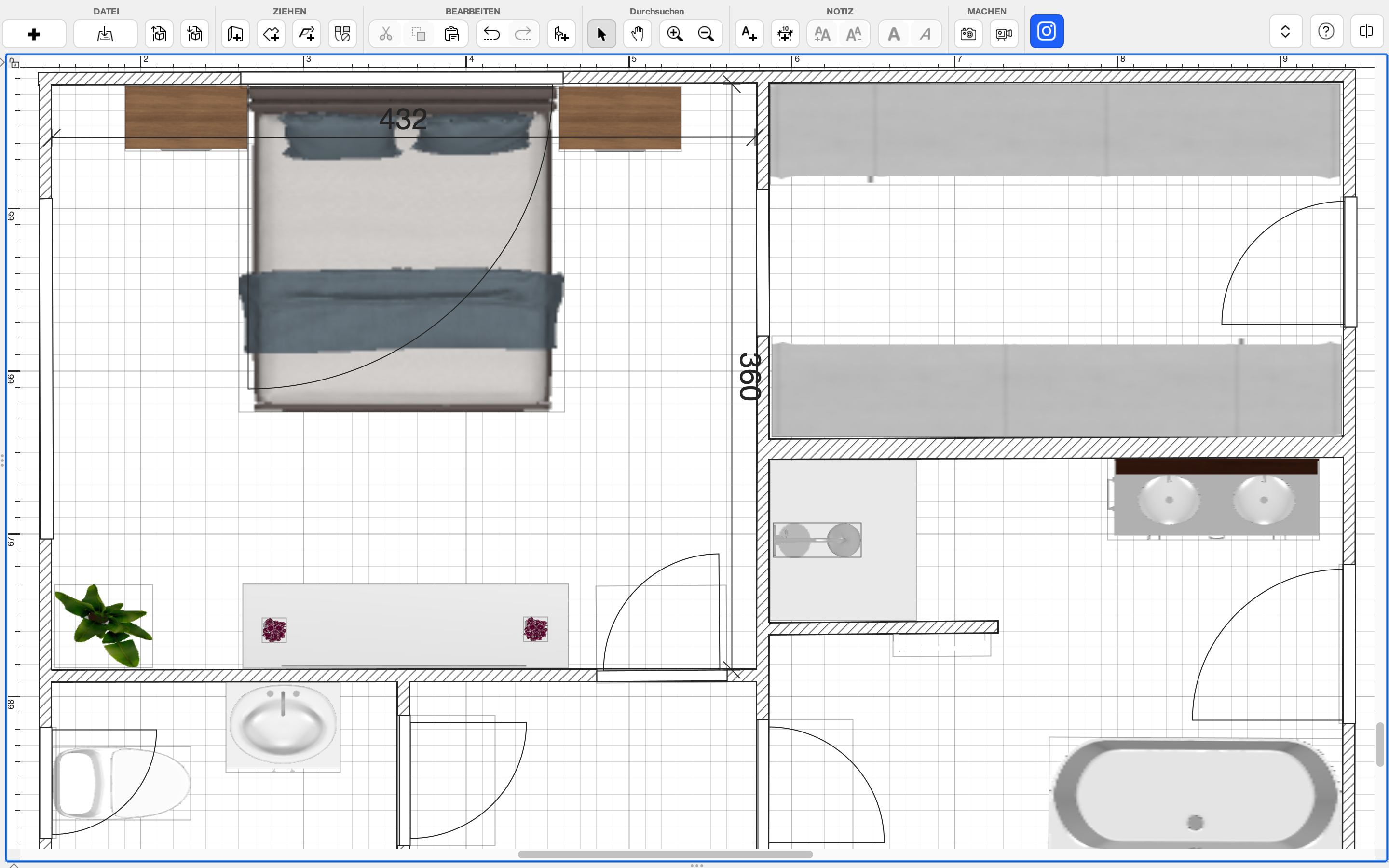

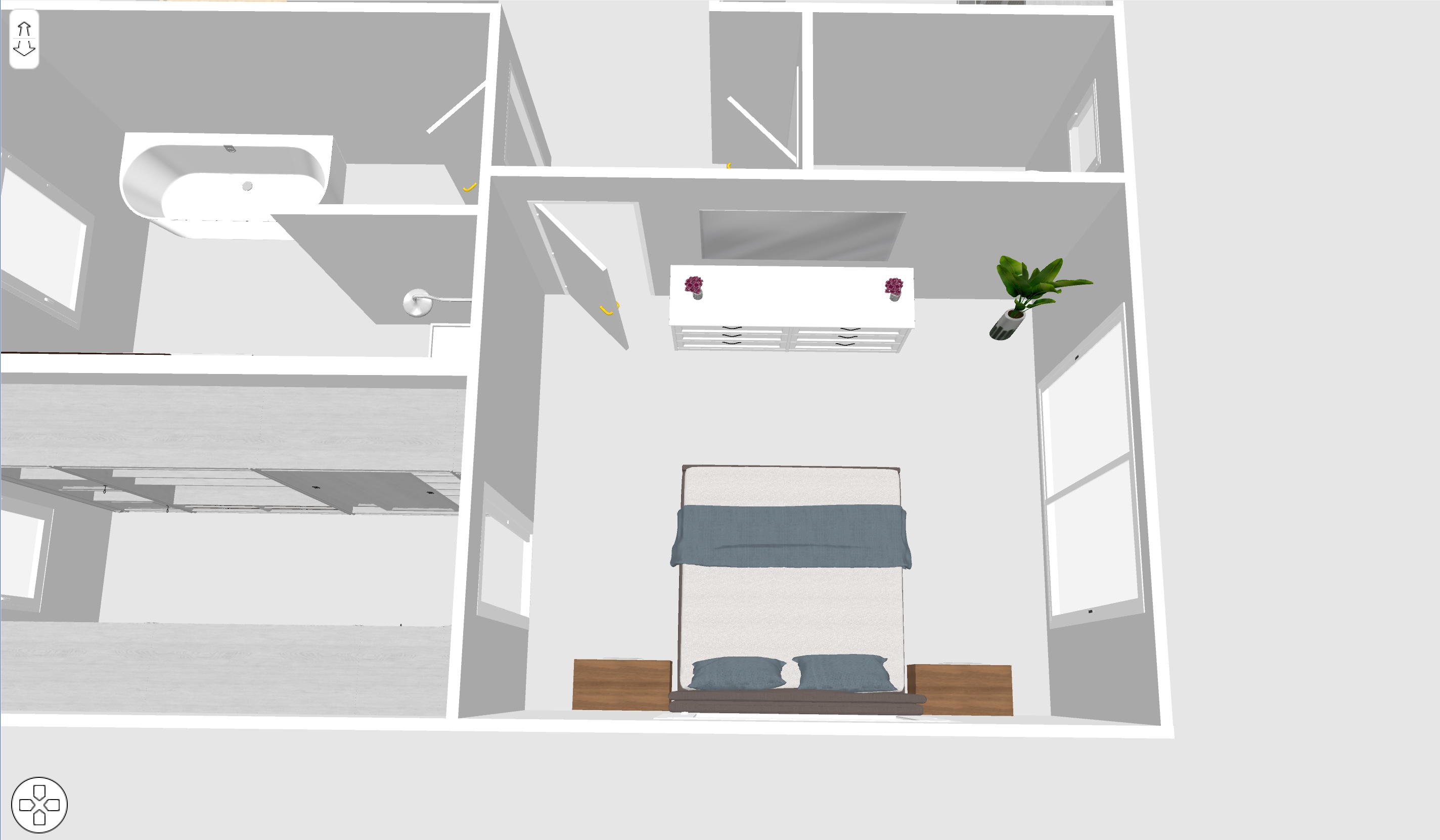

- The office might later be converted into a bedroom (see picture). However, both the 3m (10 ft) wide office and the 2.75m (9 ft) wide children’s bedroom 1 above currently have a window measuring 1.98m (6 ft 6 inch) wide and 1.32m (52 inches) high – would it be better to make these windows a bit narrower, since a bed might be placed underneath, and also raise the sill height of about 87.5cm (34 inches)? For more natural light, the window could maybe just be made a bit longer vertically, right?
- Upstairs, there is the option to expand children’s bedroom 1, which has a less practical layout, with a 25cm (10 inch) deep niche (making it approximately 14.6 m2 (157 ft2) instead of 12.6 m2 (136 ft2), which I think is easier to furnish). The bed could then be placed in the niche, with the headboard away from the window and the view of the door, and the width would be the same as the office below (windows could be aligned vertically).
- How would you position the windows in children’s bedroom 2? Would you prefer one wide window or two narrower ones on the left and right?
- Do you have any ideas on how the rooms in the basement could be arranged differently?

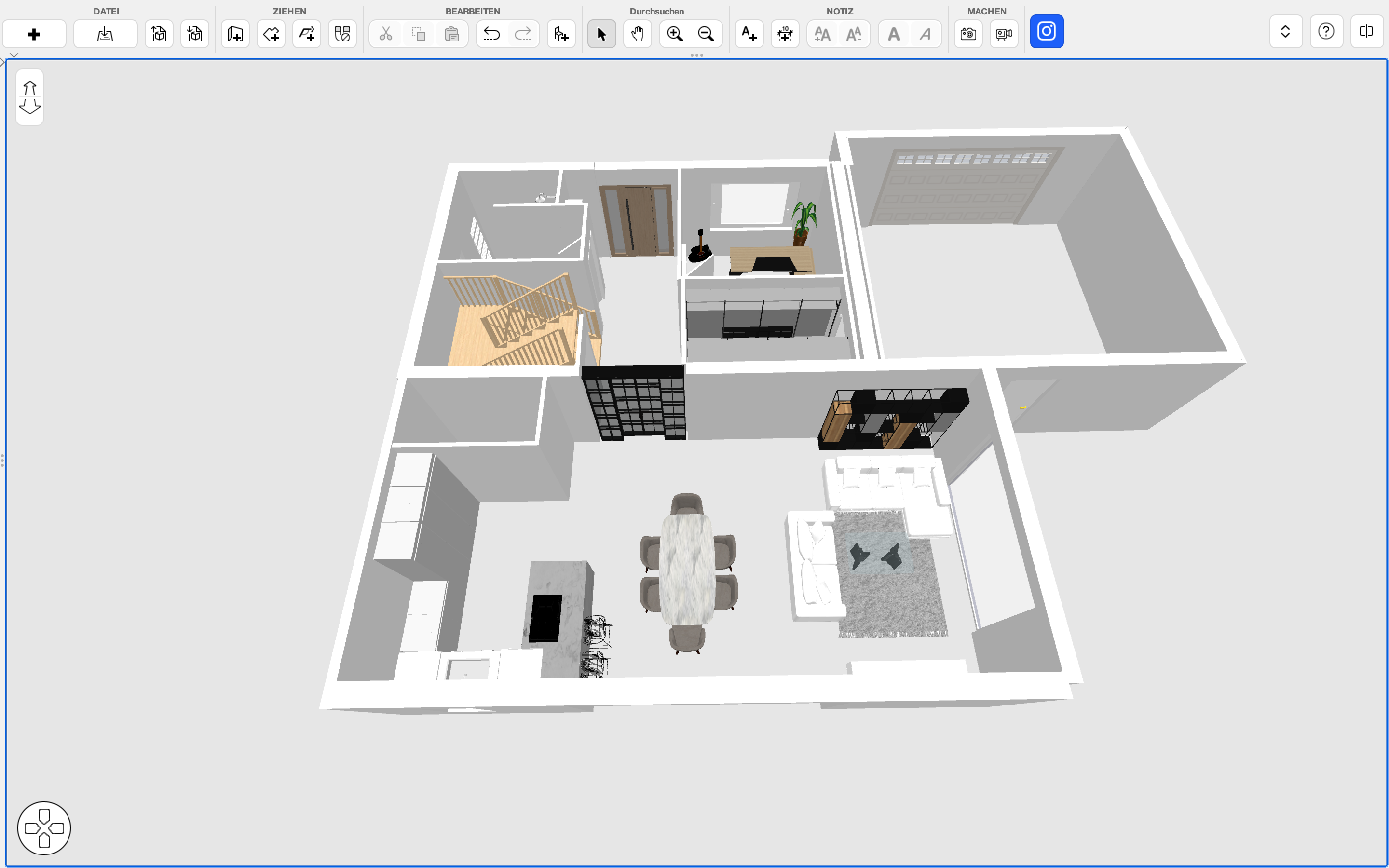

@Papierturm

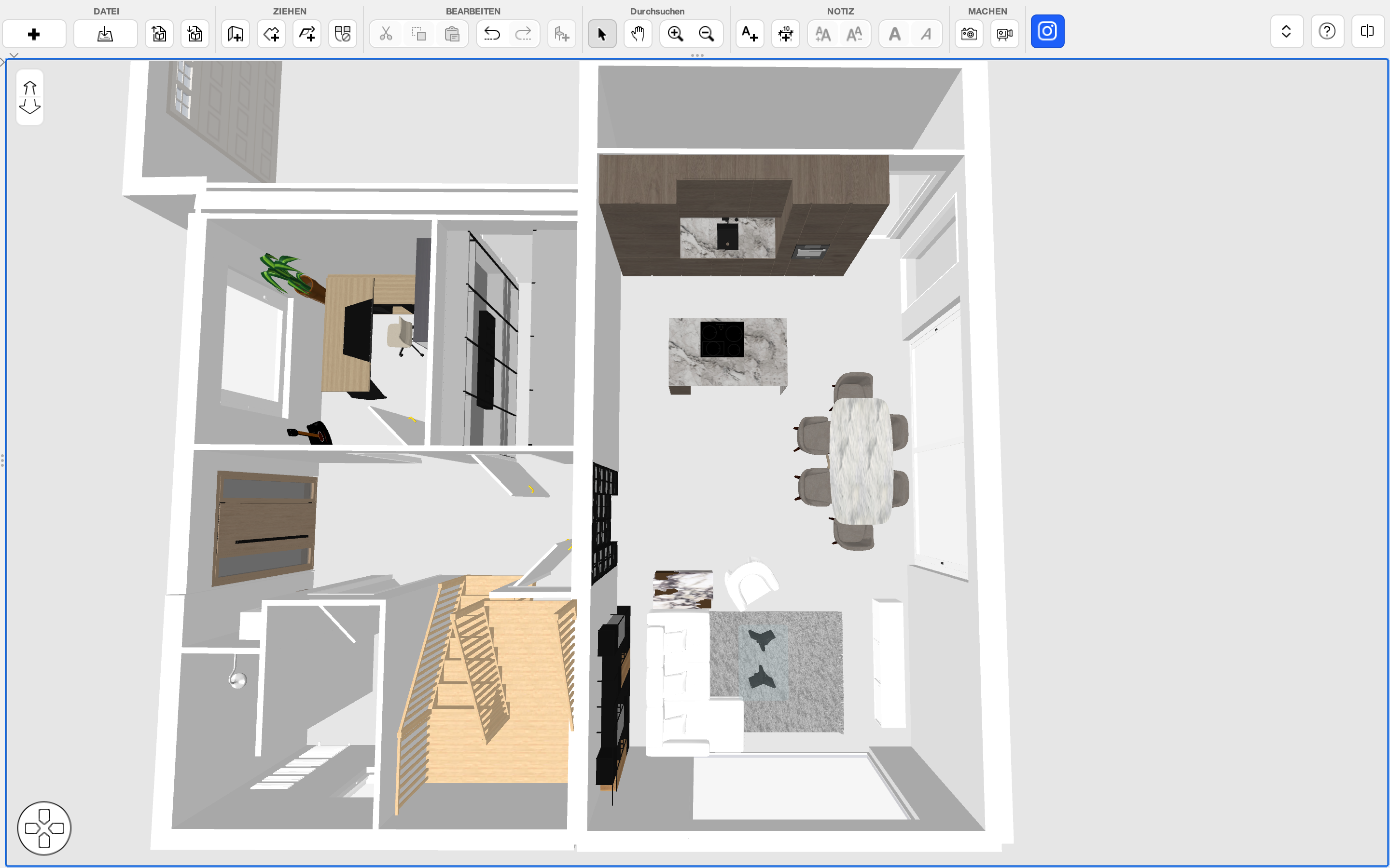

Most interior doors now open inward 🙂 (only the cloakroom and basement doors cannot be done this way)

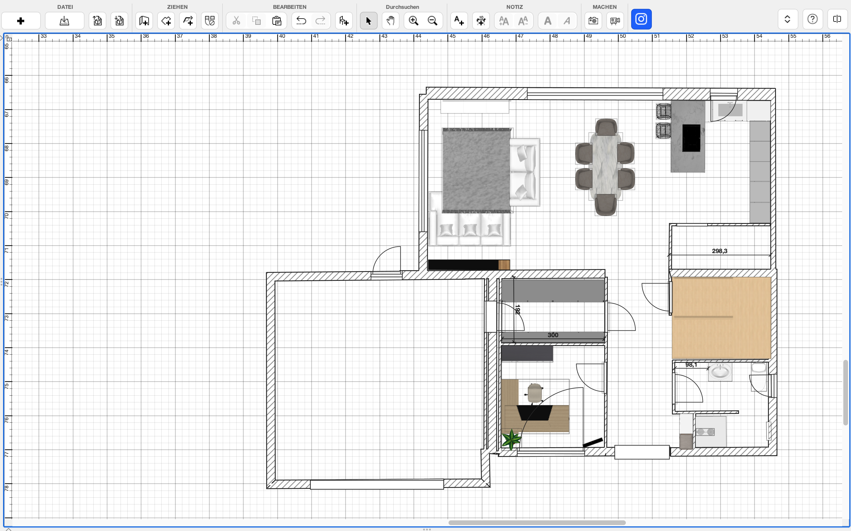

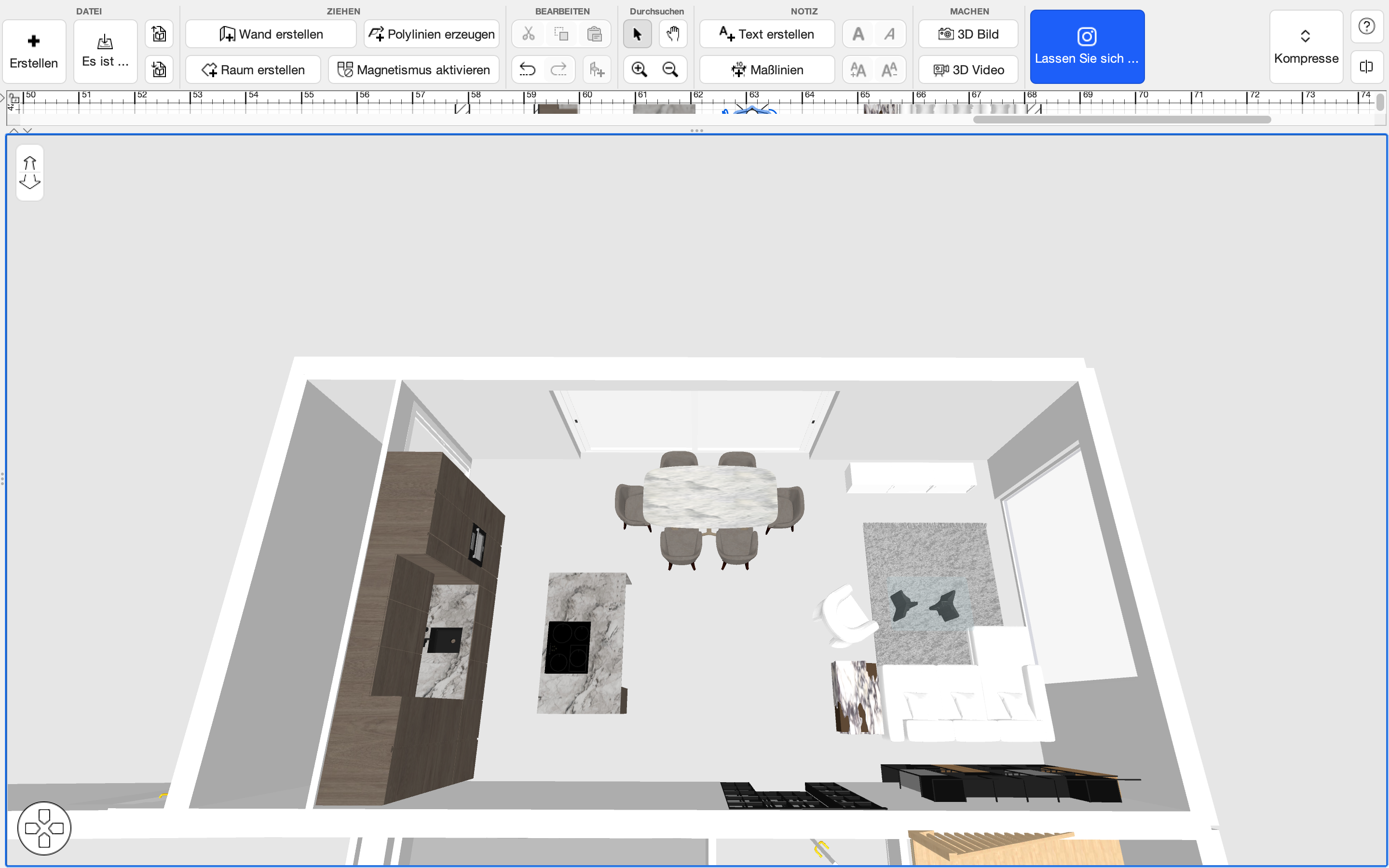

I also tried rotating the living room layout.
The large fixed window is now on the west side.
If you have any comments (for example, preferring a more open or closed area), feel free to share.
Or should I just rotate it back?

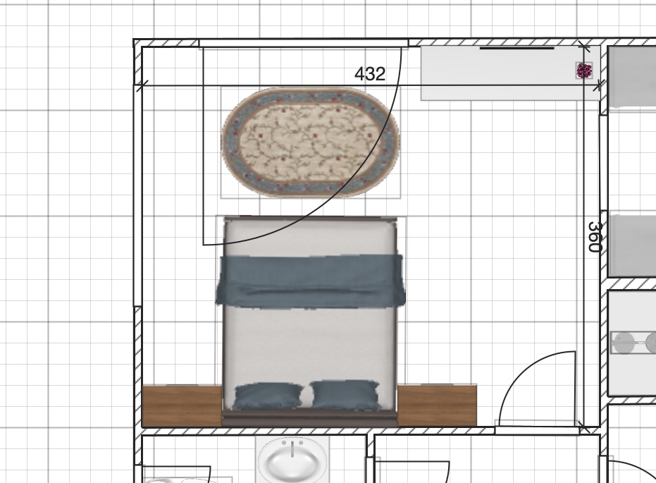

Upstairs, I moved the bed to the other wall. Do you think this could work?
I’m also aware of the window situation (especially upstairs).
In both the bedroom and kids’ room 1, the beds would be placed under or in front of a window.
Do you have suggestions on what the ideal sill height should be? What is a good standard measurement for a window on a 3-meter (10-foot) wide wall?
Would you consider adding or repositioning windows in the kids’ room?
I don’t think the cloakroom will be changed anymore… the niche already took a lot of convincing.

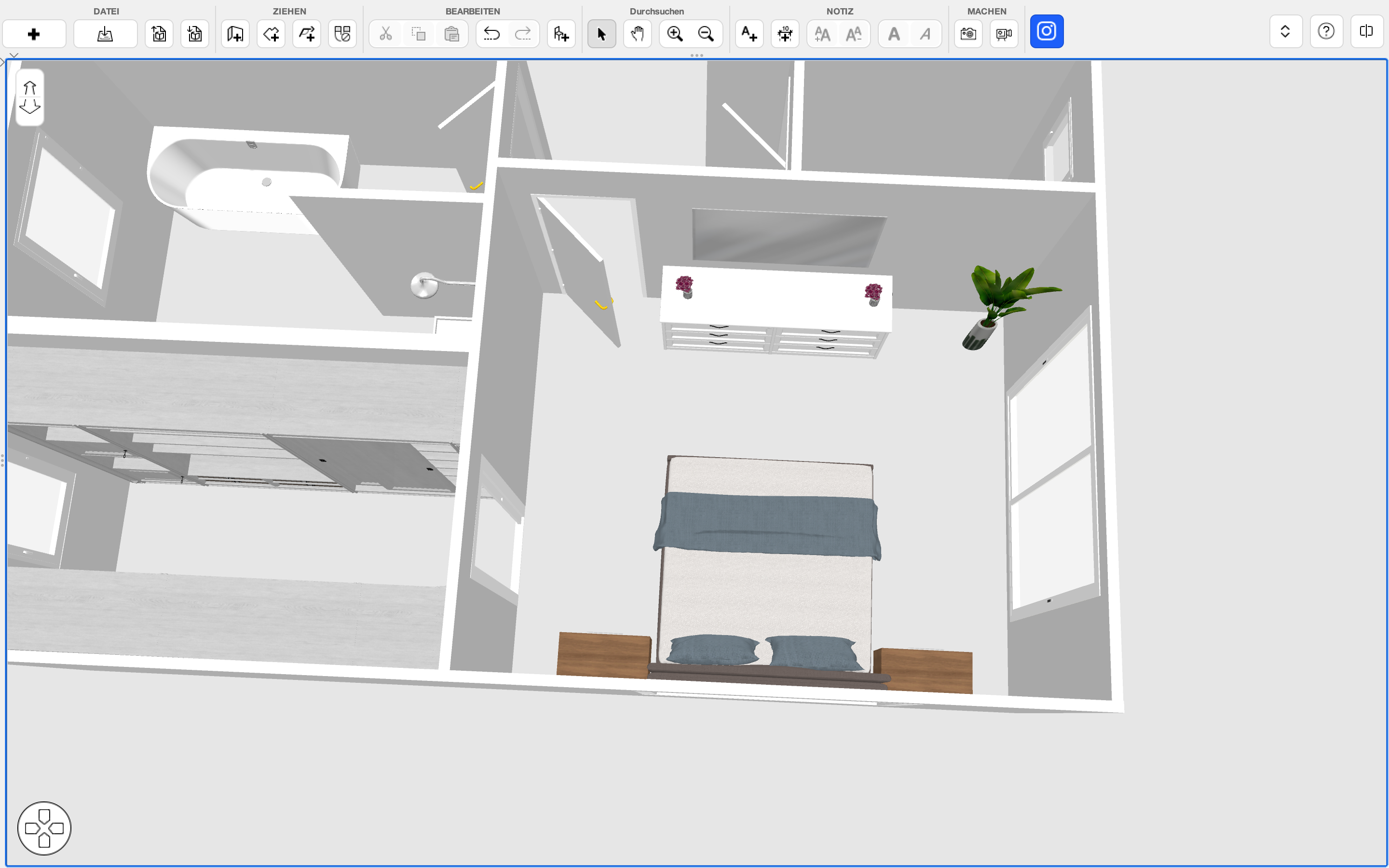

For the bedroom, it’s really just about weighing the disadvantages… head of the bed right next to the door / on the wall facing the bathroom versus having the head under the window and no direct view out of the window from the bed… do you have a preference? Because of the balcony door, we basically need to make a decision here.

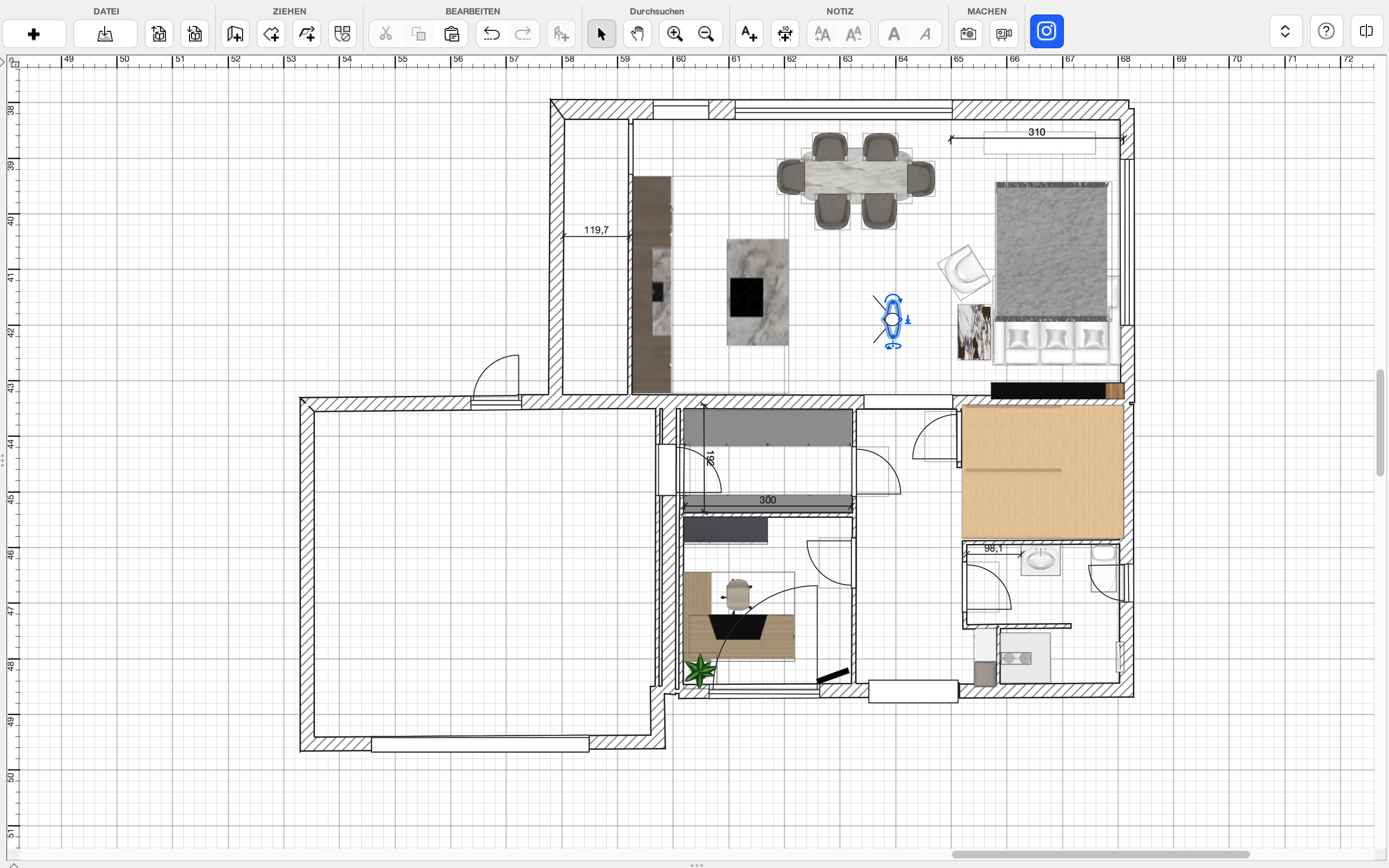

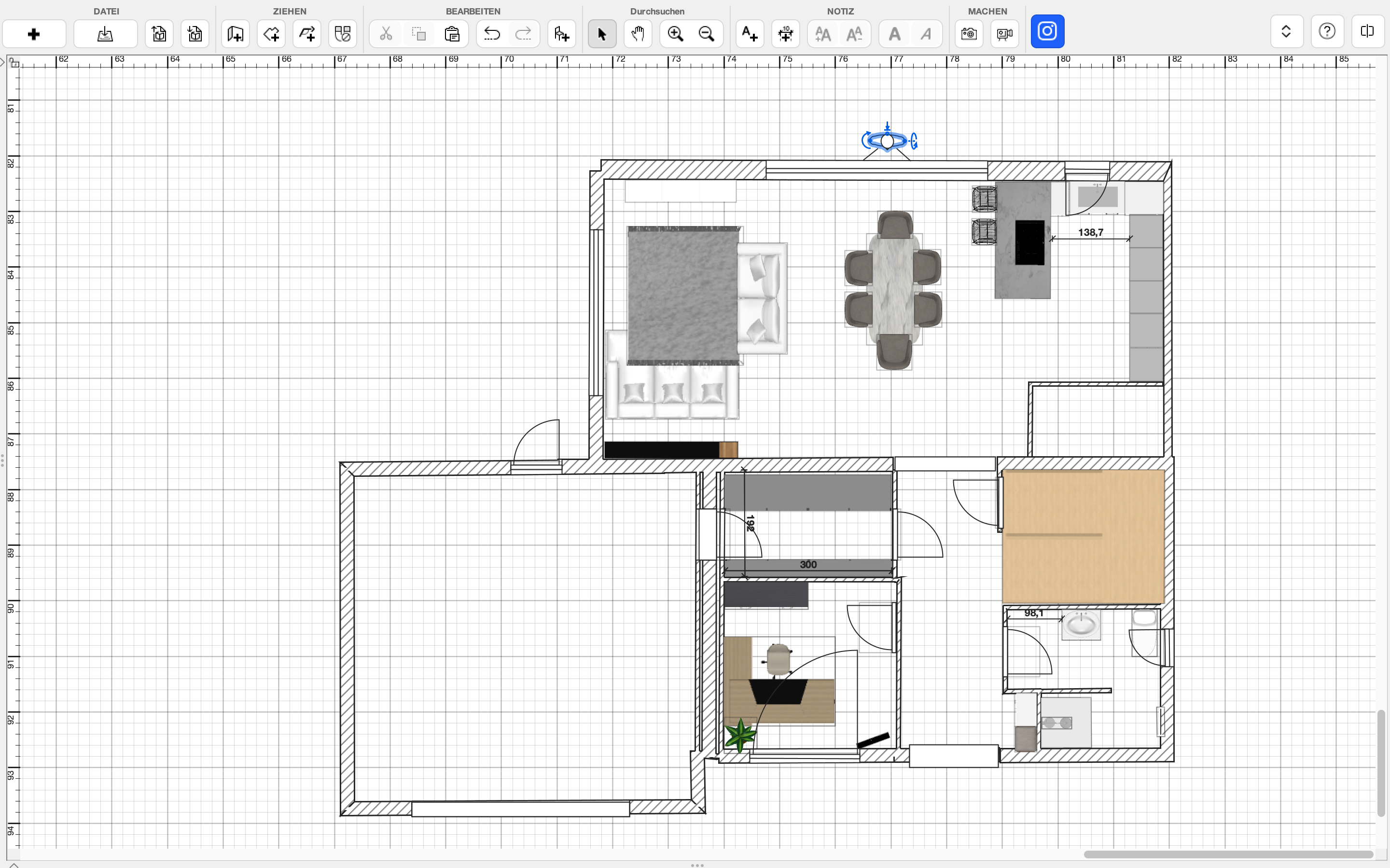

Here’s a new idea.
The room would be shortened by 1.30 meters (4.3 feet) and the pantry placed behind the kitchen.
This would position the door 4.10 meters (13.5 feet) from the left wall (excluding the kitchen) and 3.10 meters (10.2 feet) from the right wall.
Do you think this provides enough space?
I just don’t want to have this bulky structure in the living room…
