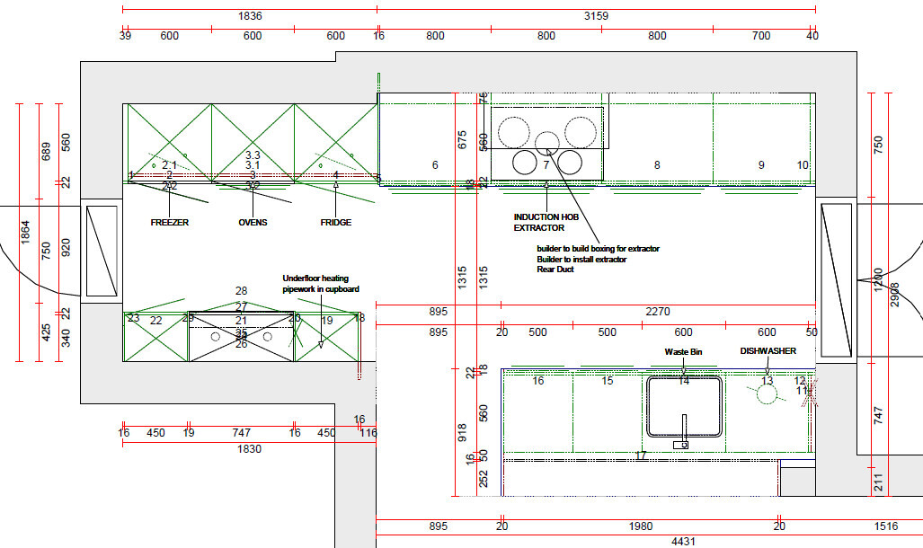

- I’m also not completely satisfied with the kitchen layout. Due to a lack of storage space on the ground floor, we’d likely keep the pantry but we’re currently unsure how. Ideally, if money were no object, I’d want a concealed pantry and as much cupboard space as possible, but that is expensive. If you have any suggestions about the kitchen layout, please share them (the furniture is only placed provisionally, but the location of the stove, sink, and dishwasher should work similarly) – would you put the window above the sink at a sill height of 1.15m (45 inches) (with a 95cm (37 inch) countertop height) or have it flush directly with the countertop?

You could also plan a pantry "in the garage" without taking up space in the kitchen.
I also know that the "hidden door to the pantry" is very popular on Instagram, but it is usually impractical when planning a kitchen. Either it is rather narrow at 60–70cm (24–28 inches) to carry a shopping box through, or it is wider at 80–90cm (31–35 inches) but then looks bulky in the design or requires two small doors that need both hands to open.
It is much more practical to place the door aligned with the corridor between the island and the wall units. Often, you don’t even need a door then:
GeraldG schrieb:
Maybe swap the office with the cloakroom? That way, the cloakroom can also be used from the main entrance, creating a more defined mudroom area.
You could then also plan a pantry "in the garage" without taking up space from the kitchen.
I also know that the "hidden door to the pantry" is very trendy on Instagram, but it’s usually not very practical when planning a kitchen. Either it’s rather narrow at 60–70cm (24–28 inches), making it difficult to carry a shopping box through, or it’s 80–90cm (31–35 inches) wide, which either looks bulky in the design or requires planning two smaller doors that need both hands to open.
It’s much more practical to place the door aligned with the hallway between the island and the wall cabinets. Often, you don’t even need a door then: Yes, I understand the logic behind that, but then unfortunately the office wouldn’t have a window.
Would the pantry still be located in the left corner according to your plan?
