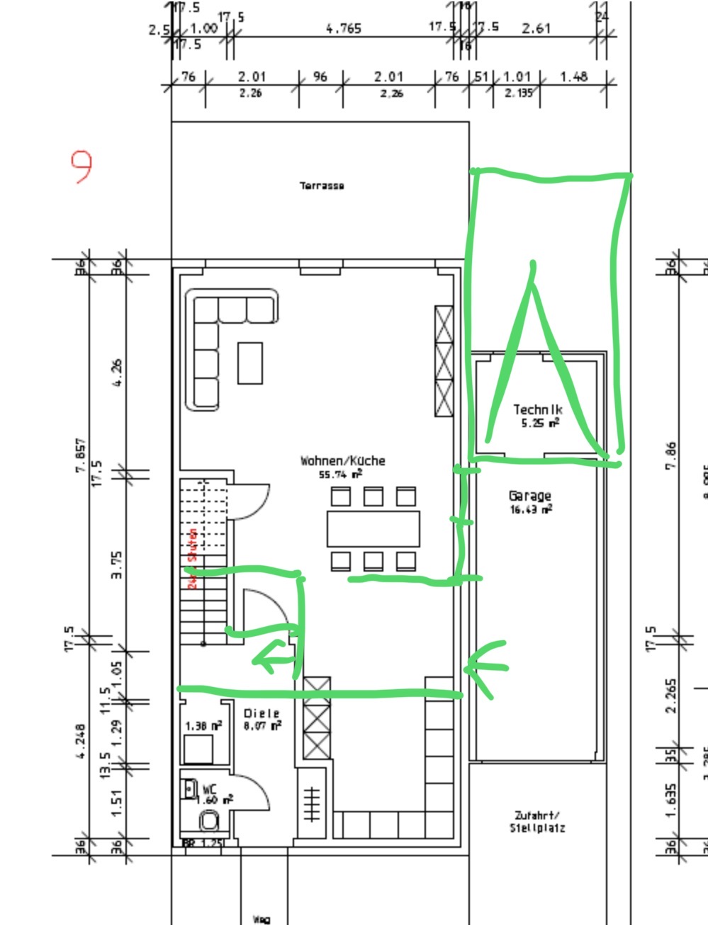

Simon19884 Mar 2026 19:37We can no longer change the general contractor or the architect. We are building without a basement or a penthouse level.
In my opinion, the design doesn’t make sense as long as there is no space planned for technical equipment.
Furthermore, despite the overall size, it is ultimately a small house where you have to manage the square meters carefully. 57 sqm (613 sq ft) for a combined living space is, in my view, completely impractical for a house of this size. I can already imagine this room regularly becoming cluttered due to the lack of any storage space.
Please ask the architect to accurately include on the plan the heating system, hot water tank for 4 people, electrical panel, water connections, and such items as vacuum cleaner, bucket, stroller(?) and similar, all to scale! I’m curious to see how she envisions this.

Simon19884 Mar 2026 20:41The technical room is located behind the garage. Storage space is available under the stairs or in the garage as a substitute for a basement.
Great, this gives us something to work with.
However, I think many points deserve reconsideration—in other words: you should be prepared to learn that these ideas or wishes are difficult, very difficult to reconcile with this semi-detached house.
You almost have none. Under the stairs is a space/area that cannot be entered. It’s only enough to reach in with one step. The utility room is not large enough, nor is there space for tools, gardening items, etc., which you would typically want or need to store INSIDE the house (batteries, temporary garbage storage, shopping bags, some supplies). This makes the house impractical or a collection of scattered spots where cabinets have to be placed.
Even if an office is not absolutely necessary, there is often a family workspace with a printer and folders. Gift wrap, greeting cards, decorative ribbons, etc. Alongside a hole punch, stapler, and writing paper, which could fit in a drawer, there is a lot of necessary paraphernalia in a household with children. Therefore, a suitable room would make sense for a family of four.
And where are you going to park the car? In front of the garage?!
Completely pointless in standard semi-detached houses of this width. At 5 meters (16 ft), a quarter-turn staircase would be more sensible; at 6 meters (20 ft) width, a half-turn staircase. It develops from the rooms on the upper floor. If you ask why, just look at this snake-like, impractical hallway upstairs. Of course, you can swim against the current, but not with 4 people, your budget, or the other constraints.
Placing technical installations outside the building envelope is not practical. It is also more expensive because you expand the thermal envelope outward.
There is no room for a walk-in closet here—it is true luxury for the parents at the expense of others.
Don’t plan for conversion later… plan the rooms correctly from the start, then the spaces will be satisfying.
Children’s rooms belong on the light-facing side, bathrooms should be stacked. No ballroom-sized open space. Plan effective widths in meters (feet), then there will be no wasted areas or decorative corridors. Simple, compact design creates the feeling of spaciousness in most houses.
As an example, a quick sketch as support for the upper floor:

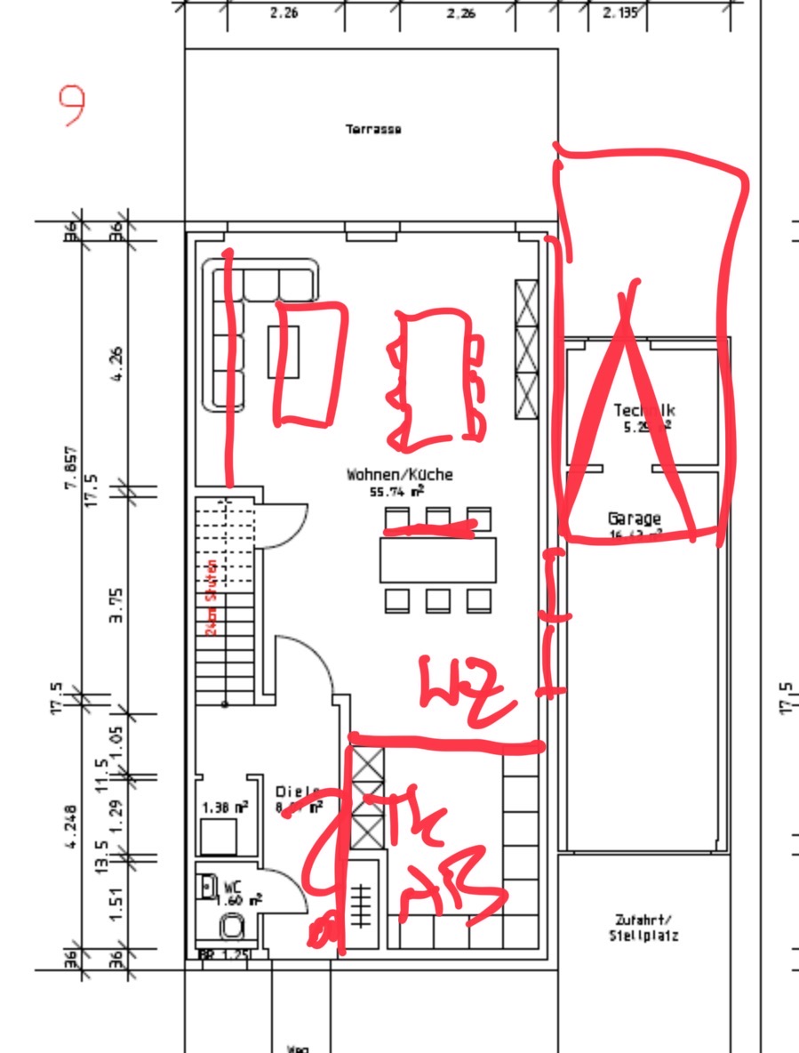

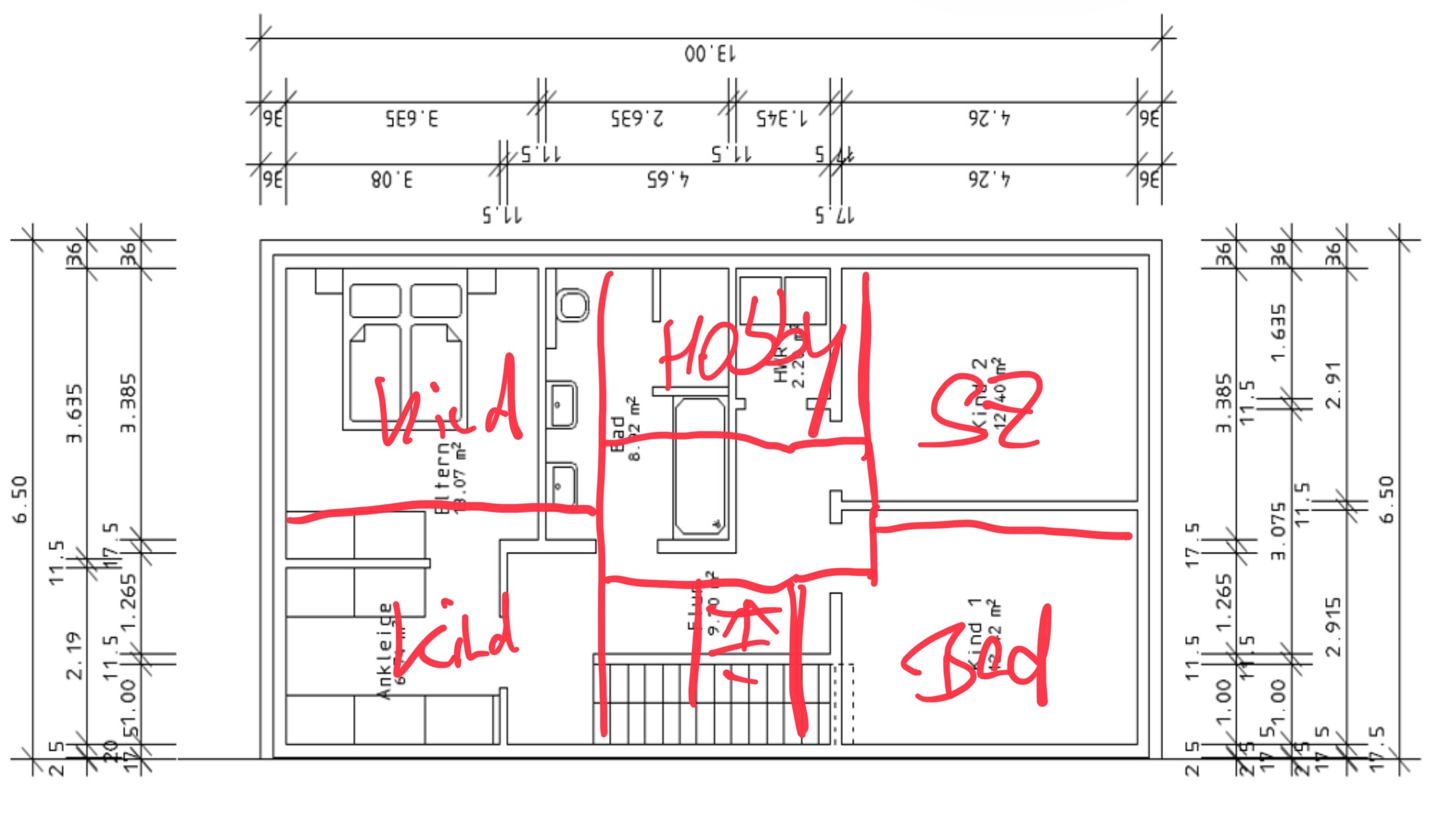

And here is the idea to push the garage further back to gain side windows and possibly the entrance.
If I have read correctly, the identical appearance of the semi-detached houses does not apply to doors or windows.
Here, I have not changed the staircase; this is only about the idea of moving the kitchen and/or entrance.
