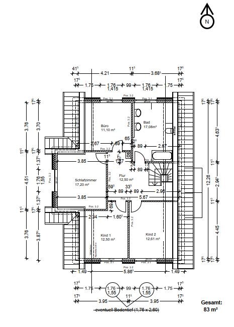

Nice design.
The ground floor works well. Fine.
I would still properly plan a cloakroom for 4–5 people on the ground floor. The kitchen is too wide for efficient work, so I would reduce it slightly to allow better furnishing of the hallway.
There is an issue with the bathroom shower. The bathtub fits better entirely under the sloped ceiling (by the window), and the shower next to the door.

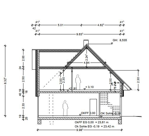

The bedroom doesn't work: you definitely need to draw in the wardrobes and bed as well as the 2-meter (6 ft 7 in) clearance lines.
Even moving the door, which should be done to place a wardrobe behind it, does not resolve the corner with only 2 meters (6 ft 7 in) head height. I would swap the office and bedroom!
The price calculation does not work at all. Large house, high price!
Complex construction method plus kitchen plus fireplace add extra costs. Exterior features like a carport with a driveway also add on top.

Thank you for the feedback.
I need to take another look at the kitchen. Otherwise, the space between the wall and the kitchen island might become too narrow.
The island will probably be made a bit larger.
The suggestion about the cloakroom is a good tip. Otherwise, we could also place part of it under the stairs or in the guest room.
I’m also not entirely happy with the bathroom upstairs.
It’s quite large but still difficult to arrange. We are planning to have only a bathtub with a shower screen up there. After all, people rarely shower and bathe at the same time.
The bedroom ideally shouldn’t have sloped ceilings, or at least not a knee wall as low as in the other rooms on the upper floor.
However, the door could still be moved a bit.
The room on the north side might also be used as a dressing room.
Outdoor areas, carport, etc. are not included in the cost estimate.
