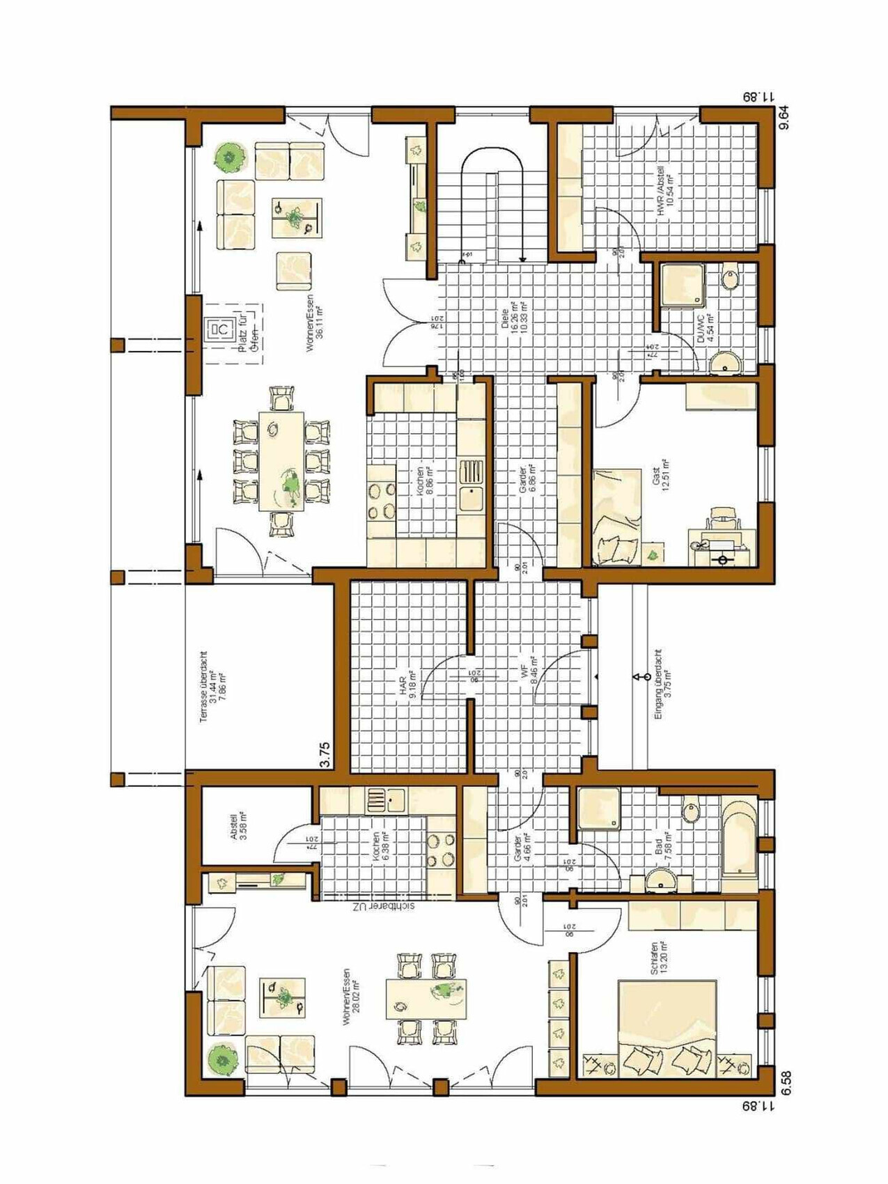

I actually don’t mind the idea of a shared entrance. In particular, I would integrate the utility/technical room (HAR) in such a way that it is accessible from more than one housing unit.

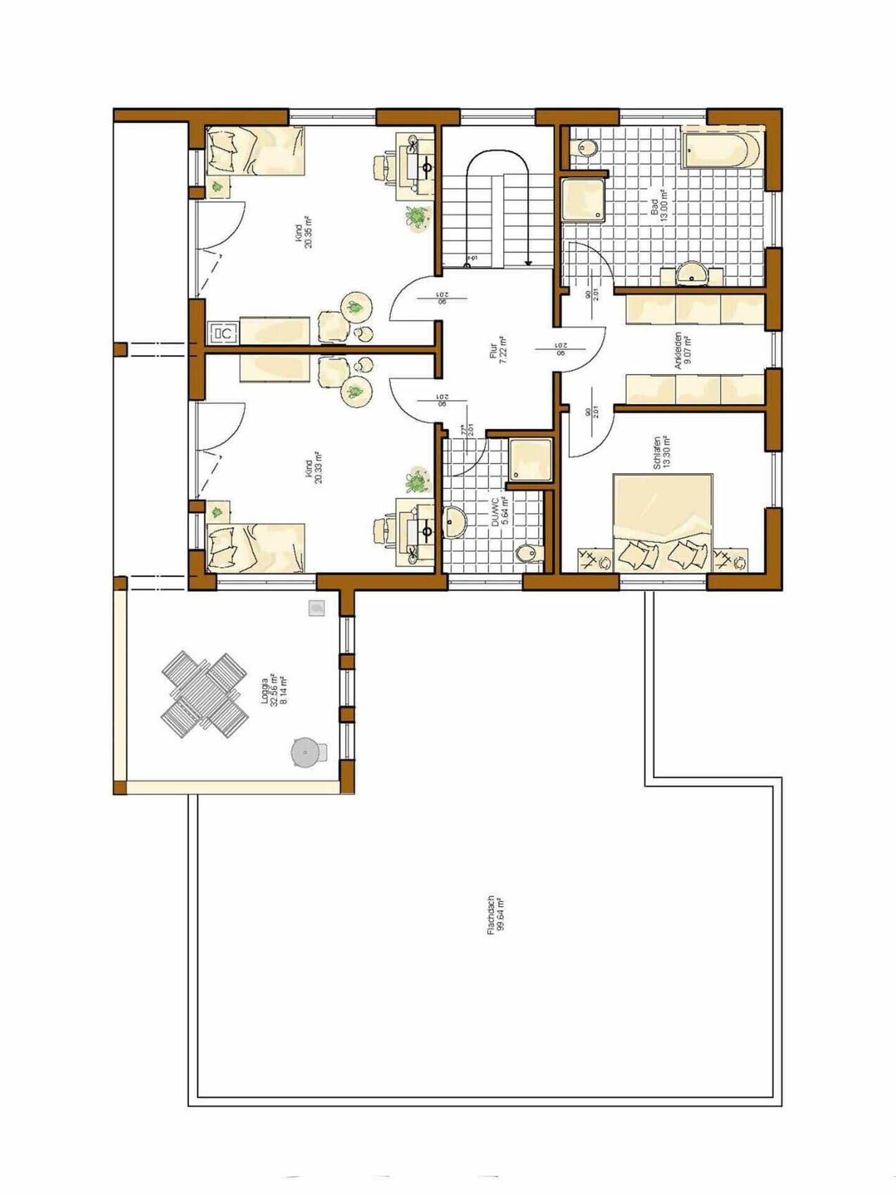

An example (Twinline Genua) that doesn’t fully meet the requirements of fullkehr but goes in that direction.
And the upper floor, where the secondary apartment has a flat roof.
I know this floor plan, which house is it? 🙂 We looked at hundreds back then, and this one was always among the closer options 🙂
But for me, it was very clear that I didn't want a shared entrance. Even something like in this floor plan would be too much for me.
Even at minus 20 degrees Celsius (minus 4°F) and snow, you can walk 6 meters (20 feet) over without a jacket, right? It’s covered anyway.
