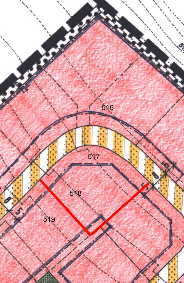

Seriously though, I’ve attached the property plan and an excerpt from the development plan with elevation details. The plot slopes down towards the back left (when standing in front of the house), and the granny flat is almost exclusively on that side. The excerpt from the development plan is oriented north, while the photo of the modelled property is not.
Regarding the garages, we want everything to be accessible on one level—that means you can drive the car into the garage and then enter the house without any steps. There is 8 meters (26 feet) of space in front of the garage lengthwise, so you can easily park there if that’s what you meant, 11ant.
