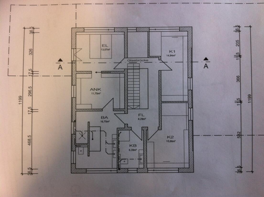

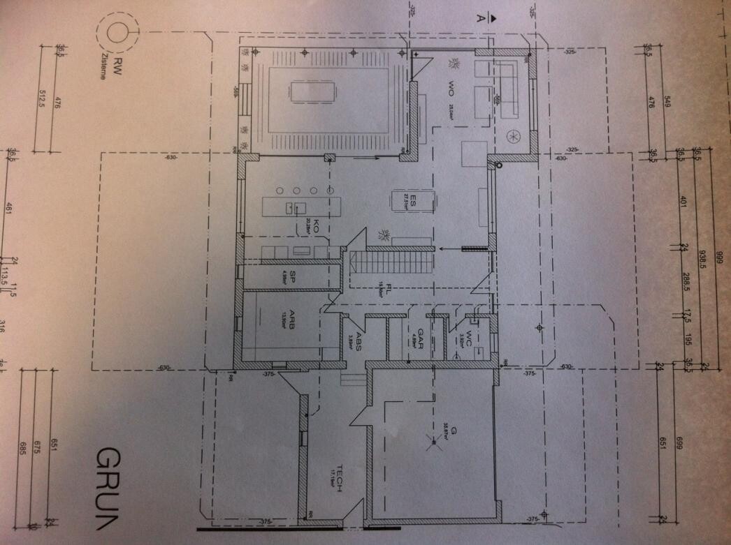

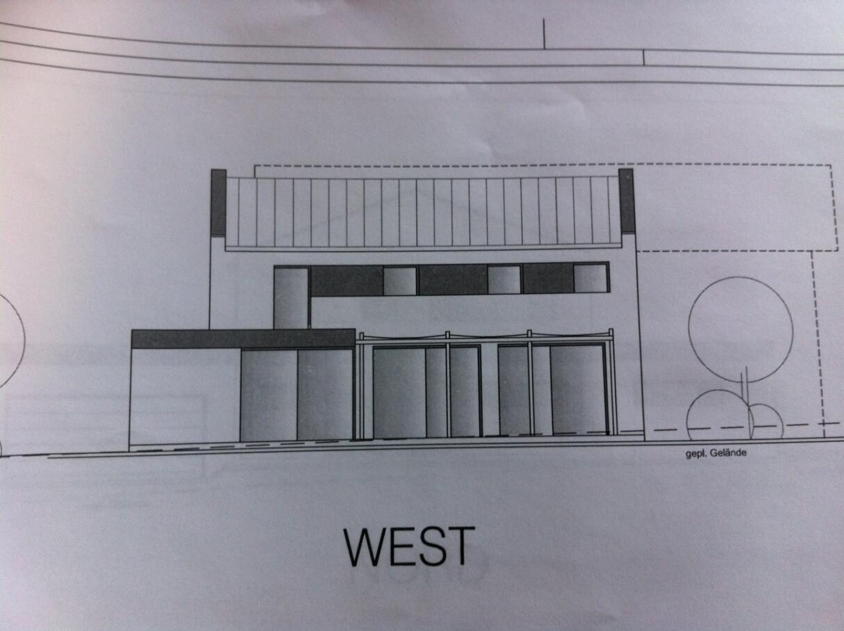

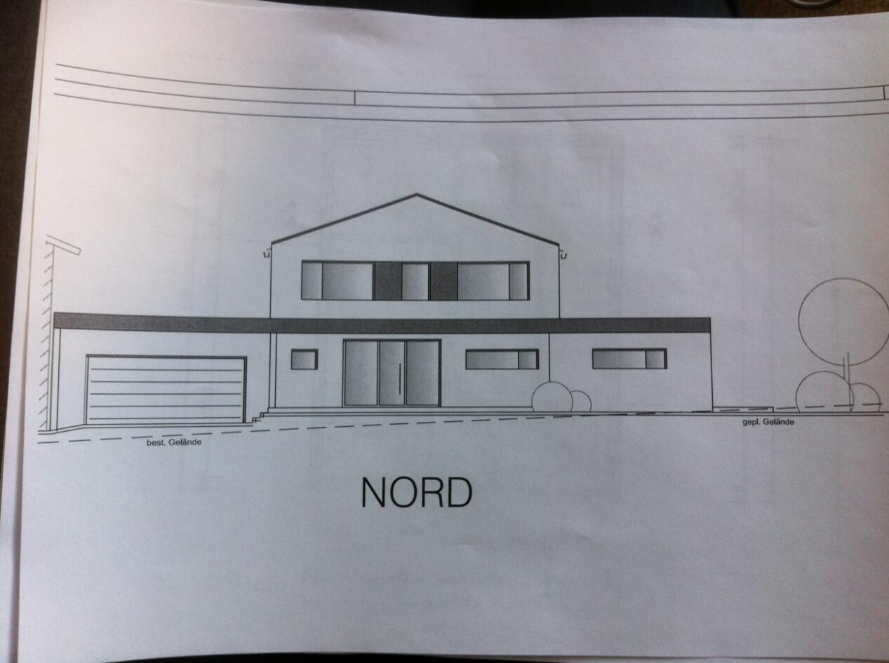

Hello dear forum members!
I kindly ask for suggestions, tips, criticism, and praise!! ;-)
What could I improve? What do you like?
I’m still not satisfied with the window arrangement and sizes… can you help me here?
I would appreciate any advice or sketches of possible changes!
Manuela

Brief explanation:
Ground floor: Kitchen and study are on the south side, garage on the east side,
entrance is on the north side, and dining room and living room on the west side!!!
Upper floor: Master bedroom is on the north side, walk-in closet on the west side,
children’s bathroom on the south side

Why did you plan your utility rooms facing west and the living areas facing north?
I wouldn’t find that comfortable at all. In summer, the bathrooms and kitchen will get very hot, while in winter the living rooms will receive hardly any natural light.
Was there a specific reason behind this? An explanation would be very helpful for providing constructive feedback 🙂
