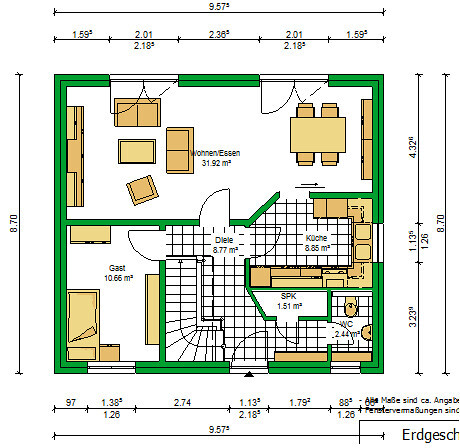

The pantry is intended as a storage room for vacuum cleaner etc., but we are now leaning towards removing it completely to have more space in the hallway for a coat rack etc., possibly to avoid it becoming too tight(?) and to reserve the guest room for these items instead.
The kitchen should actually be large enough, but should it be made slightly bigger if the pantry is removed?
The guest toilet is small, but I know the size from my parents’ house and find it sufficient.
We would also like to have a window on the right side in the living room, near the dining table.

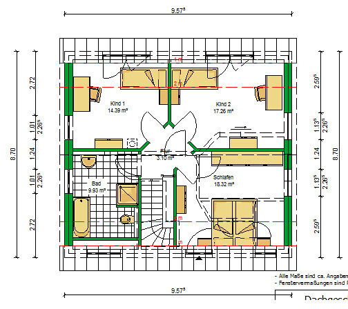

We are unsure about the different sizes of the children’s rooms, but think it is still within a reasonable range?

- Please skip the pantry and use that space as a wardrobe instead – otherwise, you won’t be happy there. Children have many, many shoes and also need some space to put them on. Without a pantry, you could place a shoe bench at the lower part of the plan and a closet with a mirror at the upper part.
- Also, please remove the 45° wall in favor of the kitchen. This way, you can comfortably place a tall cabinet in the corner to replace the pantry (let’s be honest, the amount of canned goods stored is usually not that large anyway).
- Upstairs, you should definitely test the bed placement to make sure you don’t hit your head there.
- Furthermore, I would remove all 45° corners there; this benefits the children’s rooms but is less favorable for the bedroom (hope that makes sense 😀). For the bedroom door, I’d suggest it swings downward on the plan so you don’t lose any closet space. The upstairs hallway could look something like this:

if you are already considering omitting the pantry on the ground floor, I would suggest, in your position, thinking about converting part of that pantry into a shower for the ground floor toilet.
With an estimated 6 overnight visitors per year, I wouldn’t want to have to share my bathroom with guests every time.
I also think an additional window to the right of the dining table makes sense.
As the entrance and stairway are planned now, you basically walk through the mudroom area at the door to get upstairs to the sleeping area. However, off the top of my head, I can’t think of an alternative if the room layout is to remain as planned.
In the bathroom on the upper floor, I would consider installing a second washbasin – for four people (as you planned), having only one basin seems a bit tight.

Edit: Personally, I would definitely keep the 45° corners – they soften the otherwise very rectangular architecture significantly. In our upper floor, we also designed the entrances to the children’s rooms at a 45° angle and still see this, as do all our previous visitors, as a visual highlight.
