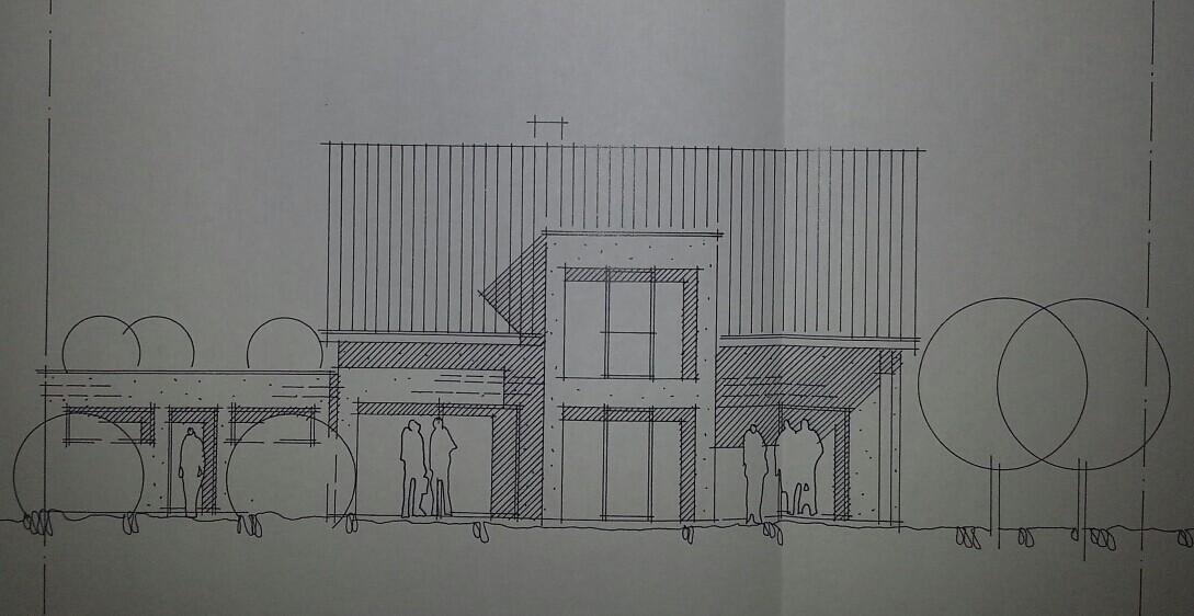

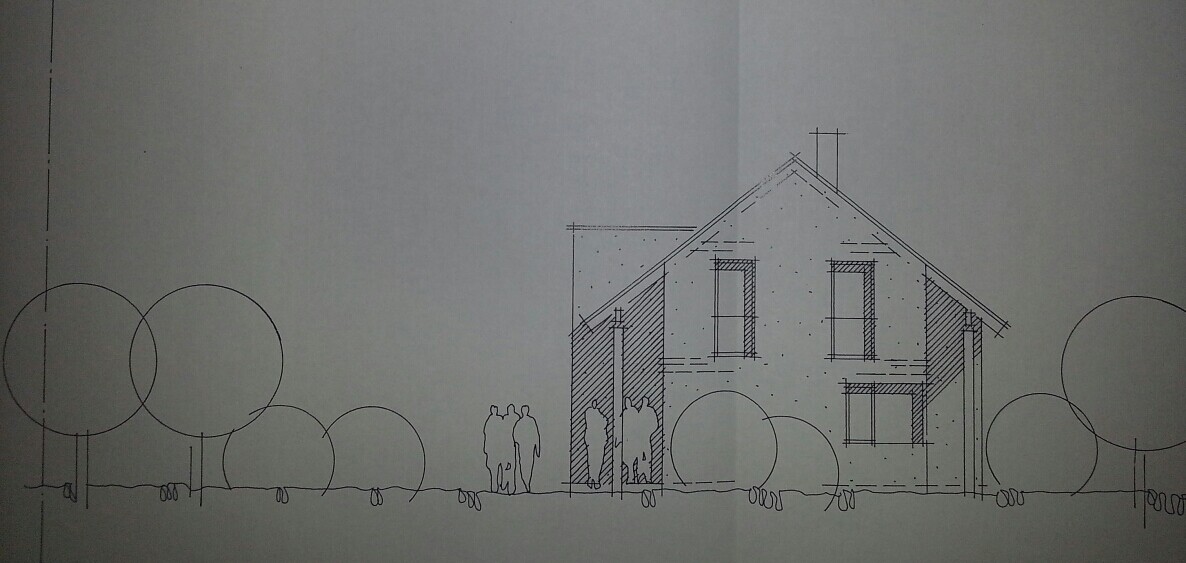

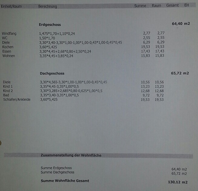

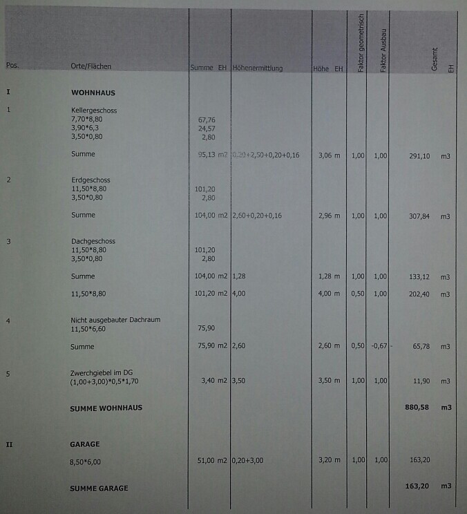

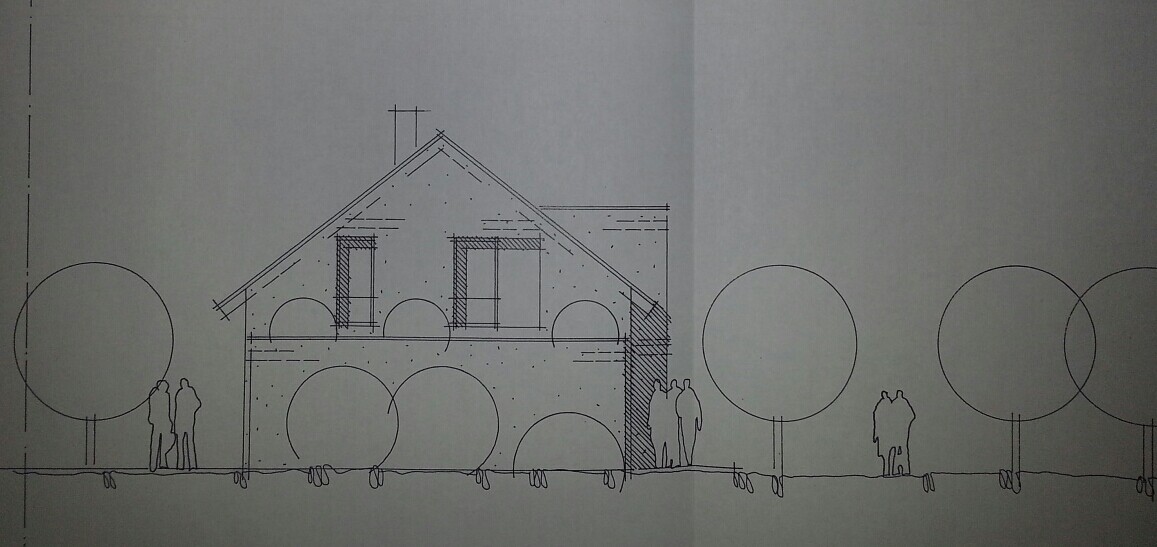

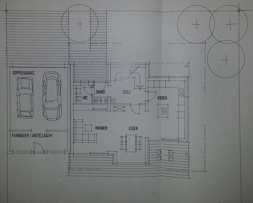

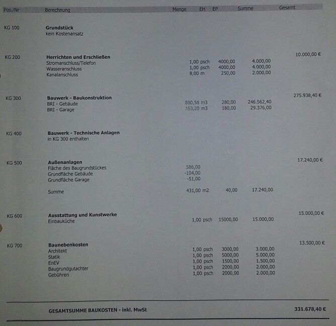

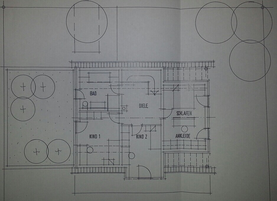

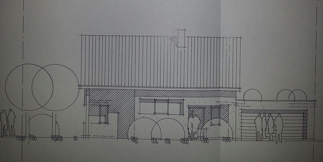

Here I am again. I now have our floor plan including elevations, construction cost calculation, and living space calculation.
What do you think about the floor plan? It has 130m² (1400 sq ft) now (we want to use the Bayernlabo funding program) and about the calculated costs. Looking forward to your opinions.

Have you made any changes to the floor plan? I can't see any difference.

In my opinion, the building’s shape clearly calls for a flat roof. It would probably also create more space on the upper floor.

Is the blower door test included in the energy saving regulation item? Otherwise, the basement or some type of storage room elsewhere would definitely be useful. Are you sure a desk fits well in the walk-in closet?
What kind of area measurements are these? Living area? Otherwise, the kids’ rooms seem quite small. According to the area specifications, the kitchen, dining, and living areas are actually switched around. Just under 16 m² (170 sq ft) for the living room (of course, it can’t be seen so simply since it’s an open plan) is borderline.
