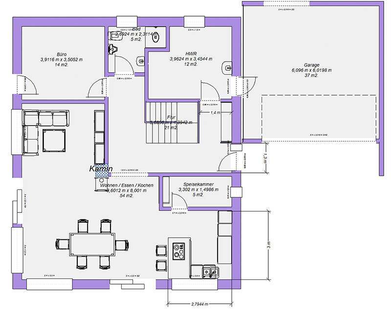

Hello fellow homebuilding enthusiasts,
We are excited to make our dream of owning a house come true and have already done a lot of planning. We’ve also secured a plot of land, so we can get started soon.
The plan is for a detached single-family house with a timber frame construction (walls plastered), at least KFW70 standard, without a basement.
The land slopes slightly (from east to west), and according to the development plan, 2m (6.5 ft) can be cut and 1.5m (5 ft) built up. There is a building boundary line on the north side (north edge of the house), and I have approval for an exemption to exceed this boundary for the garage. We have two children, and I work from home.
The house will have a ground source heat pump and a central mechanical ventilation system (if the budget allows 😉).
There will be an extension on the west side (not insulated as part of the main building envelope) that will house the sauna. The roof of the extension will be used as a roof terrace.
Allowed knee wall height: 2.00m (6.6 ft) with a roof pitch of 25°.
Hmm, what else might be important...??
Attached are images of the floor plan, 3D views of the house, and the site layout showing the house’s orientation on the plot.
Thank you very much, and I’m really looking forward to your feedback.
Thomas

Do you also have the measurements? For example, the living room seems very narrow to me... The hallway for coats is dimensioned at 140cm (55 inches). If you subtract 65cm (26 inches) for the wardrobe depth and some plaster, there isn’t even enough space left for a door frame 🙁
