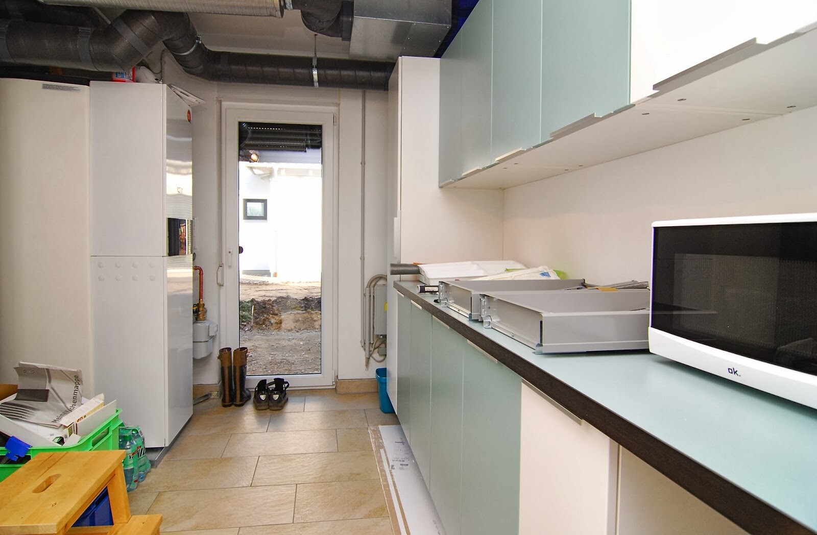

toxicmolotow schrieb:
You, this is planned very compactly. Clear layout also means more space requirements.Well... for us, 8.5 sqm (90 sq ft) looks more spacious – surprisingly, we have also just built, (with a 300-liter (79-gallon) storage tank and mechanical ventilation with heat recovery..., and electricity too;))
But I guess it’s also due to the heating system? No idea – was anything mentioned here?
The mechanical ventilation unit is installed on the ceiling, the device itself can be seen in the photo just around the corner behind the old paper recycling)

Yvonne, your utility room looks really well organized! We also need to accommodate a 300-liter (79-gallon) water heater, gas boiler, and the ventilation system in our utility room.

toxicmolotof14 Sep 2015 09:04...and the gas pipe, gas meter, heating circuit distributor, electricity, cable connection, satellite technology, network, etc.
I am interested in the areas that are not visible in the photo.
I would just like to point out that there is significantly less space available than shown in the plan.
