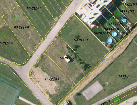

Thank you for your comment. Attached is a site plan of the property; it is plot 5479/52 located in the center of the image. The garage will be positioned in the upper right corner of the plot. North is at the top of the image.
Our idea for the airlock area is to prevent unpleasant odors from the garage. I have also considered leaving this area open towards the entrance and staircase.
I already like the idea of having a separate toilet and bathroom. We also want a separate kitchen.
