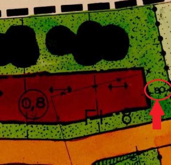

after a long time, something has happened, unfortunately negative. During our last conversation with the architect, he informed us that according to the development plan there must be an 8m (26 feet) wide open space to the neighbor on one side of our planned property. When we asked the municipality if anything could be done about this, they said, "No, the building must be constructed within the building envelope."
Therefore, the plan is now to take the neighboring plot. It is narrower, but without the 8m (26 feet) requirement, we have more space. The design has been adjusted accordingly.

Attached is an excerpt from the development plan showing the 8m (26 feet) rule. Why didn’t the architect notice this earlier? Is that normal?
