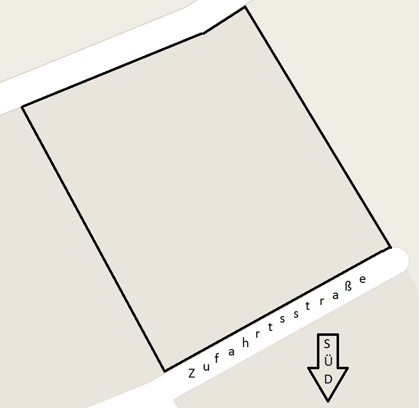

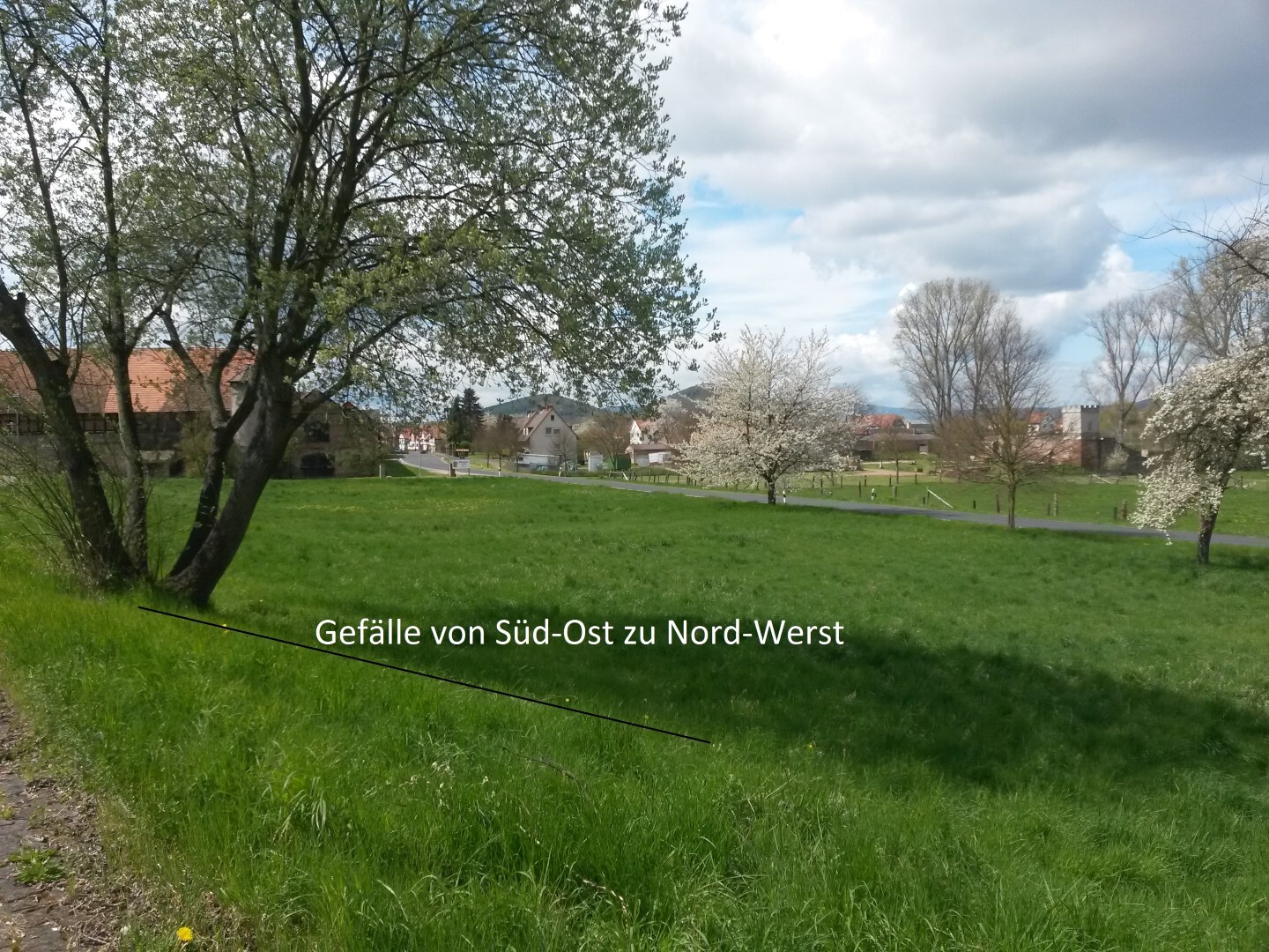

The plot is approximately 26 meters (85 feet) wide and 35 meters (115 feet) long, with the street side sloping upwards from south to east.

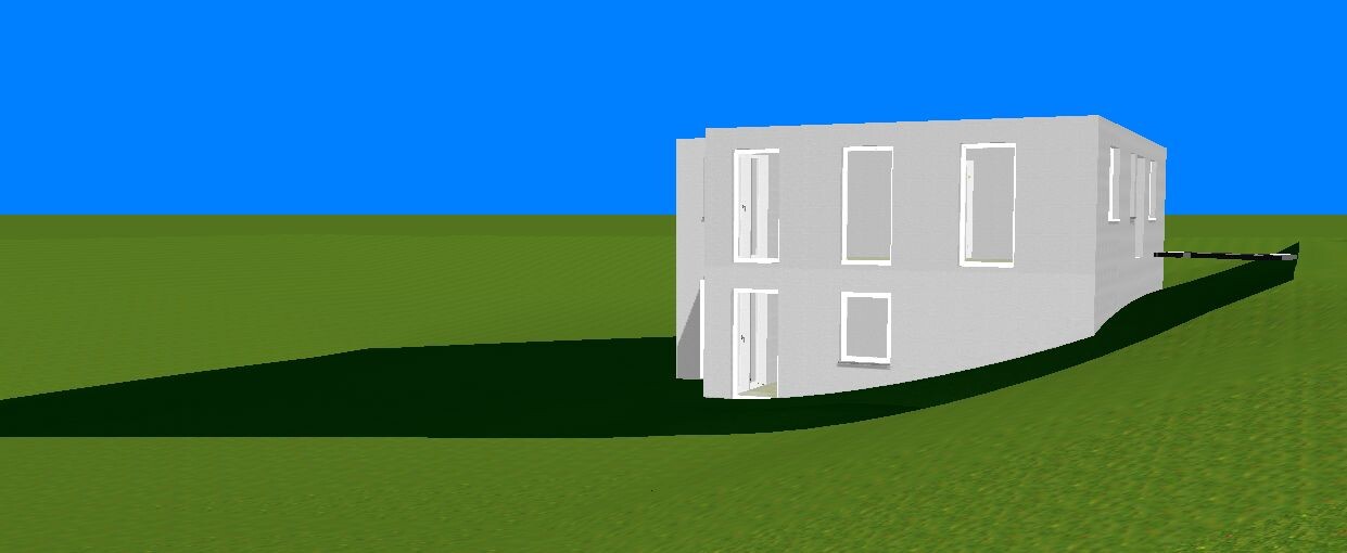

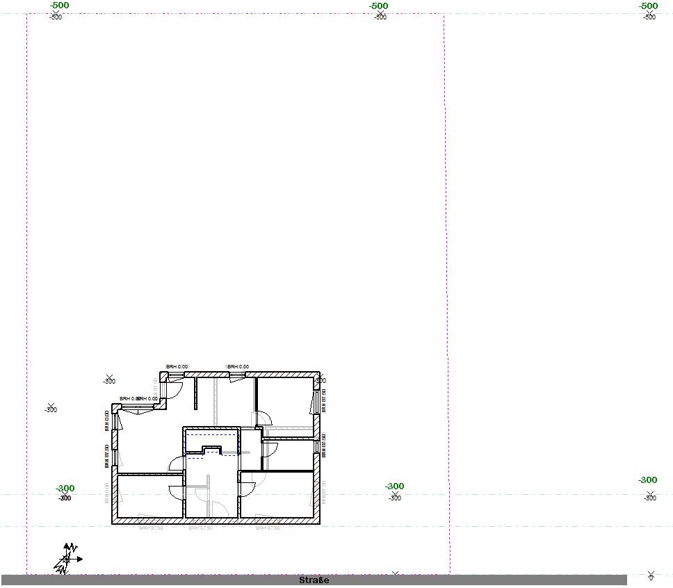

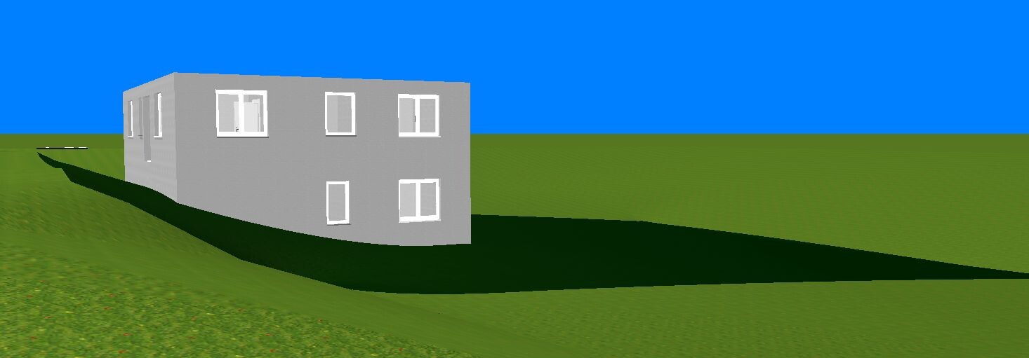

Do I understand the elevation points correctly?
Small floor plan of a residential house with street names.
The frame would represent your plot size.
Attached are some side views again. Will the terrain need to be raised to a certain extent? It would have to be if you want the garages at street level height.
Small light gray 3D house model on a green slope under a blue sky.
3D house model on sloped landscape with green terrain and blue sky.

@reenex, one more question: How far do you plan to position the garage/house from the street?
