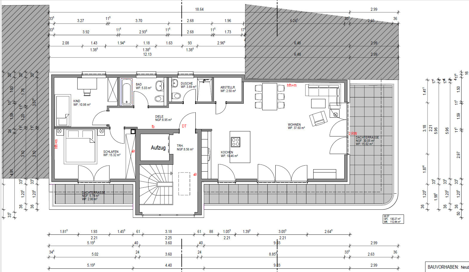

I would like to hear your opinions, suggestions, and tips regarding the floor plans for the following construction project.

1st to 3rd floor:
Recessed top floor:

1st to 3rd floor:
Recessed top floor:

nordanney10 May 2021 21:58Standard floor plans. Basic designs - easy to rent out.
Myrna_Loy10 May 2021 22:34Are garage driveways on the ground floor allowed there? In city center locations, most building authorities generally do not favor them.
I will take the apartment on the top floor.
For renting, I find the apartments well laid out.
Perhaps the top floor apartment could have a second children's room/office instead of two bathrooms and a storage room.
With two children and/or working from home (which is a relevant issue even beyond the pandemic), none of the apartments are suitable.
thoughtless8613 May 2021 14:17Also consider that the floor plans are well suited for rental purposes. However, the question is who you want to target – I see the apartments mainly suitable for singles and couples; having children and/or a home office setup might be more problematic. My question would be whether two bathrooms are really necessary on the penthouse floor, or if it would make more sense to have an additional room/office instead?
