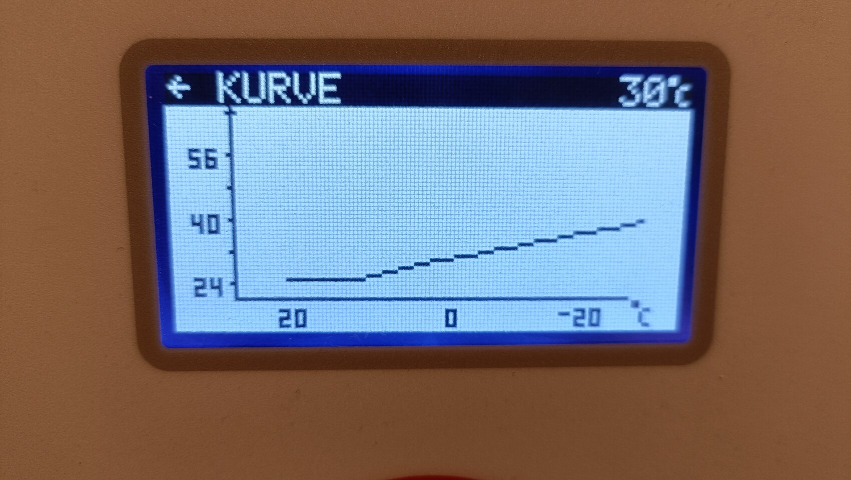

Well, whether the room thermostats are installed or not doesn’t really matter. The key point is the "hydraulic balancing," where room thermostats are no longer relevant. The problem is that with a supply temperature of 26°C (79°F), the pump will only stop running once the return temperature reaches around 22°C (72°F). Simply put, that means you also have about 26°C (79°F) inside the house. In other words, it runs almost continuously. That’s why it’s important to know how the heating curve is set. A supply temperature of 26°C (79°F) is not unusual for a reasonable 55°C (131°F) heating curve at the given outdoor temperatures. You could try to limit the flow by reducing everything by half, but it’s always tricky during the shell construction phase.

I checked the display again today. The defrost cycles have decreased (2.5 hours between defrosts), and the electricity consumption is slightly lower at just under 40 kWh. However, I still consider this to be quite high, especially since according to the display no auxiliary heaters were active over a longer period (the operating hours counter is the same as yesterday), and I had lowered the room temperature on the device from 19 to 17 degrees Celsius. Otherwise, I was able to read the following operating data and times (since last Tuesday):
Settings and heating curve here:
