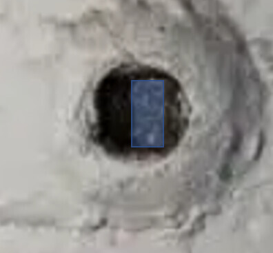

harkonsen13 Jun 2023 21:54Hello everyone,
Quick question. We are currently renovating the house.
I want to reopen my old, unused fireplace, but the usual keys don’t work.
In the photo, you can see a square-shaped "opening," but behind it is just a "metal plate." The chimney sweep said on the phone to simply use a Phillips screwdriver, but that was pointless.
How can I open this lock?
hanghaus202314 Jun 2023 09:45Could you please upload a close-up image of the lock? Unfortunately, nothing is visible.
hanghaus202314 Jun 2023 11:14If this is a rectangle, use a suitable large screwdriver and turn it to the right. Spray with WD-40 beforehand and let it soak. It might also help to gently tap the lock with a small hammer at the same time.
The chimney sweep will surely have the right key. Search online for:
SECOTEC key for stove door, inspection door | 7x7 mm (0.28x0.28 inch) square key | 1 piece
