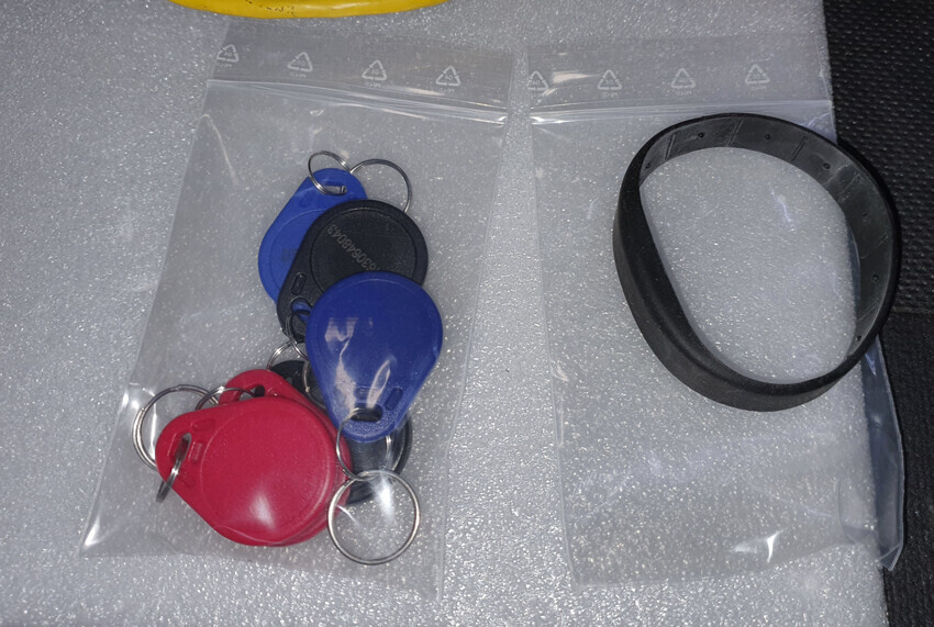

So, the last module has also arrived, at the same time as the RFID tokens. Unfortunately, I ordered the wrong ones (I need 13.56MHz (high frequency), but ordered 125KHz). Only the wristband was correct.
Several round key fobs in bags (red, blue, black) next to a black wristband.

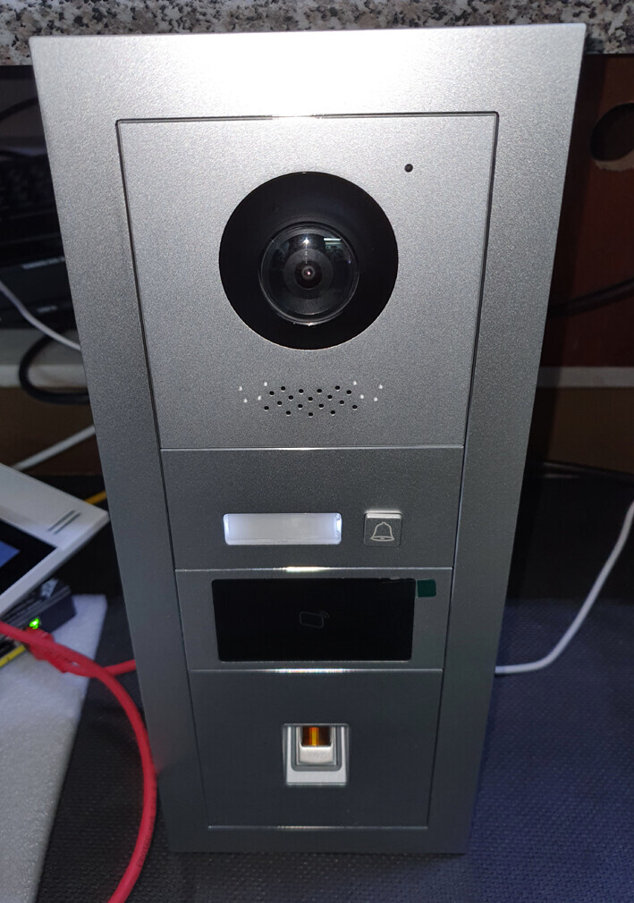

With this, I can already unlock the door. Today I hopefully ordered the correct RFID "tokens" (from zutrittsshop ...). Among them are these in wood 😉
Multicolored wood tone swatch stacks as floor covering samples
Video door intercom with camera, speaker grille, doorbell button, and card reader

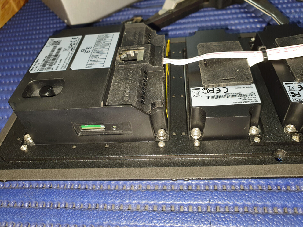

Battery module holder with cable bundle in black housing, visible screws
A MicroSD card can also be inserted here. I didn’t have time to check, but I believe it is for recording the camera...

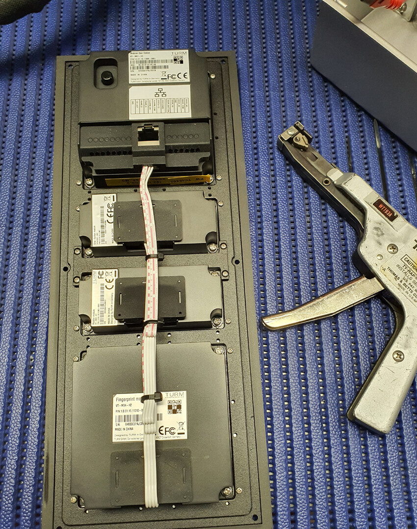

Here is the rear side, still without signal cables for the smart home system and without the LAN cable (among other things for power supply via POE).
Open server blade chassis with multiple hard drive modules, ribbon cables, crimping tool beside it
