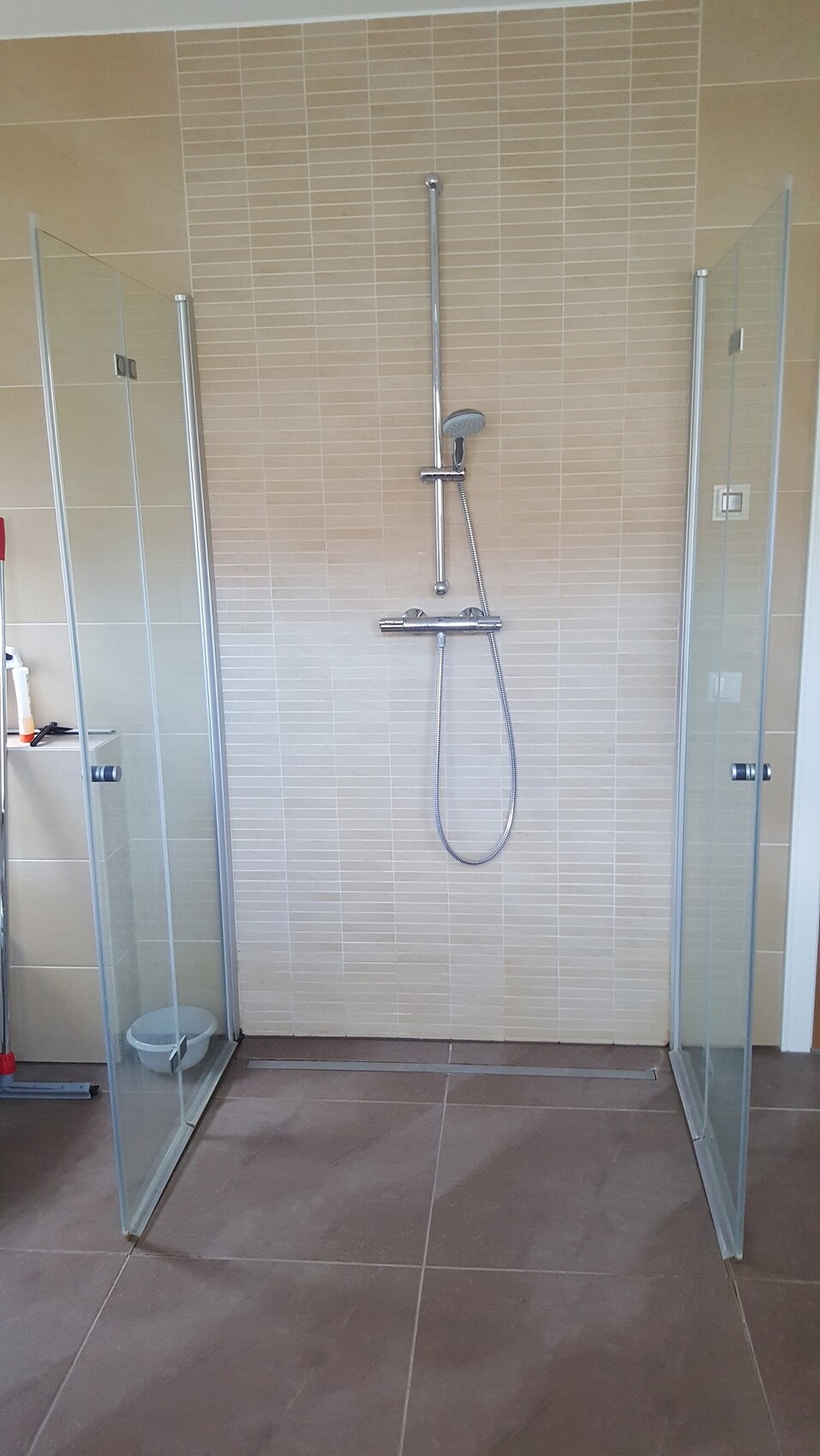

hbf12 schrieb:
I would be interested and would appreciate a photo.So, now I’m on vacation and have time. However, resizing the images was difficult.
By the way, these are Duka Multi-S 4000 shower walls.

Hello Froop,
We have a Hansgrohe Raindance and a 120cm x 120cm (47 inches x 47 inches) shower.
The head centrally mounted on the wall is 20cm (8 inches) higher than the centrally folding side panel. There is hardly any splashing over it.
However, it splashes out the front. It should be 150cm (59 inches) there, since our washbasin is located there. I am planning to install a door afterward (currently under construction). There are some great examples here.
