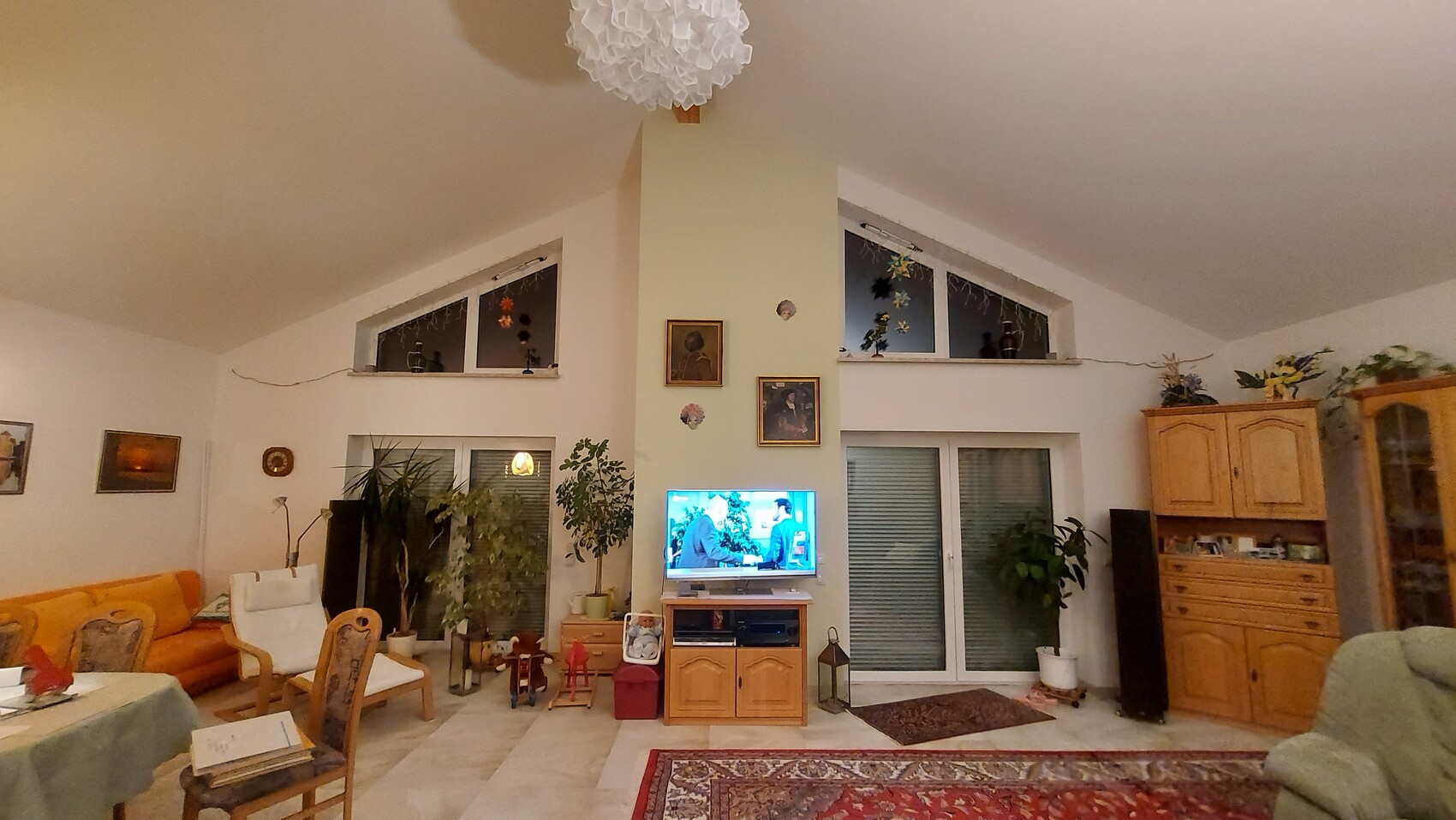

In our old house, we had the open gable shown in the first post: a room width of about 6 meters (20 feet), since it was a terraced house. The windows were on the gable end, as seen by @Nida35a, so fully glazed. The ridge height was then 3.20 meters (10.5 feet). This was the reason why now, although we have the roof (a staggered shed roof) open, the bathroom and bedroom are on suspended ceilings. It’s airy but not cozy. Other terraced houses next door created relatively small galleries for the children in the middle, about just 3 sqm (32 sqft) of floor area, since you also want to preserve a sense of space. However, standing height was not possible.
