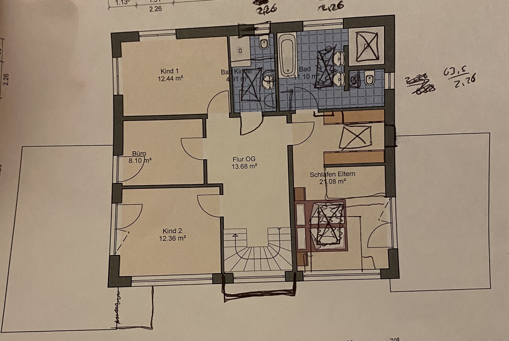

Upstairs, of course, we don’t have just one room, but two kids’ bedrooms, an office, a children’s bathroom, and a master bedroom with walk-in closet and bathroom. Maxwell8 schrieb:
If we built it open-plan, we would probably have a ceiling height of 3.5–4 meters (11.5–13 feet) in the middle upstairs. We don’t need to use the full 9 meters (30 feet) and therefore probably 5 meters (16.5 feet) height at the top. That really depends on how wide the house will be and how the rooms are arranged in relation to the corridor. Do you have only one roof slope or a narrow gable?
It can all look good, but if the room layout doesn’t work, it can quickly feel awkward.
Otherwise, I’m in favor of open-plan – it creates a wonderful sense of space. We have our living room open to the roof, and the roof pitch there is almost too steep.
The house measures approximately 18x11.5 meters (59x38 feet) on the ground floor, with two bay windows that become part of the roof terrace upstairs. So, the roof area at the top is about 10x10 meters (33x33 feet).
I’m attaching a picture to help visualize it better. It’s still in the design phase, so no worries. 🙂
We are leaning towards a more open attic space. It will be a standard roof without gables, but with a slight overhang at the staircase.
Myrna_Loy7 Apr 2021 23:19To me, this would look far too much like a makeshift attic apartment with the many rooms. You won’t really see the roof structure anywhere, just sections of beams and sloped ceilings – which will create a boxed-in feeling in the smaller rooms.
