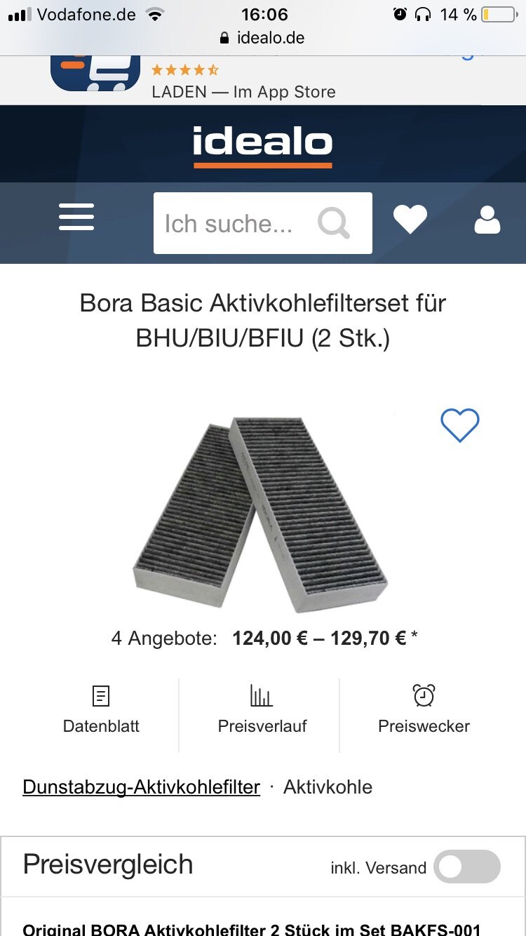

chand198613 Feb 2018 15:30120 euros but only according to the "MSRP," right?
When buying bargains, keep a reserve. I think changing it every 6 months is not excessive if used a lot. Significantly higher ongoing costs cannot be avoided compared to exhaust ventilation, unfortunately that's true.
