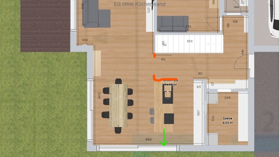

I'm confused... which peninsula from option 2 are you referring to? You’re right, I complicated things way too much. Since the discussion has progressed, I’ve combined both options into a "heart with mind" layout:
The red lines indicate only partial walls. You would leave openings to the hallway. If that’s an issue, a door can easily be added later. The island would then become a peninsula, which I would shift toward the exterior wall (green arrow). I would relocate the pantry entrance to the hallway (basically through the cloakroom). You can move the wall between the hallway and pantry downward to create more space for the cloakroom. Also, the area under the stairs can be used.
I would definitely use the kitchen run on the right side as additional counter space—otherwise, there isn’t enough work surface. Specifically, approximately 3.8m (12.5 ft) of kitchen run, with 1.2m (4 ft) at the top reserved for fridge/freezer and tall cabinets, and the rest for countertop with upper cabinets. Opposite that, a 2.6m (8.5 ft) peninsula and a 1.2m (4 ft) walkway. The peninsula should be at least 1m (3 ft) deep, and the kitchen run could be made deeper as well (around 80cm (31 inches)) to accommodate appliances like a toaster and similar items.
Hangman schrieb:
and I would move them to the exterior wall (green arrow).I definitely wouldn't do that, as that's one of the nice features of this kitchen. But you can't really improve much with just a cut-out there.
