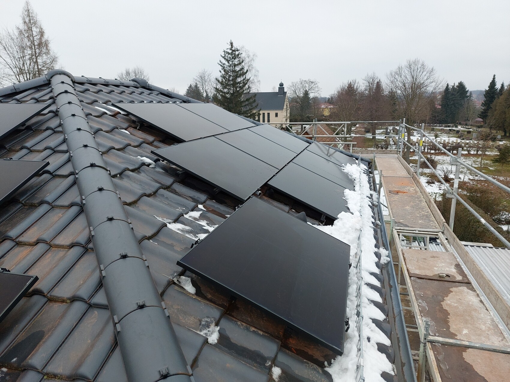

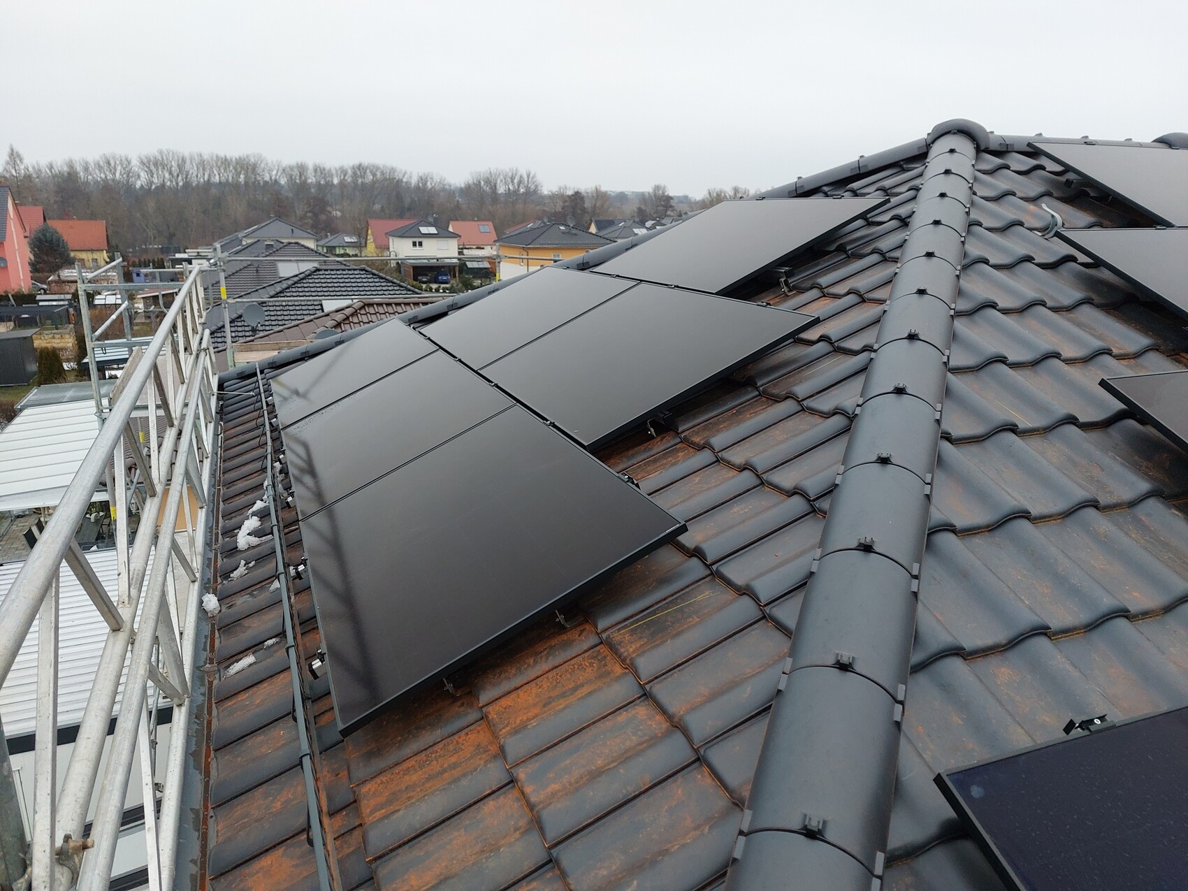

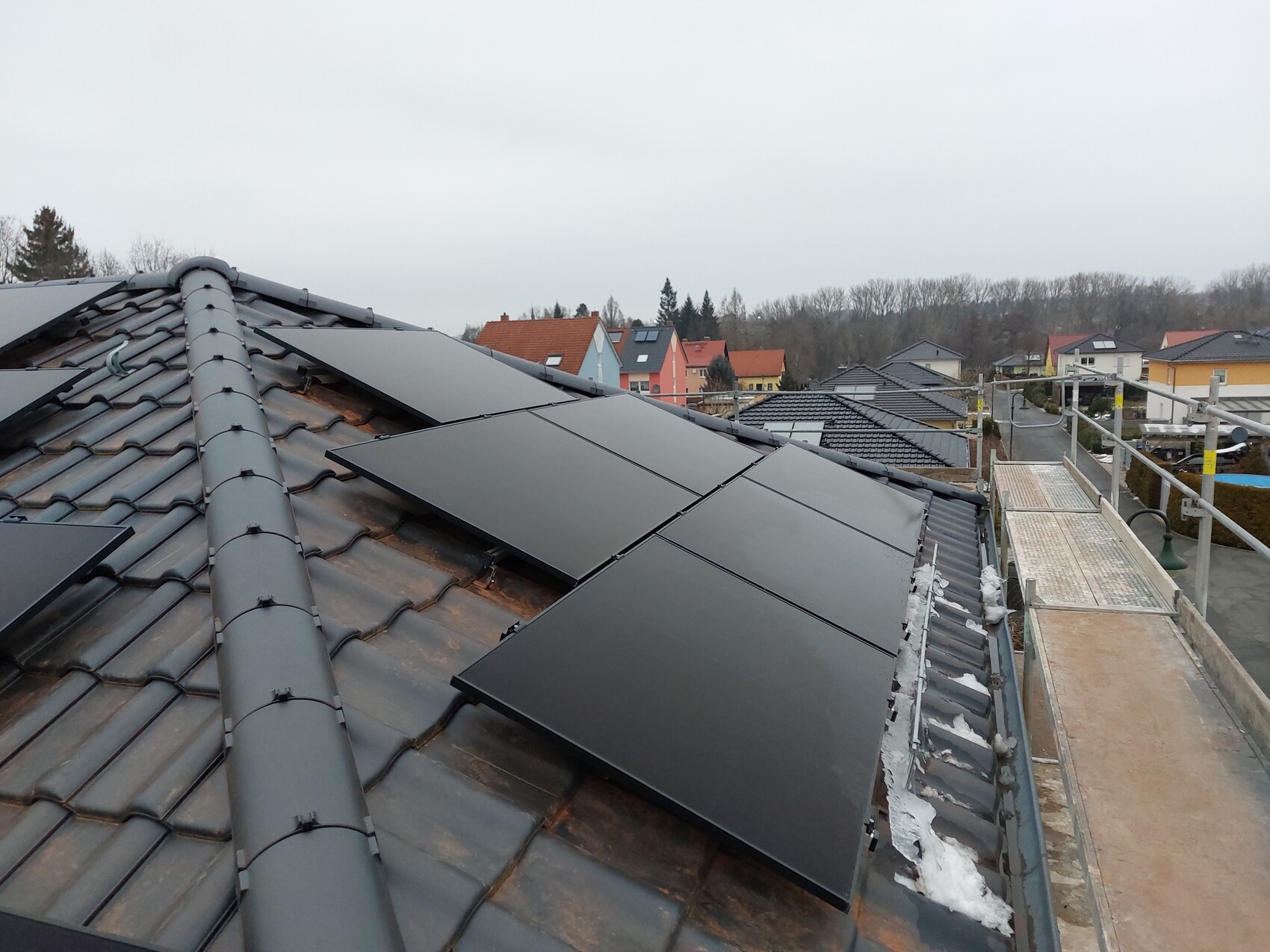

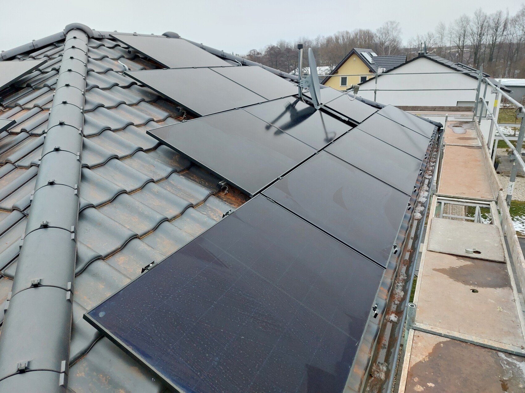

gerrygerd21 Feb 2025 18:47hanghaus2023 schrieb:
Here are some photos of the neighbor. They have built on all 4 sides.Your photos of the neighbor are interesting to compare with Musketier (floor plan 10.2m x 8.2m (33.5ft x 26.9ft)). Do you happen to know the size of your neighbor's floor plan?Similar topics
