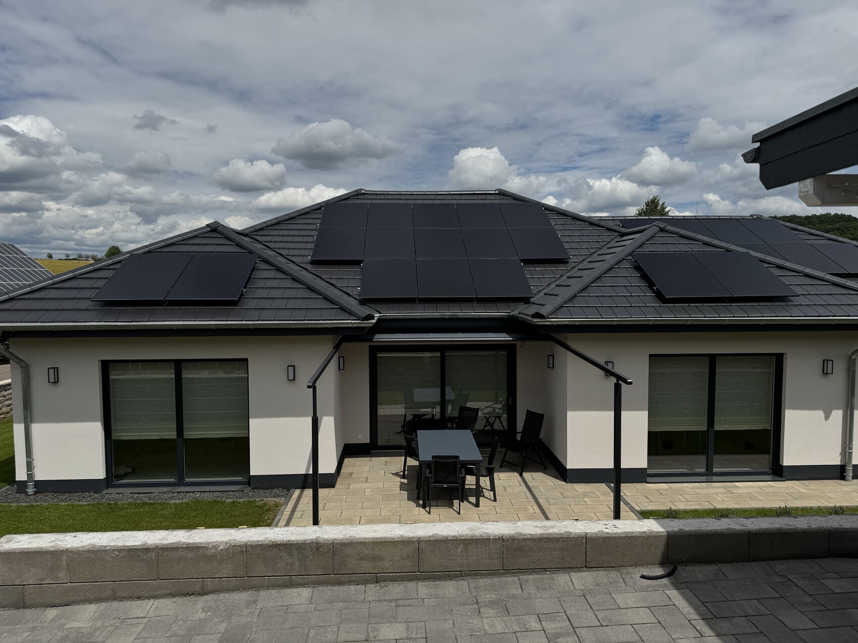

For us, the combination of a hip roof and photovoltaic system was somewhat challenging. In the end, we managed to find a quite reasonable solution and installed a total of 11.2 kWp on the roof.
4 modules on the east side and 24 modules on the south side.
We actually still have the option to install an additional 18 modules on the west side. However, we have decided not to do so for the time being.

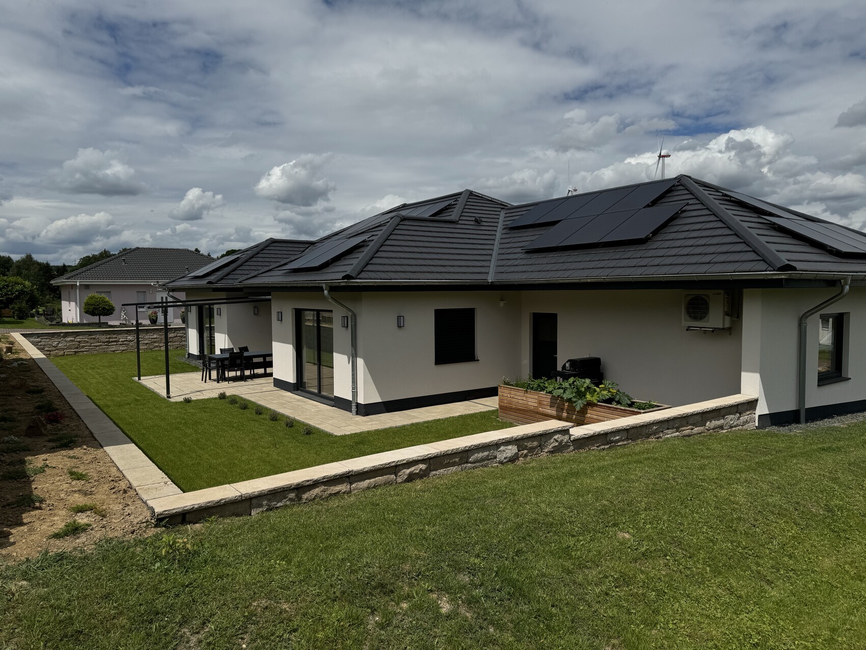

We also have a small house with a hipped roof.
I believe it measures about 10.2 x 8.2 meters (33.5 x 27 feet), plus the roof overhang, with a 25° roof pitch (25° slope).
We have now installed 32 modules on all four sides. Due to the low roof pitch, even the north side is worthwhile.

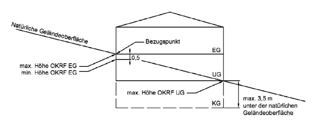

gerrygerd21 Feb 2025 16:58ypg schrieb:
In my opinion, garden-level floors are the basement levels mentioned; there isn’t another basement below them.Here is a sketch from the development plan: ground floor, lower ground floor, and basement levels are possible. I previously referred to the lower ground floor as the “garden level.” G

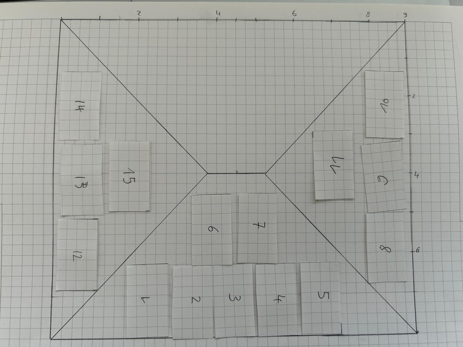

gerrygerd21 Feb 2025 17:02Musketier schrieb:
We have now covered all 4 sides with 32 modules.With our somewhat smaller floor plan of about 9x8 meters (30x26 feet), I would only fit 22 modules on four sides. Are your modules smaller than 1.1x1.7 meters (3.6x5.6 feet) by any chance? Do you happen to have a photo handy where the photovoltaic system can be seen?
