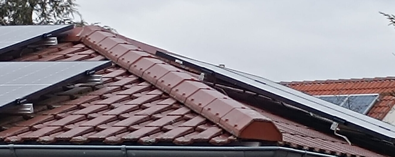

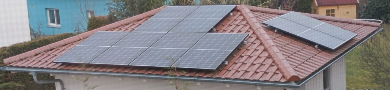

hanghaus202321 Feb 2025 07:33gerrygerd schrieb:
That would mean the east and west sides would be steeper. Maximum roof pitch is 30 degrees; nothing steeper is allowed.
Here are some photos from the neighbor.
He has covered all four roof surfaces, but with less roof pitch.
