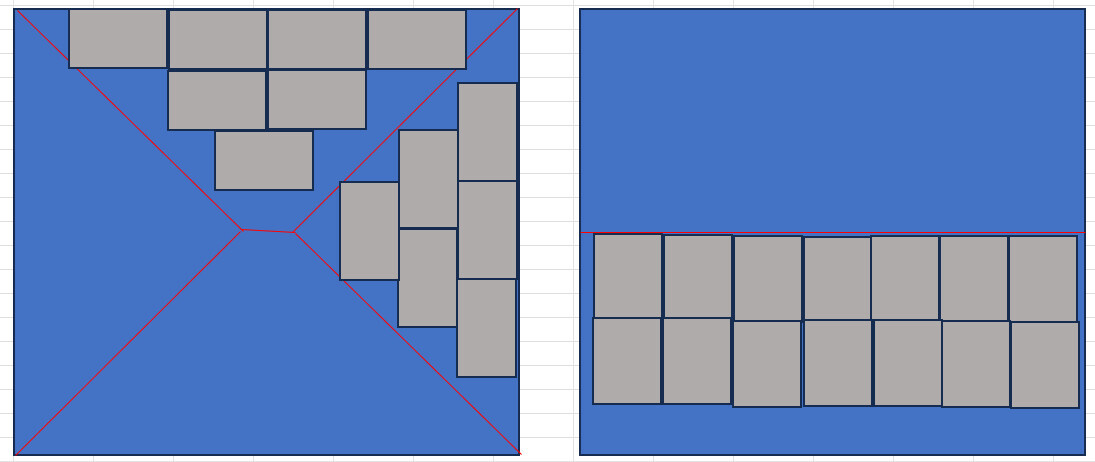

You really don’t need any software for this. Once you have the dimensions of the modules, you can easily do it yourself.
Two blue areas with gray rectangles: left with diagonal lines, right with horizontal block row.
This took about 20 minutes. Here you can see why the gable roof performs better. When the hipped roof is installed, you will have around 2 fewer modules if you cover it completely. So about 10 kWp.
