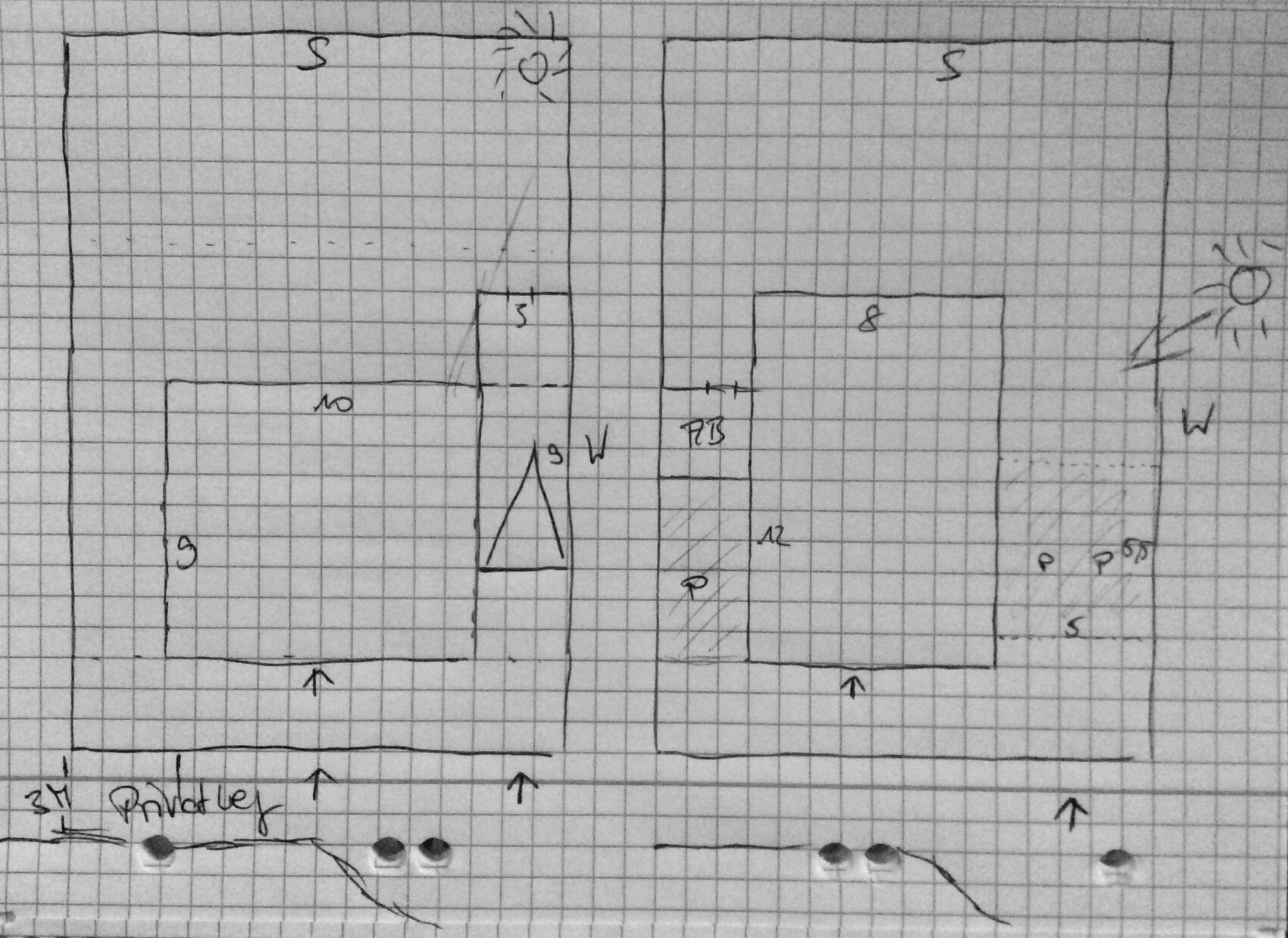

We also got the suggestion to build the house narrower (7–8 m (23–26 ft) wide) and deeper instead of 10 m (33 ft) wide. This way, the garage could be on the west side and an additional light source could be positioned on the west side in the kitchen or living room area. Somehow, we have not found a fitting floor plan idea yet that makes us rethink this. Also, the idea of having a very long green strip on the east side complicates it in our minds.

- 2 parking spaces (1x 9 m (30 ft) garage), garage on the east side?

- The 9 m (30 ft) garage on the east side is probably best in terms of light, but placement on the west side is also possible. A 6 m (20 ft) garage with an annex (for garden furniture, lawn mower, bicycles, etc.) elsewhere is also conceivable. However, since it makes sense to have an additional parking space in front of the garage, a 6 m garage combined with a 5.0–6 m parking space would practically end at the back of the house, so we wouldn’t really gain anything.

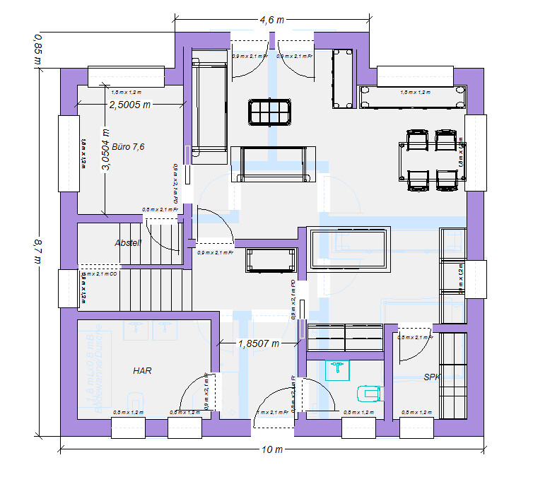

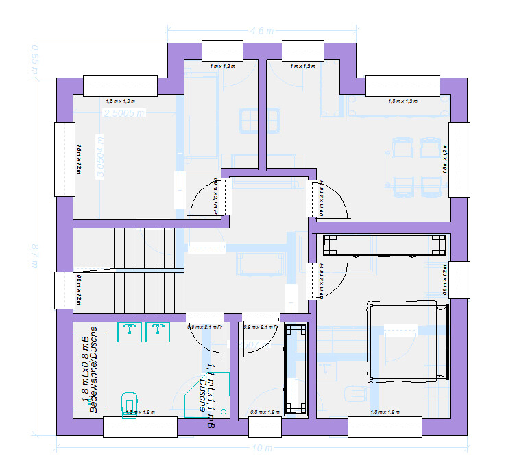

Builder’s floor plan (images ending with 295772-295772-5.png)
House design – why did the design turn out as it is?
- The builder’s architect based the floor plan on the Signus by Kern-Haus.
- We like the basic structure so far.
- The front entrance with the door and the windows above feels much more inviting than the standard floor plan.
- Is the front door drawn too large?
- The door to the living room is not ideal. Depending on kitchen layout, it would be in the way when open.
- Would a window sill height of 1.01 m (3.3 ft) be sufficient for the kitchen window? The left window in the dining area facing the terrace could perhaps be made floor-to-ceiling. It might not look perfectly symmetrical from the outside, but it would look the same from the inside in the dining area.
- Due to the quarter-turn staircase with one step on the exit, the entrance hall area was reduced at the expense of the TV area. Is the TV area still large enough?
- The entrance hall is quite large because of the quarter-turn staircase with the step on the exit. How could this space, especially under the stairs, be better used? Maybe with a built-in closet or storage room (with its own access)? We also once thought about rotating the staircase 180° and using the area under the stairs at the entrance as a wardrobe (built-in closet). But then what about the door to the living room? And how would it look when entering the house and seeing a cupboard right away? On the other hand, it might make sense to swap the front door with the window element.
- The utility room has a 73.5 cm (29 in) door. Is that sufficient or would an 85 cm (33.5 in) door be better?
- For the WC, we might prefer the door to open inward and swap the toilet and washbasin.
- The two bed niches in the children’s rooms don’t look optimal at first glance. On one hand, only a wider bed fits here, and the other child would have to place a bigger bed elsewhere later (unless sleeping partially under the window). On the other hand, from this niche, you can’t see who enters the room. Maybe this deep niche is better for the entrance and perhaps a wardrobe with a headboard? Or the partition wall could be shifted a bit left (centered between the two windows), so that beds fit properly in both niches and bigger beds would protrude a little.
- The storage room could perhaps be a bit narrower in favor of the bathroom. Maybe it would look better with an 85 cm (33.5 in) door here as well?
- The heating system will likely be underfloor heating with a gas condensing boiler and solar storage for hot water support.

- DIY… since we can’t let go of the basic structure from the builder and Signus, I also drew a bit. Access to the utility room was moved to the kitchen and a 1.25 m (4 ft) wide built-in closet wardrobe was planned in the hallway.
- Maybe the stairs should be moved a bit further left to get a larger living/dining area. This would allow making the WC narrower and possibly longer.
- The square dining/living room looks like it might not be used optimally later. The distance between TV and sofa is quite large at 5.87 m (19 ft).
- The upstairs hallway might be a bit too wide (due to the storage room). The wall between the storage room and the left children’s room could be moved left a bit. This would mean the door to the children’s room is not aligned with the stair railing but set a bit behind the wall at the stair’s end. Or could this be solved by adding a railing to the last step facing the left children’s room (similar to the builder’s floor plan)? On the other hand, such a wide hallway offers space for 30–40 cm (12–16 in) slim sideboards.
- The layout of WC and bathroom might be done differently.
- Windows and doors are not fixed yet and could be better positioned.
- We like the entrance area better with the two outer windows above.
Own Floor Plan 2 [U](images ending with 295772-8-295772-9.png)
House design – why did the design turn out as it is?[/U]
- DIY… We reviewed all floor plans again and came across the one with the staircase rotated 90°. I extended this plan to 9 m (30 ft) depth and shifted the stairs.
- I find this layout very flexible since the central axis can be moved depending on needs. The same applies vertically for the utility room and office.
- I like that with the stair positioning upstairs you come out behind the central axis, allowing large straight rooms to the south as well as to the other side.
- I thought about using another staircase but couldn’t find a good location, and it would mean no window in the upper hallway.
- The kitchen could also be open, or alternatively as our preferred closed kitchen. The dimensions shouldn’t feel too narrow.
- The entrance area might be a bit large, especially in front of the WC. But it could fit a slim sideboard, mirror, or day coat rack.
- The children’s rooms might be a bit too large. The central axis including stairs could be moved about 20 cm (8 in) toward the garden, but that would narrow the dining/living and cooking area.
- The master bedroom might be a bit narrow if the bed is placed on the right and a sideboard with TV on the opposite wall.
- Whether the stair overhang is enough to access the bathroom from there still needs to be checked in detail.
- We like the entrance area better with the two outer windows above. Whether to place two slim windows beside the front door or one larger window and then likely none on the top line needs further review.

- Where would you position the garage?

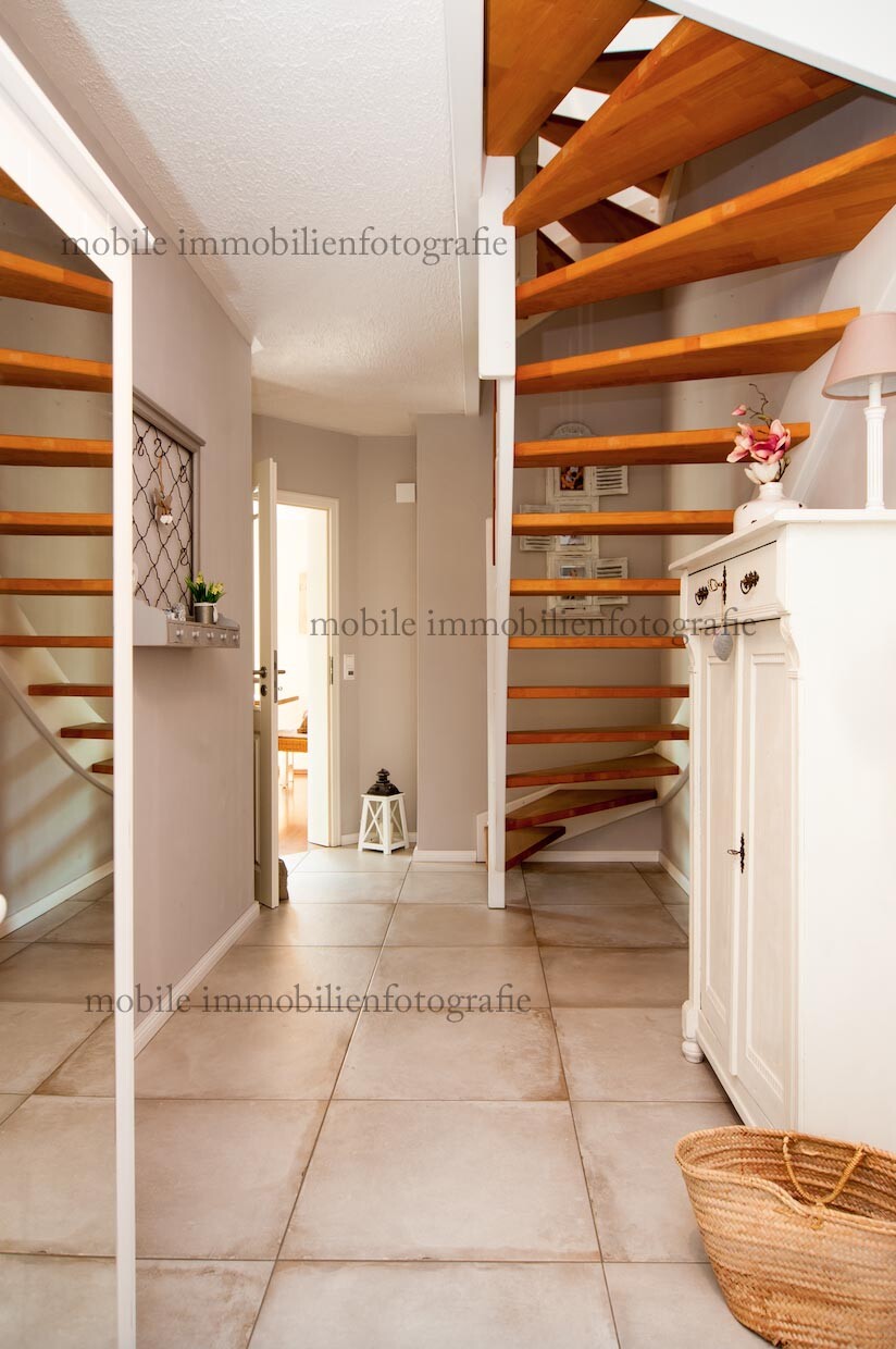

montessalet schrieb:
Visually, that might be true. But practically, it’s a different matter... In fact, staircases like those really need to be more delicate (especially if the staircase is dark). Even better are "floating" steps (only fixed to the wall). However, those tend to be quite expensive.We initially wanted floating steps as well. Besides being expensive (about 2000€ per step), according to our architect, the steps would have needed to be supported by a 24cm (9.5 inches) concrete wall. Also, running pipes or cables inside that wall wouldn’t have been possible.
In the end, we chose a folded beam staircase made of dark oak with a glass panel as a fall prevention barrier. The glass makes the space feel open and visually widens the hallway (about 140cm (55 inches)).
