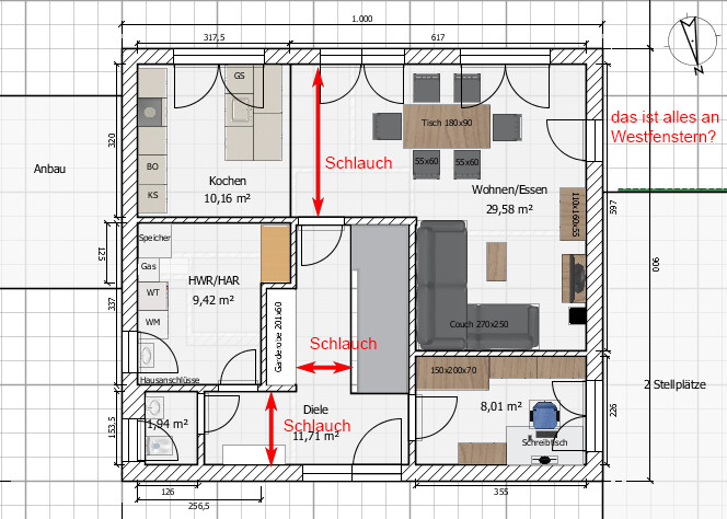

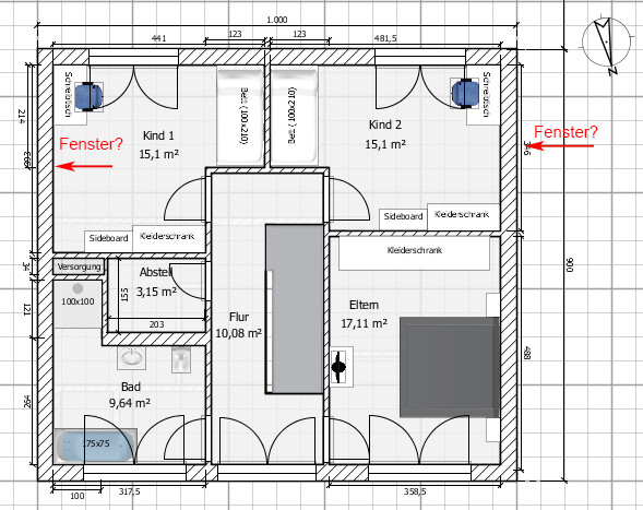

Own Floor Plan 1 [U](images ending with 295772-6-295772-7.png)
House design – why did the design turn out as it is?[/U]
- DIY… since we can’t let go of the basic structure from the builder and Signus, I also drew a bit. Access to the utility room was moved to the kitchen and a 1.25 m (4 ft) wide built-in closet wardrobe was planned in the hallway.
- Maybe the stairs should be moved a bit further left to get a larger living/dining area. This would allow making the WC narrower and possibly longer.
- The square dining/living room looks like it might not be used optimally later. The distance between TV and sofa is quite large at 5.87 m (19 ft).
- The upstairs hallway might be a bit too wide (due to the storage room). The wall between the storage room and the left children’s room could be moved left a bit. This would mean the door to the children’s room is not aligned with the stair railing but set a bit behind the wall at the stair’s end. Or could this be solved by adding a railing to the last step facing the left children’s room (similar to the builder’s floor plan)? On the other hand, such a wide hallway offers space for 30–40 cm (12–16 in) slim sideboards.
- The layout of WC and bathroom might be done differently.
- Windows and doors are not fixed yet and could be better positioned.
- We like the entrance area better with the two outer windows above.

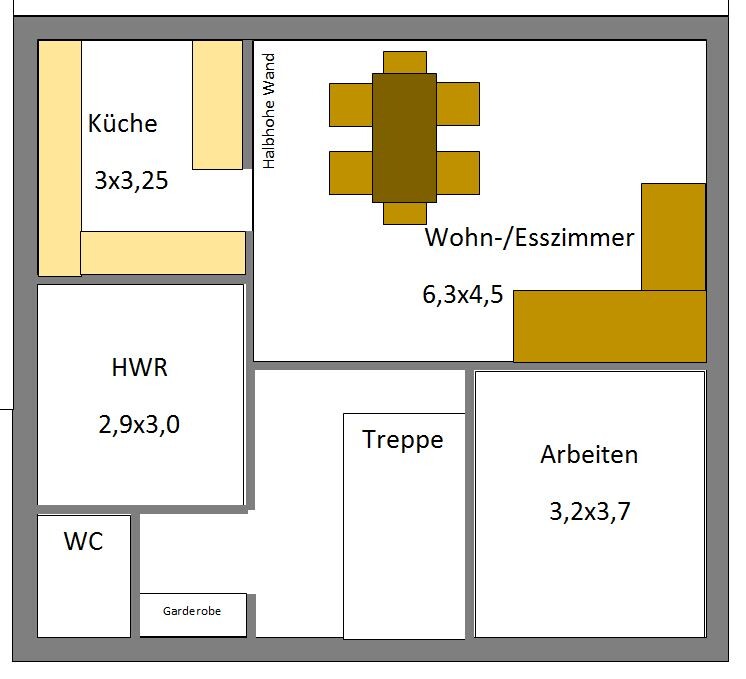

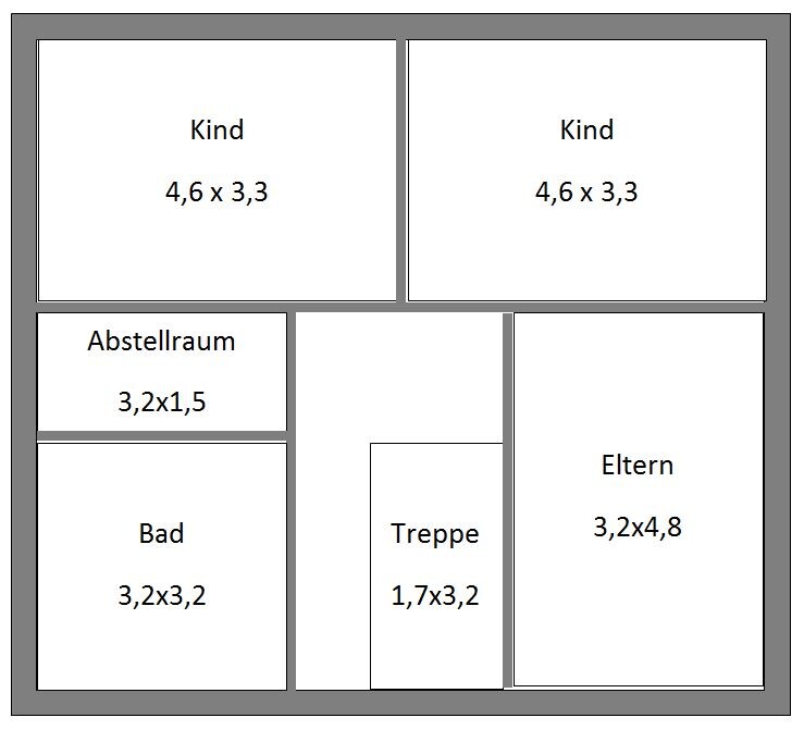

Own Floor Plan 2 [U](images ending with 295772-8-295772-9.png)
- DIY… We reviewed all floor plans again and came across the one with the staircase rotated 90°. I extended this plan to 9 m (30 ft) depth and shifted the stairs.
- I find this layout very flexible since the central axis can be moved depending on needs. The same applies vertically for the utility room and office.
- I like that with the stair positioning upstairs you come out behind the central axis, allowing large straight rooms to the south as well as to the other side.
- I thought about using another staircase but couldn’t find a good location, and it would mean no window in the upper hallway.
- The kitchen could also be open, or alternatively as our preferred closed kitchen. The dimensions shouldn’t feel too narrow.
- The entrance area might be a bit large, especially in front of the WC. But it could fit a slim sideboard, mirror, or day coat rack.
- The children’s rooms might be a bit too large. The central axis including stairs could be moved about 20 cm (8 in) toward the garden, but that would narrow the dining/living and cooking area.
- The master bedroom might be a bit narrow if the bed is placed on the right and a sideboard with TV on the opposite wall.
- Whether the stair overhang is enough to access the bathroom from there still needs to be checked in detail.
- We like the entrance area better with the two outer windows above. Whether to place two slim windows beside the front door or one larger window and then likely none on the top line needs further review.

StanSch schrieb:
And if a car eventually breaks down, we even consider whether just one car might be enough. From there, I have an almost perfect public transport connection to work. Even today, I commute by public transport to work, but I treat myself to the luxury of driving to the train station by car instead of taking the bus. That’s why we are also discussing parking options for several cars here... I just don’t get it.
Parking spaces for multiple cars... I don’t understand it We have 2 cars!
What might happen in x years is only of limited relevance for the current planning.
That I can also use public transport to get to work, as I do already, does not take into account other factors that require a second car: distance to the elementary school, personal hobbies, children’s hobbies, …
You might have noticed that the feedback is quite sparse. Many of your questions are either matters of personal preference, things you can simply try out yourself to find out, or there are no practical alternatives given this floor plan.
For example, the TV: take a measuring tape and mark 3.55 meters (12 feet) from the wall behind the TV, then move your armchair as it would be in use. Now decide what feels right to you.
For other issues, this floor plan simply doesn’t offer a solution. On the ground floor, the entrance area, hallway, and dining room are all narrow and uncomfortable corridor-like spaces. Whether the hallway is 5 centimeters (2 inches) wider or not makes no significant difference. Only if it were 50 centimeters (20 inches) wider might it become interesting, but where would you find that extra space?
By the way, I would always keep the utility room door at 86 centimeters (34 inches). For the guest WC and storage room, 76 centimeters (30 inches) is sufficient.
I would plan the storage room and children’s room so that you can place and use at least 50-centimeter-deep (20 inches) wardrobes in both. Allow about 3 centimeters (1 inch) tolerance for plaster and wallpaper. Of course, 60 centimeters (24 inches) would be better—you also need at least one meter (3 feet) of space in front of it to stand.
I would definitely raise the door to the bathroom. You need every bit of available space for storage or furniture.

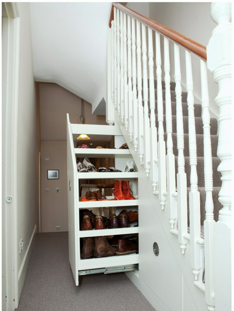

If I were you, I would have a carpenter make the space under the stairs usable. Perhaps the stair builder also offers prefabricated solutions. Here is a nice example that also gives you an impression of your hallway:
Otherwise, I strongly recommend revisiting the window layout. In the living room, that tiny door on the west side is the result of this whole terrace here and in the green forum? Hmm.
On the upper floor, there are no windows on the sides at all. It’s like a terraced house. Let the light in! At least for the children.
Well, and finally, you should probably start thinking about the exterior appearance. I’m afraid it still looks a bit odd.

kaho674 schrieb:
Maybe the stair builder also offers something prefabricated. I can ask.

The tiny door in the living room on the west side is the result of all the debate here and in the green forum? Of course, it could be made larger .
kaho674 schrieb:
In the end, you should slowly start considering the elevation. I’m afraid it still looks a bit odd. Which elevation do you mean exactly? The outside view?
kaho674 schrieb:
You might notice that the responses are very sparse. I notice .
I took the 10x9 floor plan again from @kaho674 and quietly sketched a bit. Not pretty, but hopefully readable.
I simply think that with a 270cm (106 inch) wide couch, a dining table with larger chairs, and a kitchen, in a house width of 10 meters (approximately 9.34 meters (30 feet 8 inches) inside), it always looks somewhat tight.
The six chairs I drew are all spaced out. In practice, we only use four chairs; the two at the ends remain pushed in, and when guests come, we move the table slightly away from the window.
Maybe there will be more feedback on this adjusted floor plan?
Regarding the question about TV viewing distance, I won’t provide a constructive response here for two reasons: first, because I fundamentally don’t agree with designing a floor plan based on the so-called quality of today’s TV programs—megapixels cannot compensate for a lack of content depth; and second—related to the already low priority implied by the first reason—because I would only seriously consider this if we were talking about a relatively upscale house. But not for the standard Bauhaus-style version of a Flair 113.
* This is just explained here because you are surprised by the lack of feedback.
And I don’t even know whether you use a bag or bagless vacuum cleaner—so how could I reasonably guess what width for the storage room door would be suitable?
Where Katja wrote "hose" on the floor plan, I see it as less of an issue. But it strikes me as odd that your wife does not want a “semi-detached house” floor plan, yet finds that terraced houses would have even fewer side windows.
The stair builder who installs a built-in closet would be a wooden stair builder. Concrete stairs come from the same precast plants as ceilings, so they certainly don’t offer such installations.
So go to a carpenter—but only after the actual existing staircase has been measured (from the top edge of the finished floor!).
Your little storage room sketch is not only unattractive but actually barely legible: it’s hard to see where the innovation is supposed to be. Therefore, I will also withhold feedback on that.
