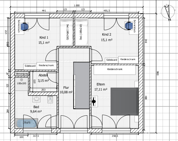

Own Floor Plan 1 [U](images ending with 295772-6-295772-7.png)
House design – why did the design turn out as it is?[/U]
- DIY… since we can’t let go of the basic structure from the builder and Signus, I also drew a bit. Access to the utility room was moved to the kitchen and a 1.25 m (4 ft) wide built-in closet wardrobe was planned in the hallway.
- Maybe the stairs should be moved a bit further left to get a larger living/dining area. This would allow making the WC narrower and possibly longer.
- The square dining/living room looks like it might not be used optimally later. The distance between TV and sofa is quite large at 5.87 m (19 ft).
- The upstairs hallway might be a bit too wide (due to the storage room). The wall between the storage room and the left children’s room could be moved left a bit. This would mean the door to the children’s room is not aligned with the stair railing but set a bit behind the wall at the stair’s end. Or could this be solved by adding a railing to the last step facing the left children’s room (similar to the builder’s floor plan)? On the other hand, such a wide hallway offers space for 30–40 cm (12–16 in) slim sideboards.
- The layout of WC and bathroom might be done differently.
- Windows and doors are not fixed yet and could be better positioned.
- We like the entrance area better with the two outer windows above.

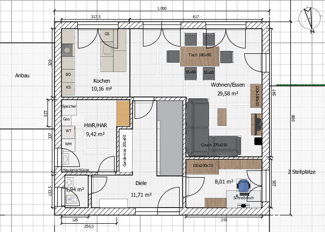

Own Floor Plan 2 [U](images ending with 295772-8-295772-9.png)
- DIY… We reviewed all floor plans again and came across the one with the staircase rotated 90°. I extended this plan to 9 m (30 ft) depth and shifted the stairs.
- I find this layout very flexible since the central axis can be moved depending on needs. The same applies vertically for the utility room and office.
- I like that with the stair positioning upstairs you come out behind the central axis, allowing large straight rooms to the south as well as to the other side.
- I thought about using another staircase but couldn’t find a good location, and it would mean no window in the upper hallway.
- The kitchen could also be open, or alternatively as our preferred closed kitchen. The dimensions shouldn’t feel too narrow.
- The entrance area might be a bit large, especially in front of the WC. But it could fit a slim sideboard, mirror, or day coat rack.
- The children’s rooms might be a bit too large. The central axis including stairs could be moved about 20 cm (8 in) toward the garden, but that would narrow the dining/living and cooking area.
- The master bedroom might be a bit narrow if the bed is placed on the right and a sideboard with TV on the opposite wall.
- Whether the stair overhang is enough to access the bathroom from there still needs to be checked in detail.
- We like the entrance area better with the two outer windows above. Whether to place two slim windows beside the front door or one larger window and then likely none on the top line needs further review.
A few more characters than 130.
- Is one of the floor plans good enough to build upon?
- Where would you position the garage?
- How would you position the TV area? The TV wall (creating about 1.8–2 m (6–7 ft) longer wall surface) on the south side with a view from the sofa into the garden? Or the TV wall inside the house?
- Both children’s rooms facing south (view of greenery) or rather west side (view of neighbor’s house)?

The floor plan will be mirrored so that the living/dining room on the west side can get an additional window.
On the west side, there will then be two parking spaces (possibly with a carport) one behind the other.
On the east side, there will be an extension or something similar to store bicycles etc. Optionally, another parking space is available there.
Here are my questions again and some new ones.
Ground floor:
- Is the TV area large enough, or should it be lowered by x cm (and accordingly shift the staircase)?
- The hallway is 2.35 m (7 ft 9 in) wide overall. The staircase is 1 m (3 ft 3 in) wide (plus a 0.2 m (8 inches) landing upstairs). Should the width stay like this or maybe be made a bit narrower?
- Should the door from the hallway to the living/dining room swing into the room or into the hallway?
- What makes the staircase and hallway look more inviting?
- Leave the staircase as is
- What to do with the space under the stairs?
- Leave it open?
- Storage room (accessible from where)?
- Place it on the other side, facing the utility room?
- Built-in wardrobes for coats and shoes?
- Rotate the staircase 180°
- This could enlarge the entrance area or allow built-in wardrobes for coats.
- The utility room is quite large and might invite one trade or another to get creative.

Upper floor:
- Keep the area in front of the children’s rooms as is, or move the door of child 2 further to the left, flush with the staircase landing?
- Make the storage room a bit narrower so that shelves 50 or 60 cm (20 or 24 inches) wide fit on one side.
- The shower will be moved a bit towards child 1 but with a gap, for example for technical equipment etc.
- How wide should the door to the storage room be?
- Is a 73.5 cm (29 inch) door enough, or should it be 86 cm (34 inches)?
- Raise the door to the bathroom (and thus to the bedroom) by 40-45 cm (16-18 inches) so that cabinets can still fit behind it? Or is there enough space between the bathtub and shower to place 1-2 narrow cabinets there?
- If the staircase stays as is: should an overhang be added?
Many thanks again to @kaho674 for your floor plans and friendly, factual responses.
I will try to redraw the house accordingly in parallel, including furnishing.

We also considered placing the terrace on the left side of the garden with the 8x11.25 m (26x37 ft) floor plan. Then you would basically have a 9x9 m (30x30 ft) green space.
But now comes what @ypg predicted:
We will stick with the 10x9 m (33x30 ft) floor plan. My wife doesn’t like the elongated shape of the house. It somehow looks like a semi-detached house, just without the other half.
She also doesn’t want to commit to a particular floor plan.
We both like the current one from the architect so far but are open to suggestions.
Ground floor:
- Leave it open?
- Maybe integrate the cloakroom there, accessible from the hallway?
- In return, open the area in front of the WC and possibly extend the utility room by about 25 cm (10 inches) towards the bottom of the plan.
- How wide should the doors to the utility room and WC be?
- Are 73.5 cm (29 inches) doors sufficient, or should they be 86 cm (34 inches)?
Upper floor:
StanSch schrieb:
We will stick to the 10x9 floor plan. My wife doesn’t like the elongated shape of the house. It somehow feels like a semi-detached house, but without the other half. No, that would be a proper landscape layout, just rotated by 90°. A square rarely works well when considered as a sum of mostly non-square rooms; the same basically applies to an almost square shape.
StanSch schrieb:
The floor plan will be mirrored so that the living/dining room can have a window on the west side. If only the emperor could have seen that.
StanSch schrieb:
On the west side, there will be two parking spaces arranged one behind the other (one possibly with a carport).
On the east side, an extension or something similar will be added to store bicycles and so on. That finally makes sense, and with cars used without fixed assignments or priorities, a tandem parking space is not a problem – although it might be that the building authorities count the third space as the second one only.
It may be that for the building authority only the third one counts as the second. A parking space could possibly also be created on the east side.
So, here is the mirrored floor plan with slight adjustments.
Maybe I will still get some feedback.
StanSch schrieb:
Maybe I will get a little feedback after all. For what purpose?kaho674 schrieb:
Why? Regarding the questions and ideas from this morning.
You already shared your opinion on this a few days ago.
Those who commented on which floor plan to build on supported the first floor plan (the Signus adjusted by the BT architect).
Now this is the chosen plan, and we would appreciate further constructive feedback on it.
