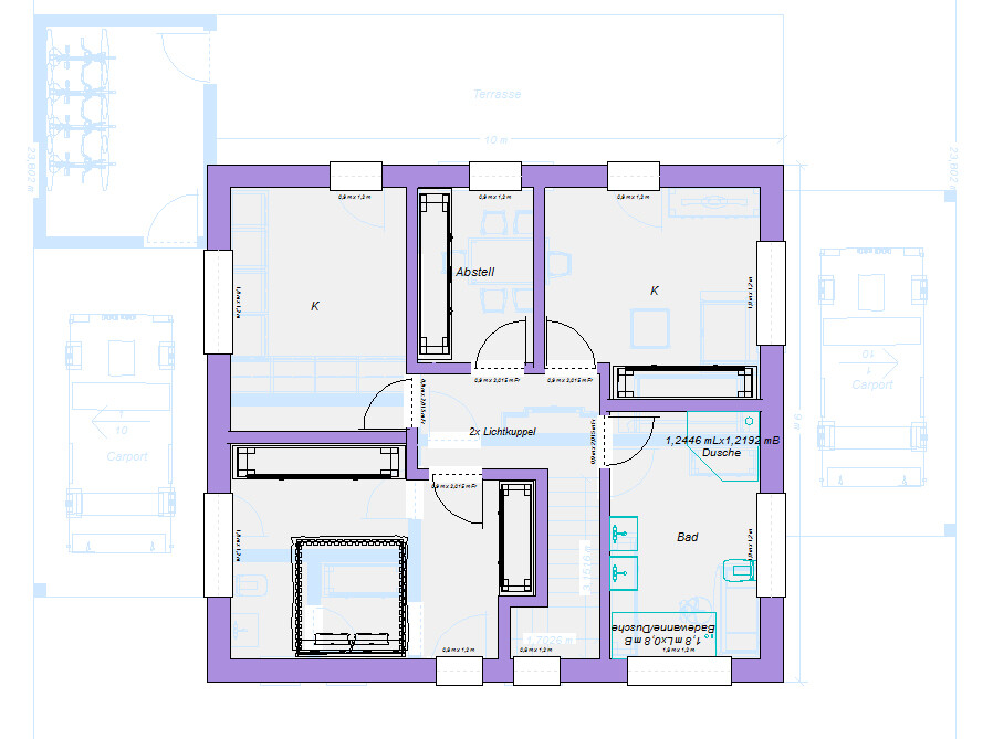

Own Floor Plan 1 [U](images ending with 295772-6-295772-7.png)
House design – why did the design turn out as it is?[/U]
- DIY… since we can’t let go of the basic structure from the builder and Signus, I also drew a bit. Access to the utility room was moved to the kitchen and a 1.25 m (4 ft) wide built-in closet wardrobe was planned in the hallway.
- Maybe the stairs should be moved a bit further left to get a larger living/dining area. This would allow making the WC narrower and possibly longer.
- The square dining/living room looks like it might not be used optimally later. The distance between TV and sofa is quite large at 5.87 m (19 ft).
- The upstairs hallway might be a bit too wide (due to the storage room). The wall between the storage room and the left children’s room could be moved left a bit. This would mean the door to the children’s room is not aligned with the stair railing but set a bit behind the wall at the stair’s end. Or could this be solved by adding a railing to the last step facing the left children’s room (similar to the builder’s floor plan)? On the other hand, such a wide hallway offers space for 30–40 cm (12–16 in) slim sideboards.
- The layout of WC and bathroom might be done differently.
- Windows and doors are not fixed yet and could be better positioned.
- We like the entrance area better with the two outer windows above.

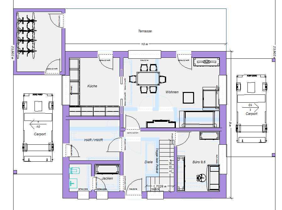

Own Floor Plan 2 [U](images ending with 295772-8-295772-9.png)
- DIY… We reviewed all floor plans again and came across the one with the staircase rotated 90°. I extended this plan to 9 m (30 ft) depth and shifted the stairs.
- I find this layout very flexible since the central axis can be moved depending on needs. The same applies vertically for the utility room and office.
- I like that with the stair positioning upstairs you come out behind the central axis, allowing large straight rooms to the south as well as to the other side.
- I thought about using another staircase but couldn’t find a good location, and it would mean no window in the upper hallway.
- The kitchen could also be open, or alternatively as our preferred closed kitchen. The dimensions shouldn’t feel too narrow.
- The entrance area might be a bit large, especially in front of the WC. But it could fit a slim sideboard, mirror, or day coat rack.
- The children’s rooms might be a bit too large. The central axis including stairs could be moved about 20 cm (8 in) toward the garden, but that would narrow the dining/living and cooking area.
- The master bedroom might be a bit narrow if the bed is placed on the right and a sideboard with TV on the opposite wall.
- Whether the stair overhang is enough to access the bathroom from there still needs to be checked in detail.
- We like the entrance area better with the two outer windows above. Whether to place two slim windows beside the front door or one larger window and then likely none on the top line needs further review.
A few more characters than 130.
- Is one of the floor plans good enough to build upon?
- Where would you position the garage?
- How would you position the TV area? The TV wall (creating about 1.8–2 m (6–7 ft) longer wall surface) on the south side with a view from the sofa into the garden? Or the TV wall inside the house?
- Both children’s rooms facing south (view of greenery) or rather west side (view of neighbor’s house)?

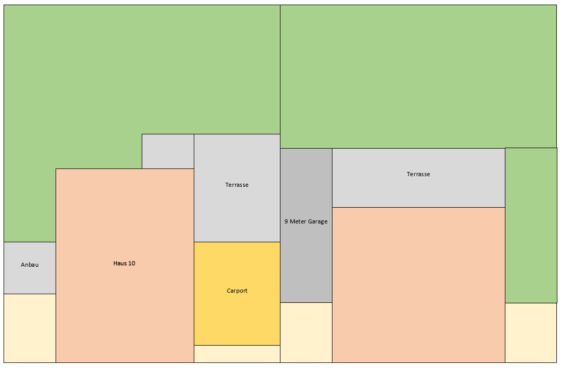

If I understand the intended use correctly, we're basically talking about both a carport AND a garage here, since "garage" in this thread mainly refers to a storage space for bicycles, lawnmowers, and trash bins, which is sometimes attached to the end of a carport.
A driveway that is only as wide as the building's width is too narrow if you want to pass by a car without scratching it. A sufficient width could be achieved if you decide on the "narrow" house design.
And: lucky is the person building in a state where the structure is allowed right next to the street. Of course, I would prefer my own garden over losing 5m (16 feet) of depth at the back for visitor parking spaces.
Two notes about the terrace: terraces (like living rooms) can also be placed on the gable ends of houses; it doesn’t have to be on a corner. Also, the green area (i.e. garden) and the paved area (i.e. terrace) need to come to an agreement about who gets which space—both cannot occupy the same area. One more note: sunlight travels in straight lines, but you can carry cake plates around the corner.
Maybe you could ask "over there" if Gerrit83 would like to participate here as well, or if he minds sharing his design here.

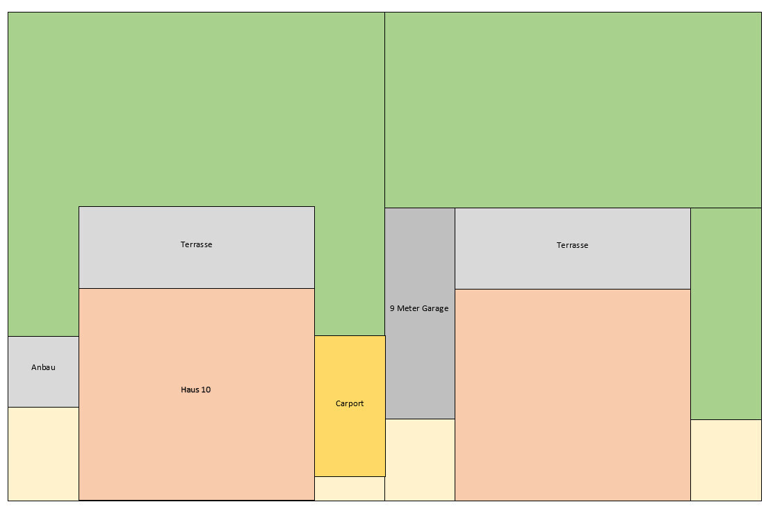

Gerrit’s designs were all 10x9 floor plans.
Here again are the two options compared side by side.
With the 8x11.25 variant, a 2 m (6.5 ft) terrace at the front leaves about 7.5 m (25 ft) of green space to the south, while the 10x9 variant with a 3.5 m (11.5 ft) terrace at the front offers approximately 8.3 m (27 ft) of green space.
With such a wide carport and a terrace behind it, I wonder if you’re not quite exposed. Of course, you can add a hedge or something else in between, but everyone on the turning area can look through the carport into the garden and onto the terrace.
Maybe you could ask over there if Gerrit83 would like to participate here as well, or if he would mind sharing his design here.Just copy it here for the general public. I don’t think forums sue each other over copyright. And if they do – it doesn’t really matter.C
