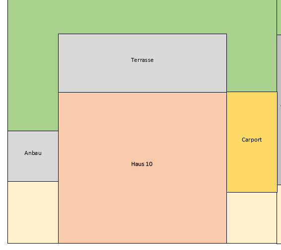

kaho6747 Dec 2018 11:02
StanSch schrieb:
What we need is a storage space where certain items can be kept, accessible both from the garden and the front of the house.
So one option could be to place a carport on the west side and then the storage space on the east side.
However, you should keep the possibility open to park a car on the east side as well. Because if the carport is extended further forward, then you can’t park a second car in front of it.
Yes, see the sketch by Yvonne in #34.
chand1986
7 Dec 2018 11:03
StanSch schrieb:
What we need is a shelter where certain things can be stored, accessible both from the garden and the front.
Carport on the west side with an enclosed space attached at the back.
I’ve been following the whole thread and honestly don’t understand some of the issues. The solutions are quite obvious here.
The carport still allows natural light in, so going west is more relaxed, which in turn improves the lighting inside the house AND the driveway situation. So, a carport instead of a 9m (30 feet) garage. Because the circumstances call for it. End of story. It’s a simple two-liner. What’s the problem?
And once that is settled, you can then discuss separately what makes sense inside the house. One thing at a time. If you try to solve all problems at once, you risk solving none.
And that’s how it looks here so far.

StanSch
7 Dec 2018 11:15
chand1986 schrieb:
Carport on the west side with an enclosed room attached at the back.
If a room is going to be added at the back, how will natural light get in? A glass roof? And will that provide enough light?
But all this only works if the house is narrower than 10 meters (33 feet).
Because if I can’t park a second car in front of the carport, I would have to park the other car on the east side.
kaho674 schrieb:
That’s why I would just put a sideboard underneath.
Actually, would you then place it directly against the wall facing the living room or artificially narrow the area under the stairs a bit with a (drywall) partition?
kaho674 schrieb:
The cloakroom is in front of the WC, right?!
See the picture.
You could also extend the utility room a little further down, for example, aligned with the first stair step. And where the cloakroom was previously planned, you could place something like a sideboard with a mirror.
kaho674 schrieb:
You’re not putting oak in the middle? I know someone who’d be happy to give you one…
Let me think briefly… no thanks.
StanSch
7 Dec 2018 11:27
Here is a quick sketch.
Floor plan of House 10 with terrace on top, carport on the right, extension on the left, and green garden.
