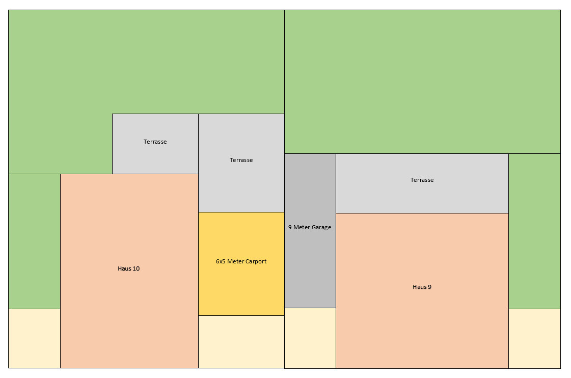

- 2 parking spaces (1x 9 m (30 ft) garage), garage on the east side?

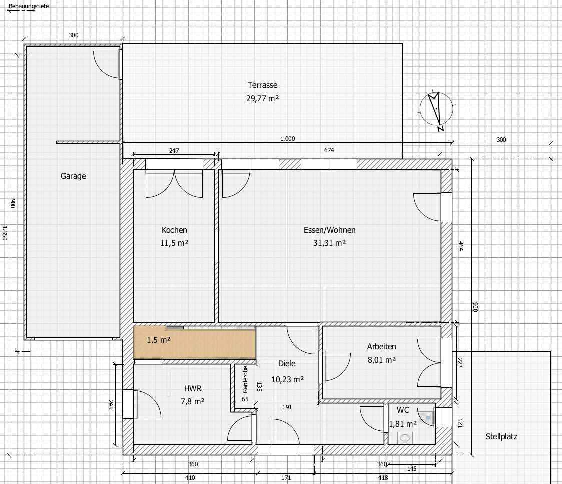

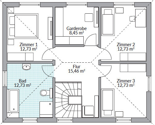

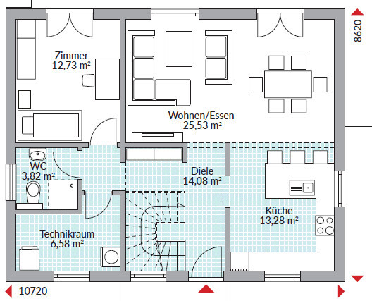

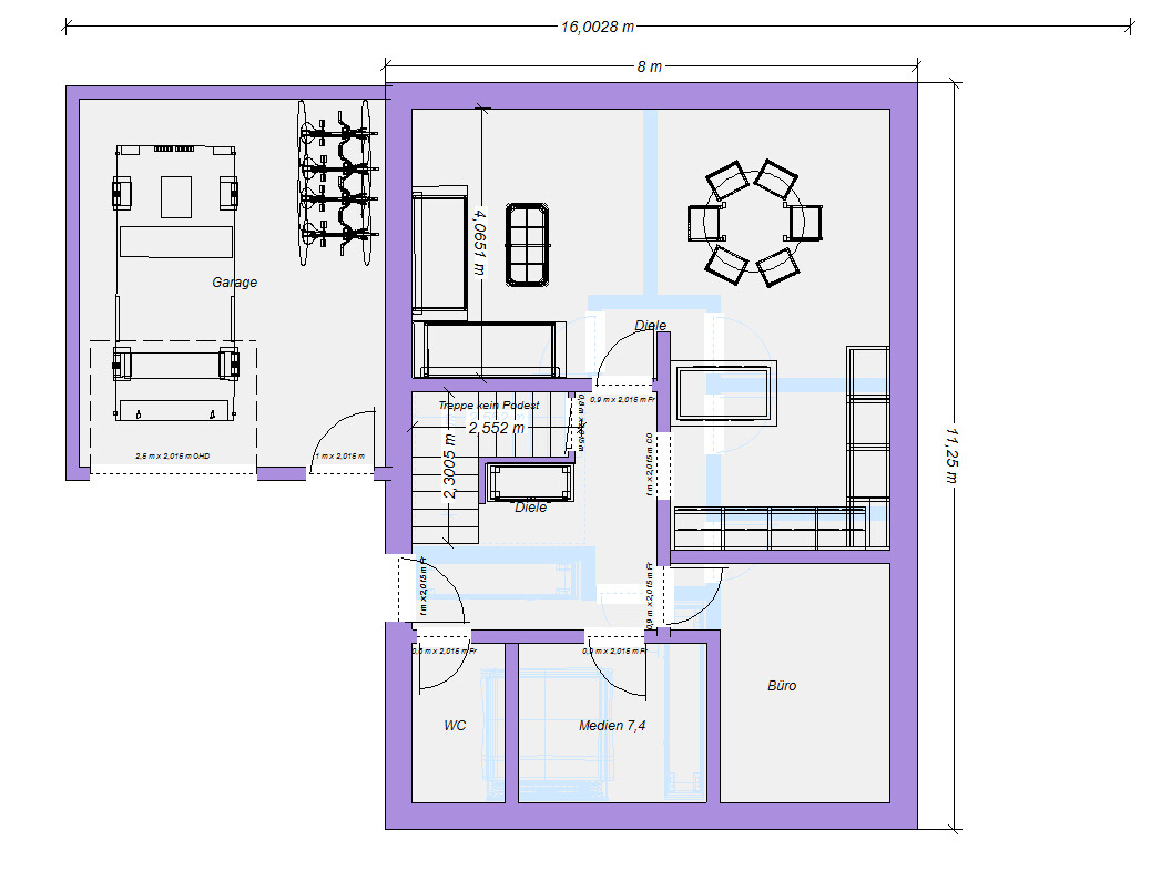

Builder’s floor plan (images ending with 295772-295772-5.png)
House design – why did the design turn out as it is?
- The builder’s architect based the floor plan on the Signus by Kern-Haus.
- We like the basic structure so far.
- The front entrance with the door and the windows above feels much more inviting than the standard floor plan.
- Is the front door drawn too large?
- The door to the living room is not ideal. Depending on kitchen layout, it would be in the way when open.
- Would a window sill height of 1.01 m (3.3 ft) be sufficient for the kitchen window? The left window in the dining area facing the terrace could perhaps be made floor-to-ceiling. It might not look perfectly symmetrical from the outside, but it would look the same from the inside in the dining area.
- Due to the quarter-turn staircase with one step on the exit, the entrance hall area was reduced at the expense of the TV area. Is the TV area still large enough?
- The entrance hall is quite large because of the quarter-turn staircase with the step on the exit. How could this space, especially under the stairs, be better used? Maybe with a built-in closet or storage room (with its own access)? We also once thought about rotating the staircase 180° and using the area under the stairs at the entrance as a wardrobe (built-in closet). But then what about the door to the living room? And how would it look when entering the house and seeing a cupboard right away? On the other hand, it might make sense to swap the front door with the window element.
- The utility room has a 73.5 cm (29 in) door. Is that sufficient or would an 85 cm (33.5 in) door be better?
- For the WC, we might prefer the door to open inward and swap the toilet and washbasin.
- The two bed niches in the children’s rooms don’t look optimal at first glance. On one hand, only a wider bed fits here, and the other child would have to place a bigger bed elsewhere later (unless sleeping partially under the window). On the other hand, from this niche, you can’t see who enters the room. Maybe this deep niche is better for the entrance and perhaps a wardrobe with a headboard? Or the partition wall could be shifted a bit left (centered between the two windows), so that beds fit properly in both niches and bigger beds would protrude a little.
- The storage room could perhaps be a bit narrower in favor of the bathroom. Maybe it would look better with an 85 cm (33.5 in) door here as well?
- The heating system will likely be underfloor heating with a gas condensing boiler and solar storage for hot water support.

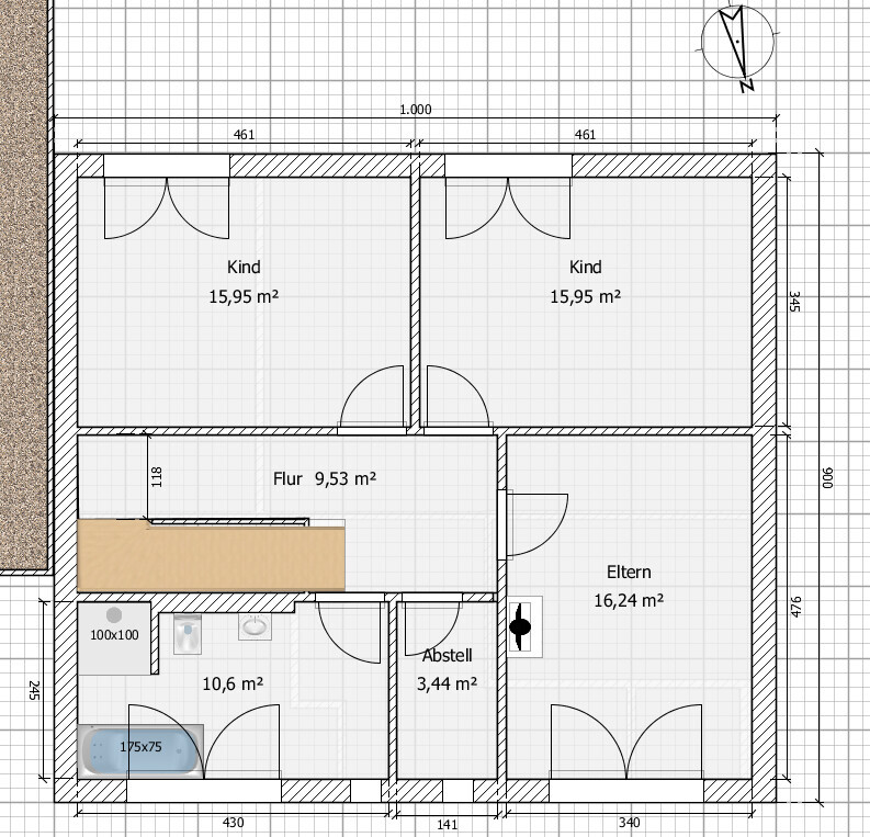

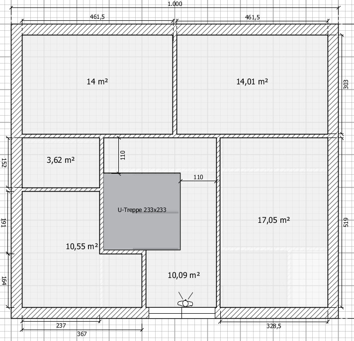

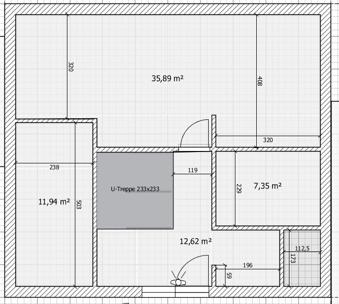

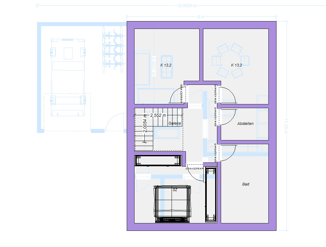

Own Floor Plan 1 [U](images ending with 295772-6-295772-7.png)
House design – why did the design turn out as it is?[/U]
- DIY… since we can’t let go of the basic structure from the builder and Signus, I also drew a bit. Access to the utility room was moved to the kitchen and a 1.25 m (4 ft) wide built-in closet wardrobe was planned in the hallway.
- Maybe the stairs should be moved a bit further left to get a larger living/dining area. This would allow making the WC narrower and possibly longer.
- The square dining/living room looks like it might not be used optimally later. The distance between TV and sofa is quite large at 5.87 m (19 ft).
- The upstairs hallway might be a bit too wide (due to the storage room). The wall between the storage room and the left children’s room could be moved left a bit. This would mean the door to the children’s room is not aligned with the stair railing but set a bit behind the wall at the stair’s end. Or could this be solved by adding a railing to the last step facing the left children’s room (similar to the builder’s floor plan)? On the other hand, such a wide hallway offers space for 30–40 cm (12–16 in) slim sideboards.
- The layout of WC and bathroom might be done differently.
- Windows and doors are not fixed yet and could be better positioned.
- We like the entrance area better with the two outer windows above.

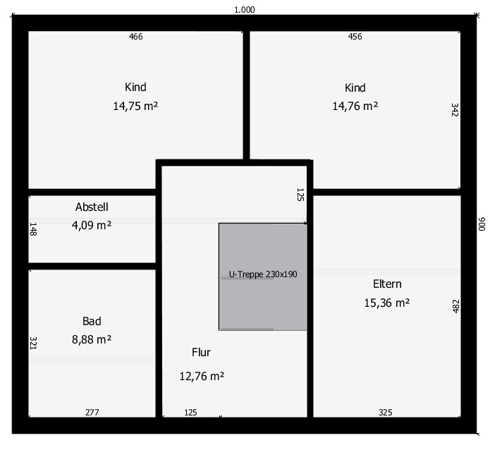

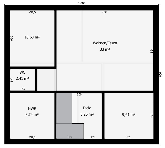

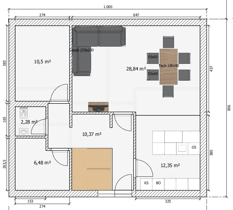

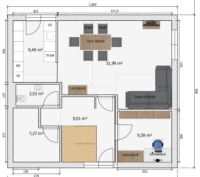

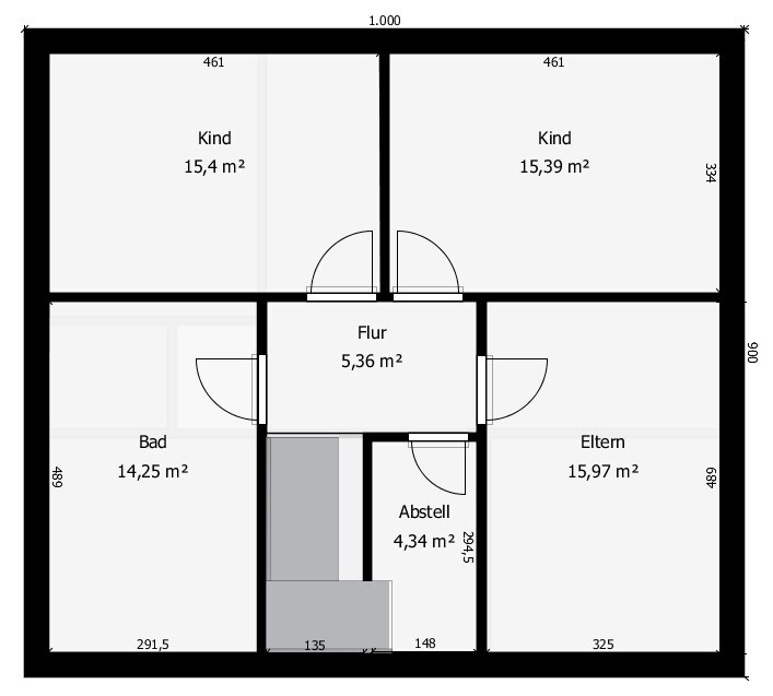

Own Floor Plan 2 [U](images ending with 295772-8-295772-9.png)
- DIY… We reviewed all floor plans again and came across the one with the staircase rotated 90°. I extended this plan to 9 m (30 ft) depth and shifted the stairs.
- I find this layout very flexible since the central axis can be moved depending on needs. The same applies vertically for the utility room and office.
- I like that with the stair positioning upstairs you come out behind the central axis, allowing large straight rooms to the south as well as to the other side.
- I thought about using another staircase but couldn’t find a good location, and it would mean no window in the upper hallway.
- The kitchen could also be open, or alternatively as our preferred closed kitchen. The dimensions shouldn’t feel too narrow.
- The entrance area might be a bit large, especially in front of the WC. But it could fit a slim sideboard, mirror, or day coat rack.
- The children’s rooms might be a bit too large. The central axis including stairs could be moved about 20 cm (8 in) toward the garden, but that would narrow the dining/living and cooking area.
- The master bedroom might be a bit narrow if the bed is placed on the right and a sideboard with TV on the opposite wall.
- Whether the stair overhang is enough to access the bathroom from there still needs to be checked in detail.
- We like the entrance area better with the two outer windows above. Whether to place two slim windows beside the front door or one larger window and then likely none on the top line needs further review.
A few more characters than 130.
- Is one of the floor plans good enough to build upon?
- Where would you position the garage?
- How would you position the TV area? The TV wall (creating about 1.8–2 m (6–7 ft) longer wall surface) on the south side with a view from the sofa into the garden? Or the TV wall inside the house?
- Both children’s rooms facing south (view of greenery) or rather west side (view of neighbor’s house)?

Site plan:
So, we are now at post 55, and much of the discussion revolves around the past in another forum.
Very few responses addressed the actual questions. So far, I have received feedback from @haydee, @kaho674, @montessalet, and @ypg.
Unfortunately, I presented the floor plans somewhat unclearly. All four refer to the first floor plan. But does that mean the architect’s version, with the living room area behind the stairs, or the self-drawn one with the square living/dining room? I understood from @kaho674 and @montessalet that they prefer the architect’s version.

between our house wall and the neighbor’s garage .kaho674 schrieb:
The terrace is going to face south anyway. Never... With the idea from @ypg, it would look roughly like this.
And then part of the corner terrace would be between the garage of house 9 and the own house. And theoretically, the garage of house 10 could still be moved further. Also, the corner is not very deep if a carport or garage is planned in front of it. The ground floor window on the west side would then have to be in the area of the west terrace. A window under a carport only helps to a limited extent, right?
With a 10x9 m (33x30 ft) house, the green space behind the terrace would be deeper than with an 8x11.25 m (26x37 ft) house. Unfortunately, the plot is only about 23.8 m (78 ft) deep.

This offer for 450 grand – for how many square meters of floor area is that? Exactly the 9x10? So you could also do 11.25 x 8, for example? That’s how I always understood it. The price referred to the floor area.
I was referring to the one from the architect.
Yours, with the almost square living-dining area, is extremely difficult to furnish.
I would prefer a utility/storage room plus a carport. If the bicycles are stored in the garage, it will be left open all day. Children don’t open and close it.
I think all this talk about terraces is complete nonsense. You can decide wherever you want to place your terrace. No one is forcing you to build a corner terrace. And an extra meter in the garden won’t make much difference there. But inside the house, the gain could be significant.
Here’s an example with an 8m (26 ft) width and a 5m (16 ft) garage. There’s plenty of space for bikes and some extra gear. The house can let in the western sunlight, and the terrace naturally faces south.
I’ve left out the windows in the sketch for simplicity.
