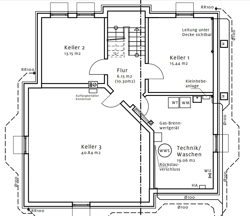

The idea actually came to me through Cumpa’s thread about light wells:
If I connect the basement to the mechanical ventilation system, could I then also do without basement windows?
Background: initially, we did not plan for a mechanical ventilation system, so we naturally included windows in the basement rooms. Now, however, we are including mechanical ventilation, and the basement will be ventilated as well.
So the question is whether we could simply omit the windows in basement rooms 3 (storage room) and the utility room. The light wells there are somewhat inconvenient anyway...
Basement room 2 will be an office with a light well, so these windows are fixed. Due to our design flood level, these will also be flood-resistant windows along with drainage for the light well.
For basement room 1, I am uncertain; it will be my workshop, so I will probably keep the window there.
Whether this really makes sense, I don’t know yet. For the light well in basement 2, I will need drainage anyway and have to run it to the inspection chamber. So the potential savings may be limited to the flood-resistant windows in basement 3 and the utility room, plus the light wells. Together, that will already be around 3,000 to 4,000 euros.
