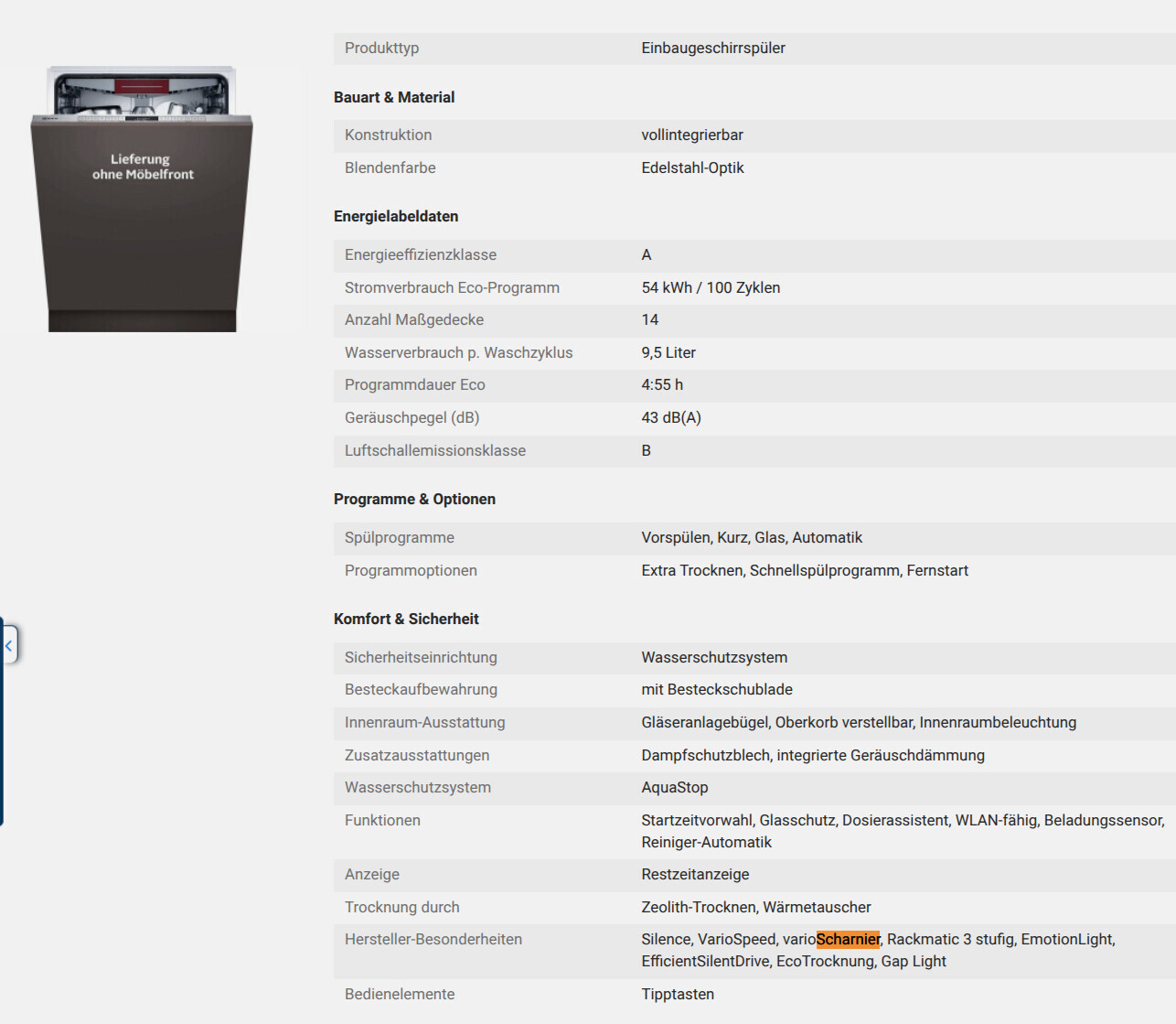

Tolentino21 Nov 2025 14:38
No, the dishwasher must have a Vario hinge. Its door needs to be attached with that. So either you were lucky and your new one happened to have it, or Faktum didn’t include it yet.

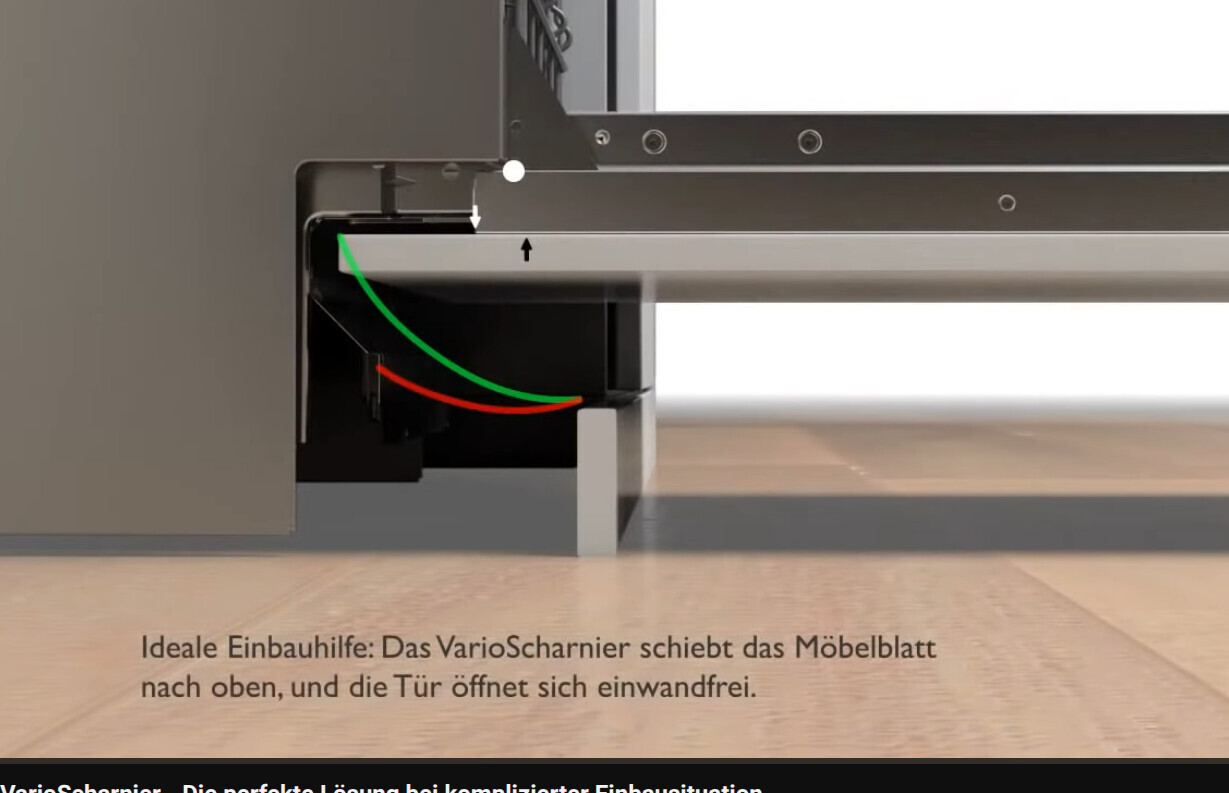

Tolentino21 Nov 2025 22:37
No,
the hinge is a feature of the dishwasher. It moves the front panel upward when the door opens because otherwise it would hit the base panel at the bottom, due to the slightly different construction of IKEA cabinets. Alternatively, it is possible to use flip-up toe kicks.
However, I just noticed that variable hinges seem to be more common now than before.
Lower cabinet part with variable hinge pushing the panel upward as the door opens.
