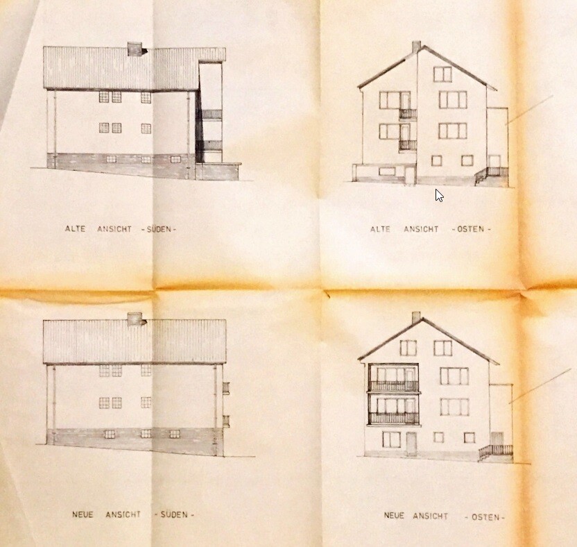

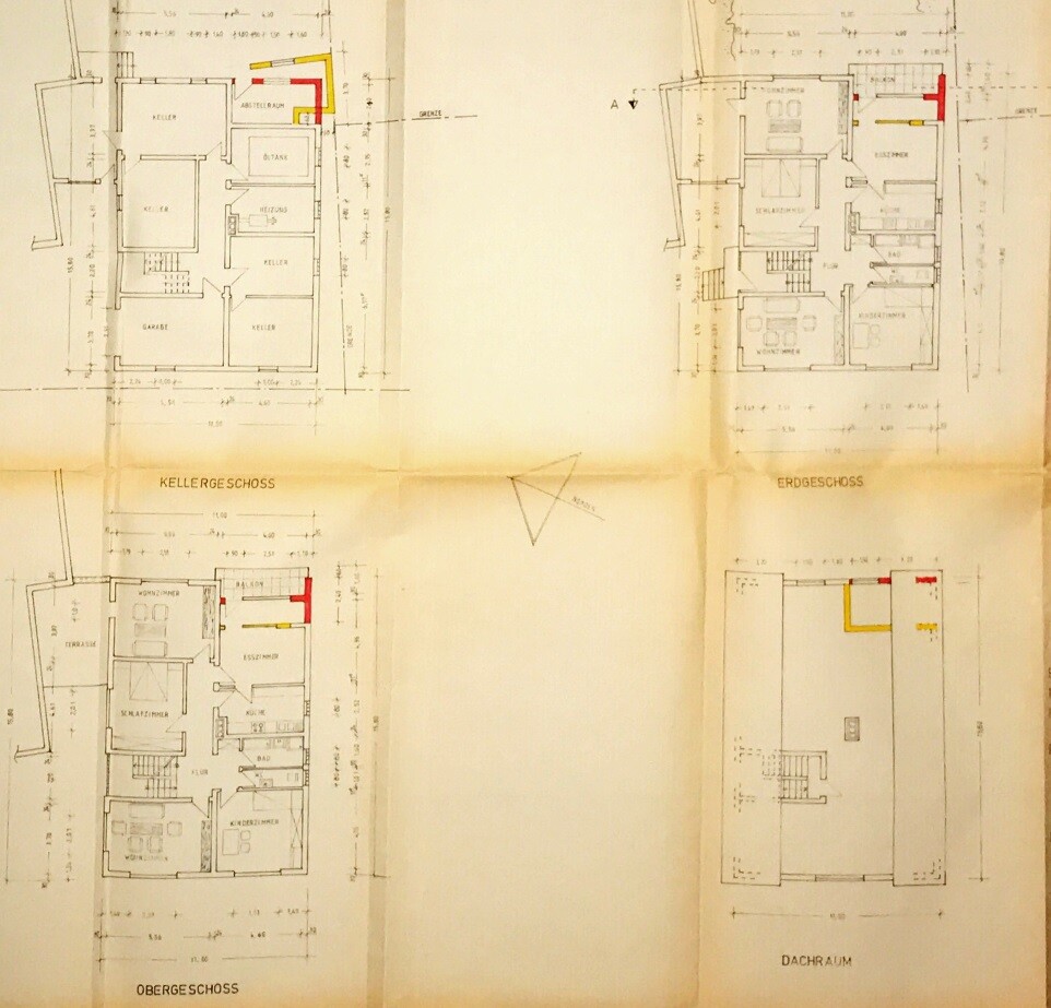

I’ll upload some older plans shortly – I think it will make things clearer. We are also removing the glass blocks in the stairwell and will brick it up (including a window between the ground and upper floors).
We don’t have any children yet – there are currently two of us. Kids are planned.
Architectural drawings: old and new house views south and east side
Multi-part building plan with floor plans of basement, ground floor and upper floor.

Yes, it’s become clear to me now as well. I’ve uploaded the old plans and hope they are readable. I’m still searching through the documents for the site plan. The plans were not implemented exactly as designed. I’m still looking for the latest version of the plan.
