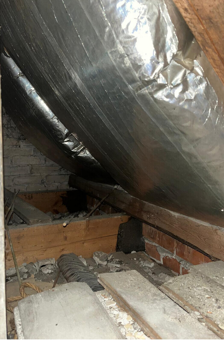

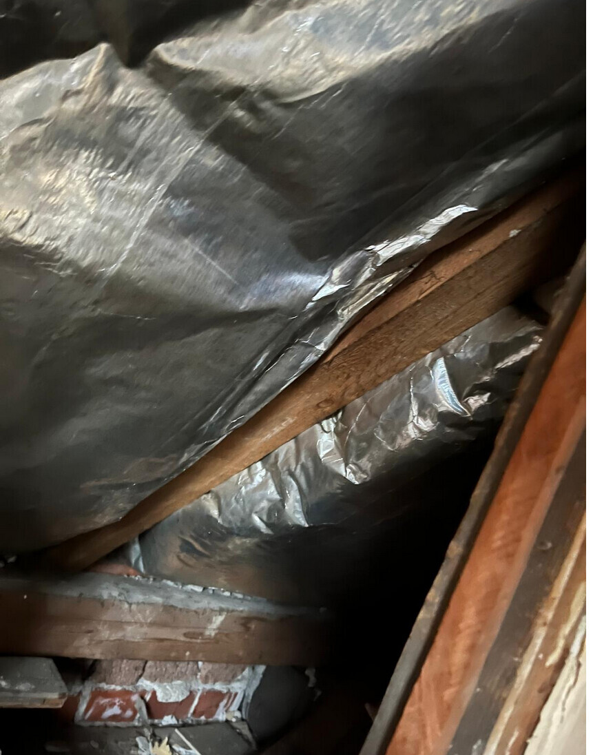

Current situation:
A 90sqm (970 sqft) single-family house roughly built in the 1960s with ground floor and first floor (+ an uninsulated attic).
Roof structure: Tiles -> roofing felt (probably) -> wooden sheathing -> aluminum-faced mineral wool insulation (already damp/soft).
Since I want to renovate everything upstairs, replace the old OSB extension and wooden felts, and install a roof window and drywall, here are my thoughts after already reading quite a bit.
Primary goal: To preserve the building structure and avoid mold inside the house.
Therefore, the plan:
Knee wall
Aluminum-faced insulation:

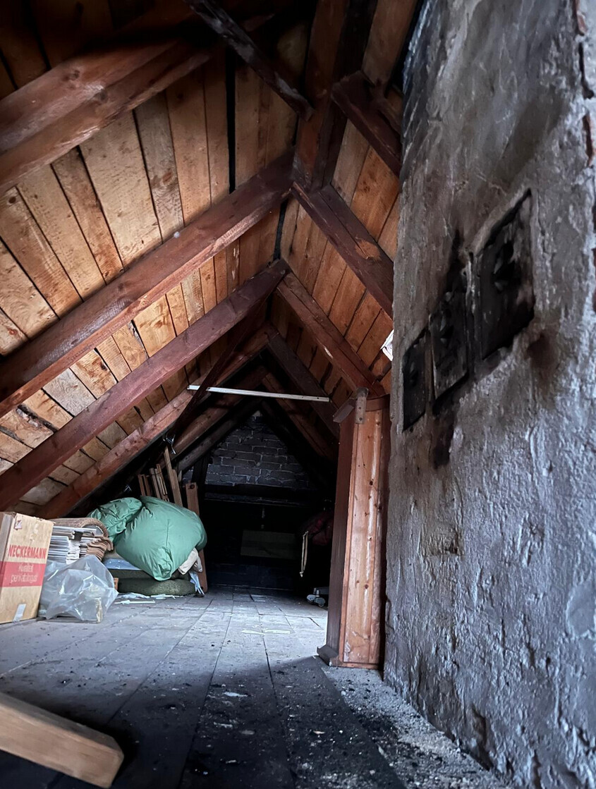

In the last picture of the attic, you can see roofing felt on top.
Current situation:
- Remove any extension
- Remove aluminum-faced insulation
- Install insulation between rafters using stone wool or glass wool
- Use a vapor retarder (one that can redirect moisture back inside during summer)
- Install drywall
Knee wall
