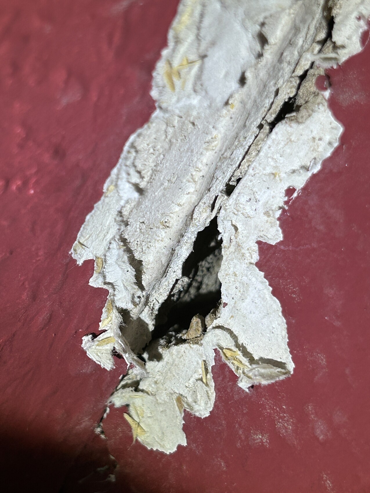

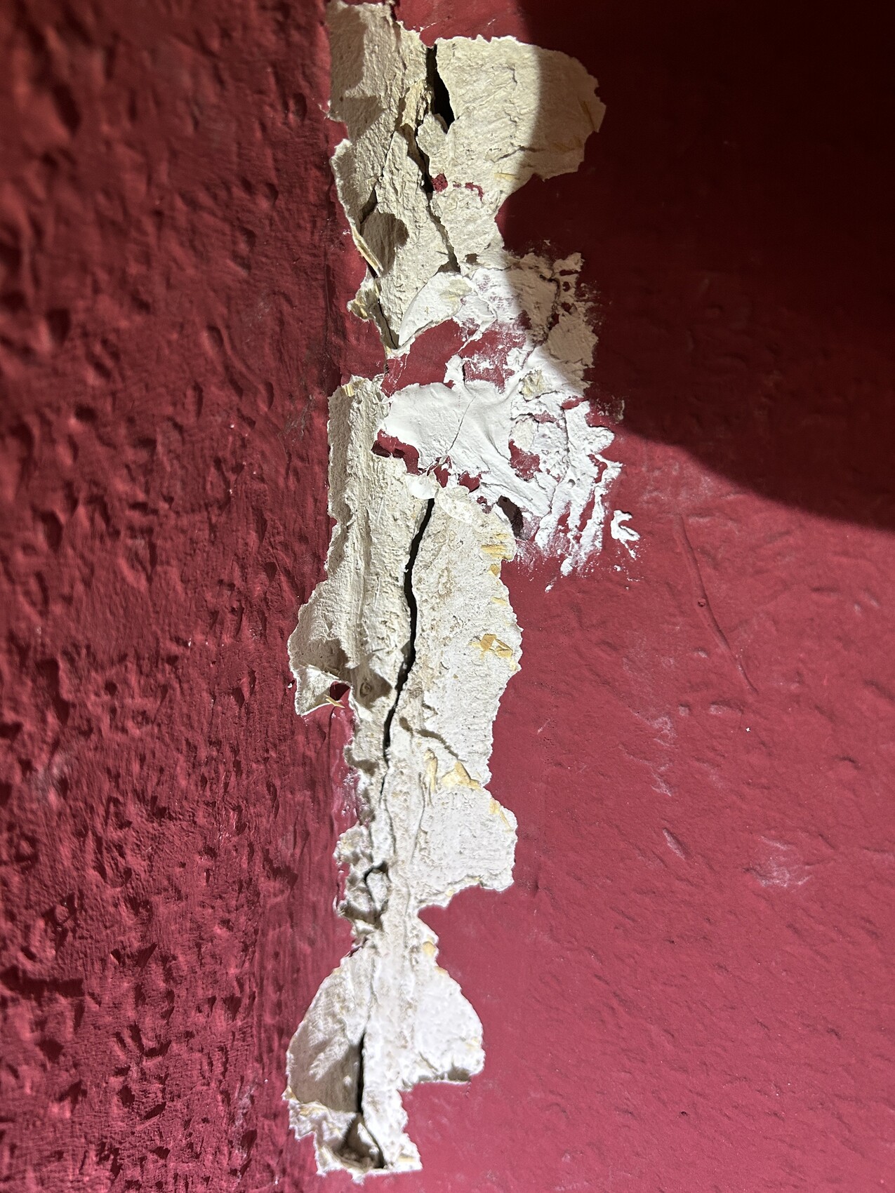

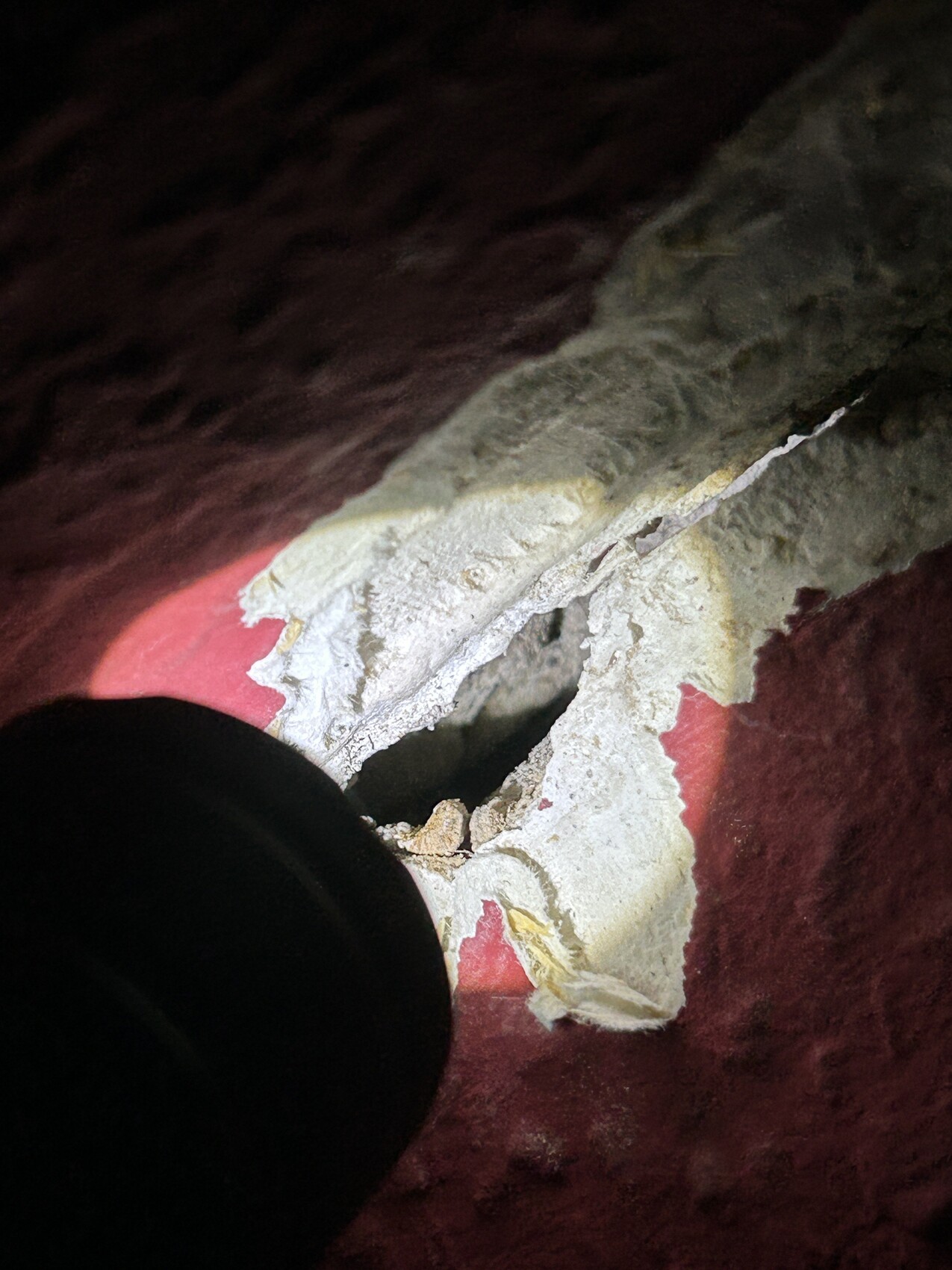

I need your advice.
I have rented an older apartment and unfortunately noticed drafts coming through the wall as well as noise from the street.
I have now removed some of the wallpaper and discovered a crack running from top to bottom at the corner where two exterior walls meet.
Sometimes the building also shakes, similar to an earthquake, which is caused by a heavily loaded train passing about 130 m (425 feet) away.
Can I repair this crack myself by injecting a ready-to-use acrylic-based mortar from a cartridge along the crack, and if there is a hole where the applicator fits, fill it that way?
If this is possible, how exactly should I proceed? Afterwards, I would apply filler over the area and then repaint with regular wall paint, similar to filling a drill hole.
Pictures attached.

Why acrylic? Any standard filler would do. Because whether it’s gypsum, acrylic, or cement, the crack is just a symptom of a bigger problem. If it bothers you, go ahead and fill it. But chances are, you’ll be facing the same issue again in 12 months. (By the way, in any court in this country, you would win if your landlord tried to terminate your lease because of this crack).

I once experienced something similar in an apartment. No matter how you try to fix it, the crack will reappear sooner or later. This is because the two exterior walls move independently, possibly also due to traffic vibrations from the railway. Neither plaster nor acrylic sealant can prevent this.
Given the troubled tenant-landlord relationship, I would rather focus on finding a different apartment.
