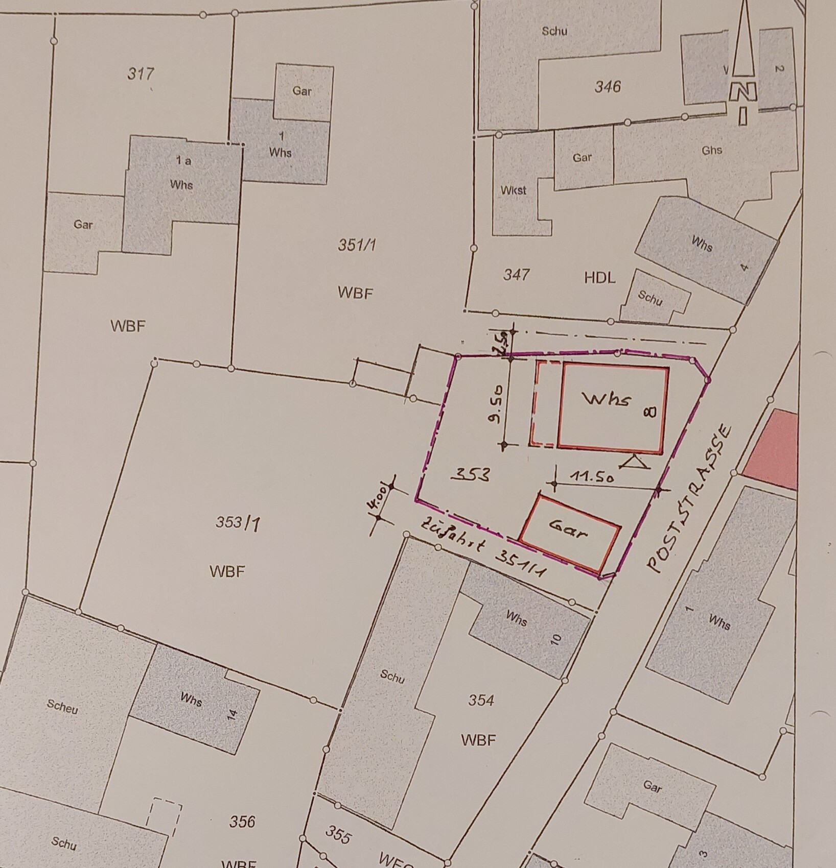

Plot size: 573m2 (6,171 sq ft)
Slope: no
Site coverage ratio: no development plan
Floor area ratio: no development plan
Building envelope / building line / boundary: Requirement that the house should be positioned similarly to the previous house on the plot (heritage-listed, but no longer salvageable)
Border development: to the north (top), a 2.5m (8 ft) setback from the center of the path must be maintained

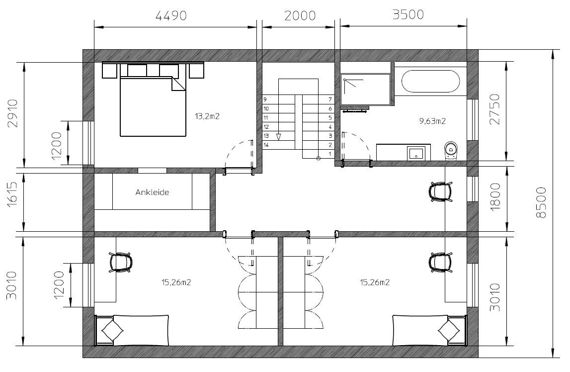

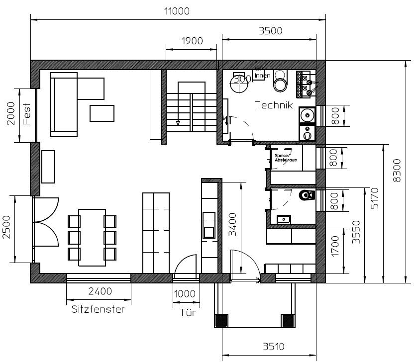

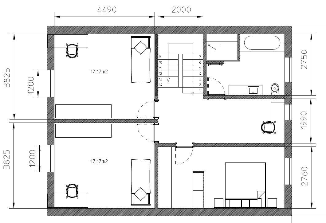

Wish: platform staircase for aesthetic and comfort reasons, lots of natural light on the ground floor, space for a small study that can also be used as a guest room
Who designed it: The plan is from me (engineer, can’t help myself), almost adopted 1:1 from several prefab home suppliers and my carpenter’s design office
What do you especially like? The open layout of the ground floor facing the garden
What don’t you like? Why?: The upper floor, as there is always some unused space and no proper walk-in closet (though the walk-in closet is not a must since there’s no woman in the house ;-) )
Price estimate according to architect/planner: 365,000 as a shell house
Personal price limit for house, including fittings: 510,000
Preferred heating system: air-to-water heat pump with underfloor heating, ventilation system
If you had to give up, which details or expansions
- you could give up: walk-in closet and … if it really brings a big advantage -> platform staircase
- you couldn’t give up: open living-dining area
Why did the design turn out like it is now? For example:
Standard design from the planner?: Looked at many show homes, thought it through, then created several variations myself in CAD
Which requests were implemented by the architect?
What makes it, in your opinion, particularly good or bad? The room layout on the upper floor gives me a headache... it can definitely be optimized
The dimensions in the hand sketch of the site plan are not 100% accurate, it still shows 9.5m (31 ft), but now I’m at around 8.3-8.5m (27-28 ft)
