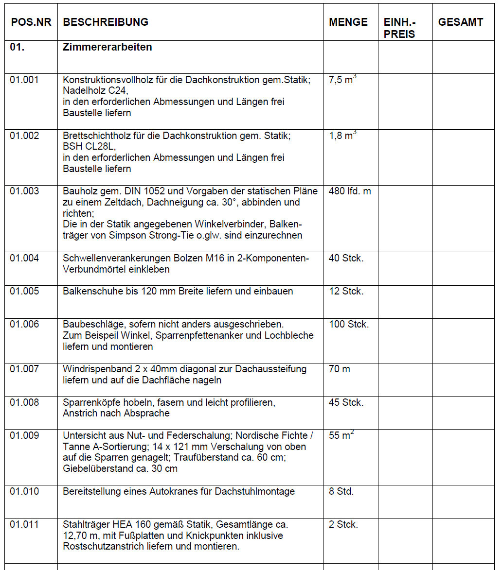

For example, the roof structure was tendered like this (just an excerpt) – qualities and quantities or tasks. To create such tenders, people usually have vocational training or even a university degree.
Just as an example: would you know anything about item 01.008? If you don’t request these things, you end up with generic rafter ends and have to paint them yourself. General contractor 1 includes these items (maybe without commenting), general contractor 2 does not. But general contractor 2’s offer is cheaper. Can you compare that?
Table with item number, description, and quantity for carpentry work and materials.

Just as an example: do you know anything about item 01.008? If you don’t specifically request these things, you’ll end up with standard rafter ends and have to paint them yourself. General Contractor (GC) 1 includes these items (maybe without saying anything), GC 2 does not. But GC 2’s offer is cheaper. Can you compare that?
