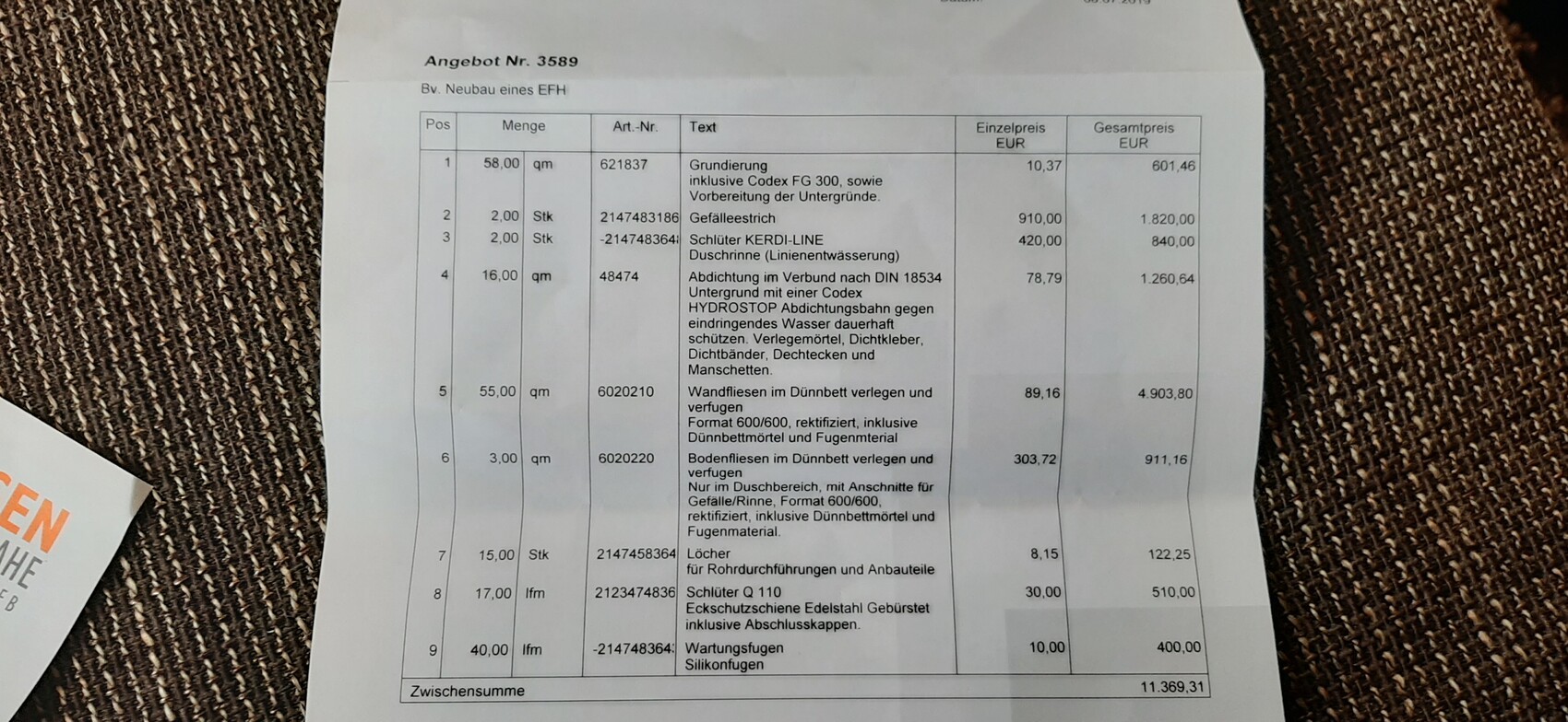

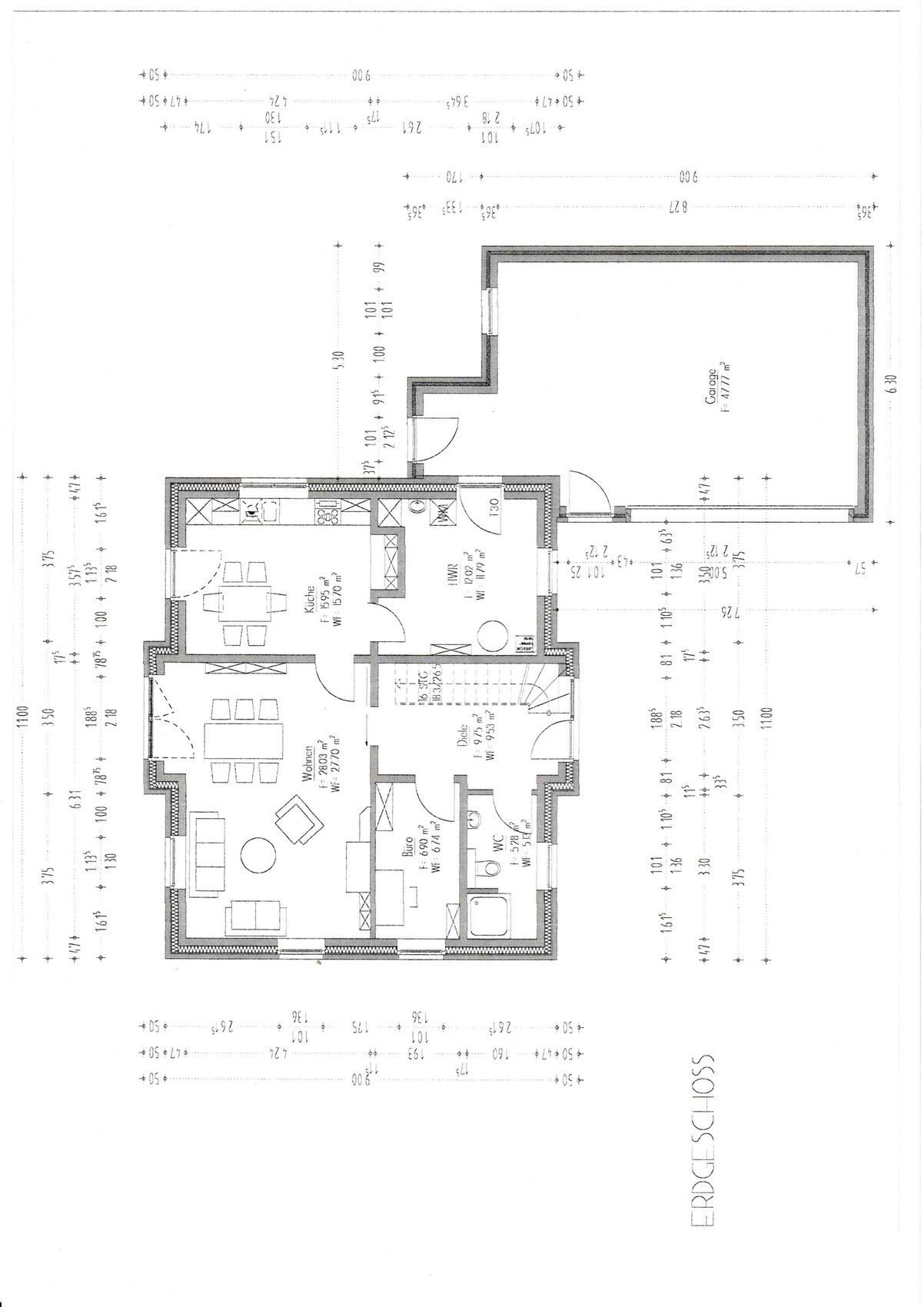

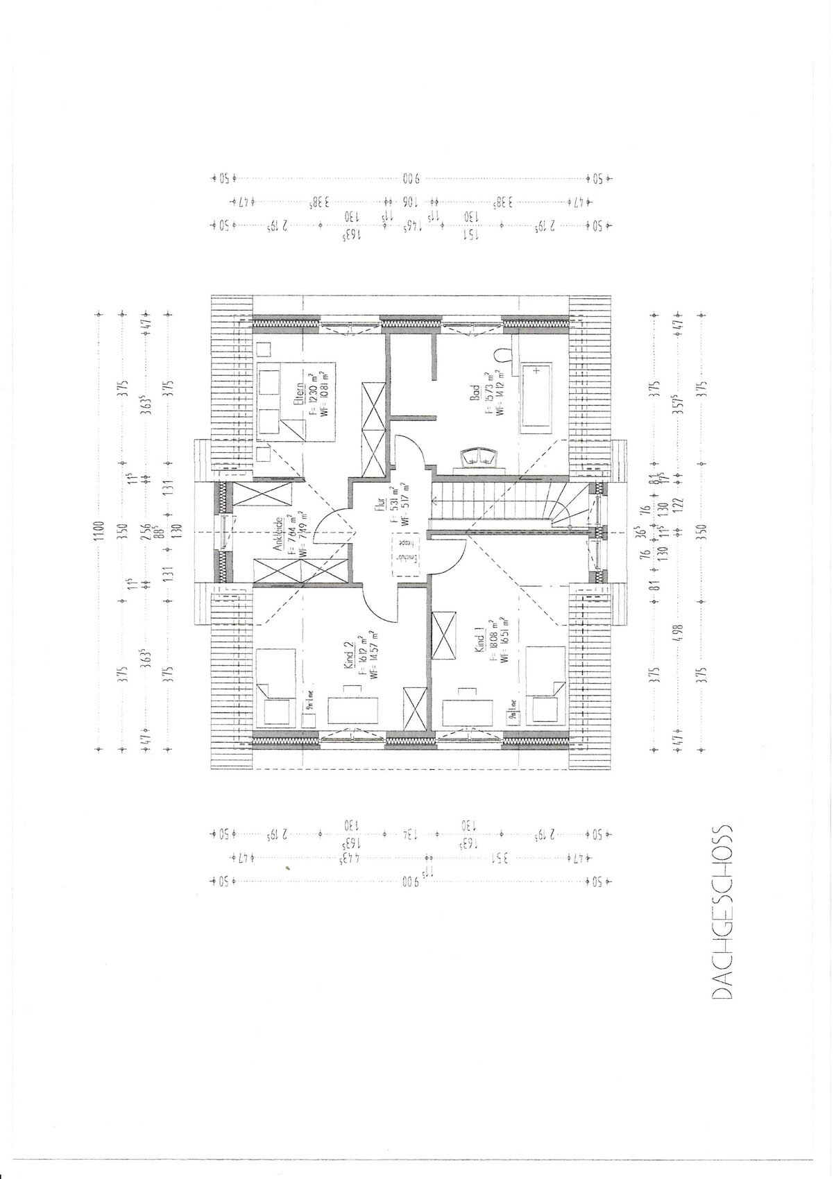

Hello. My girlfriend and I are planning to build a house. In the bathrooms upstairs and downstairs, the walls should be tiled all around up to a height of 1.50 meters (5 feet). In the upstairs bathroom, the wall behind the bathtub is only 90 cm (35 inches) high. (The layout of the bathtub and toilet is provisional.) Both showers will have rectangular drains with the appropriate slope for drainage. The shower partitions upstairs are 1.90 meters (6 feet 3 inches) high. The partition downstairs is made of glass.
What do you think about the quote? Honestly, it seems very expensive to me, doesn’t it? The quote does not include tiles!
90 euros/m2 net for wall tiling work, excluding materials? Phew... if these were 120 x 120 cm (47 x 47 inches) tiles, maybe. But like this... it sounds more like a defensive offer. Definitely get two more quotes!

The project might also be too small.
All items are very expensive.
Over €900 net for the sloped screed of a walk-in shower. Crazy.
Almost €90 net to install 60x60cm (24x24 inches) tiles on the wall. I would have to check, but I think we paid at most half that – with larger format tiles.
guckuck2 schrieb:
Over 900€ net for the sloped screed in a walk-in shower. Crazy. Actually, it’s only half as expensive: there are two showers. And the shower channels are quite tricky to install when you have to cut the tiles like that.
Almost 90€ net to install 60x60cm (24x24 inches) tiles on the wall. I’d have to check, but I think we paid at most half that – with larger format tiles. Yep, THAT is the madness that makes the whole package so expensive. Keep in mind, for 60x30cm (24x12 inches) tiles!

Effectively, it is only half as expensive: there are two showers.It’s 2 times over 900€ net.Similar topics
