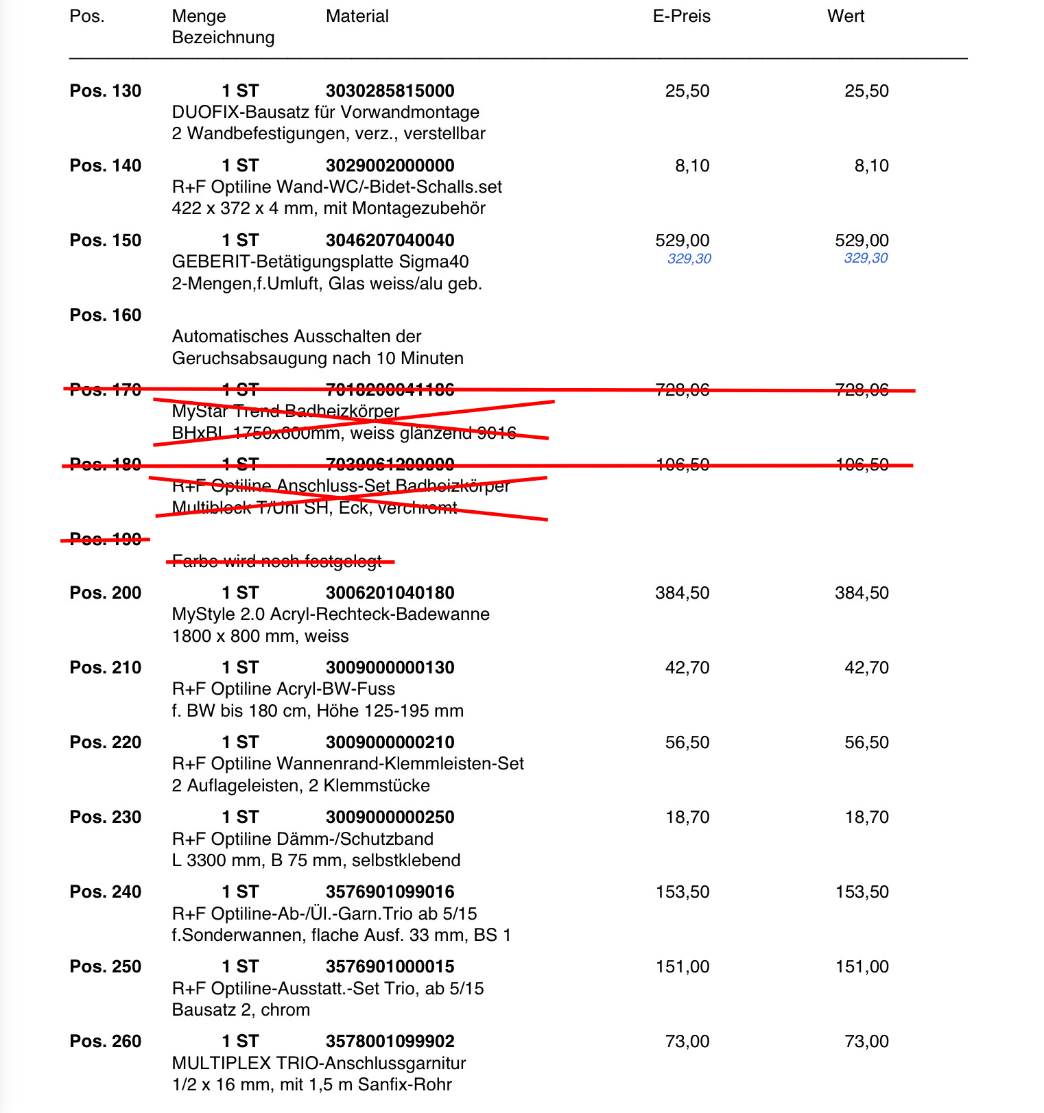

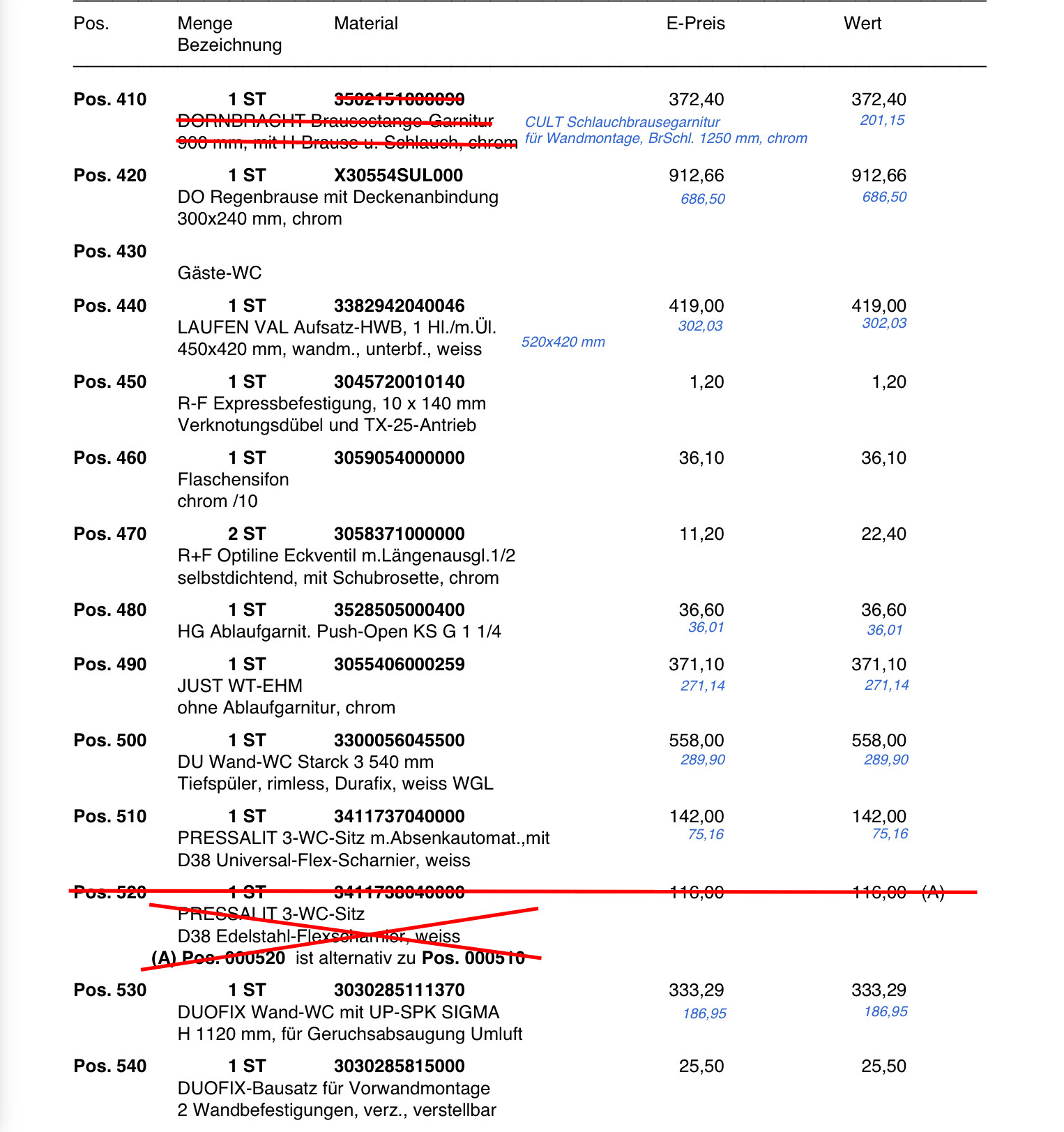

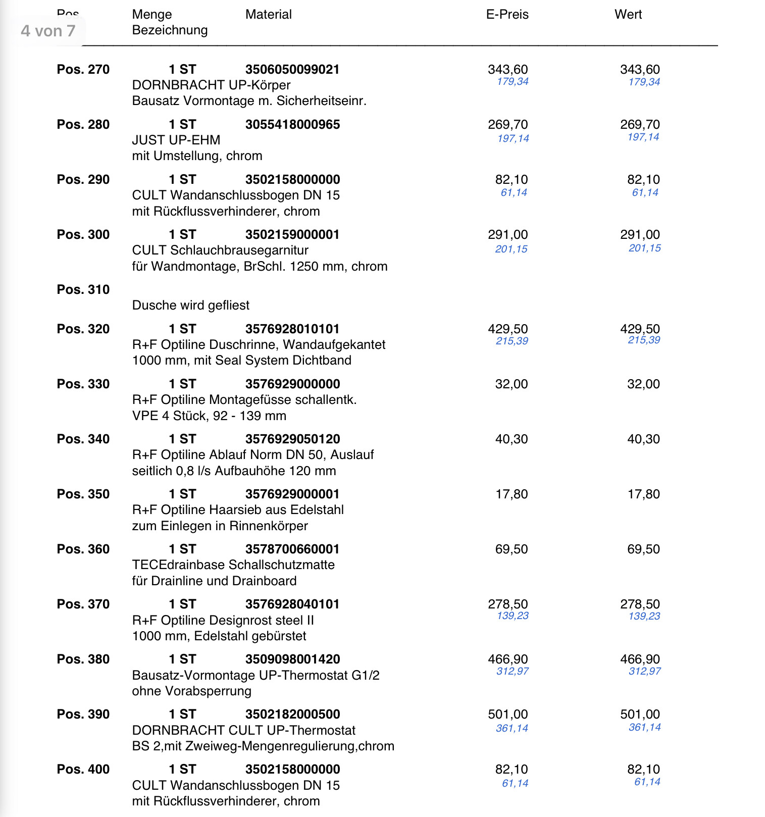

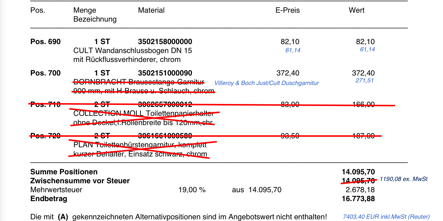

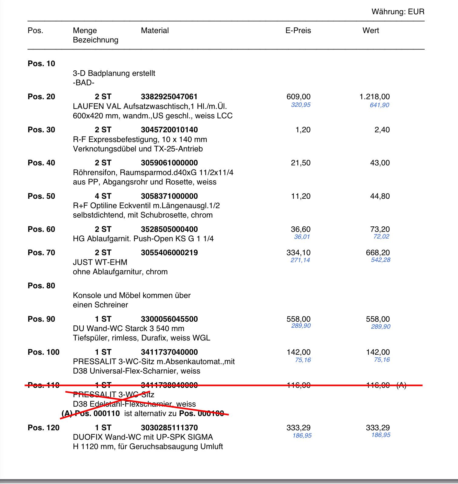

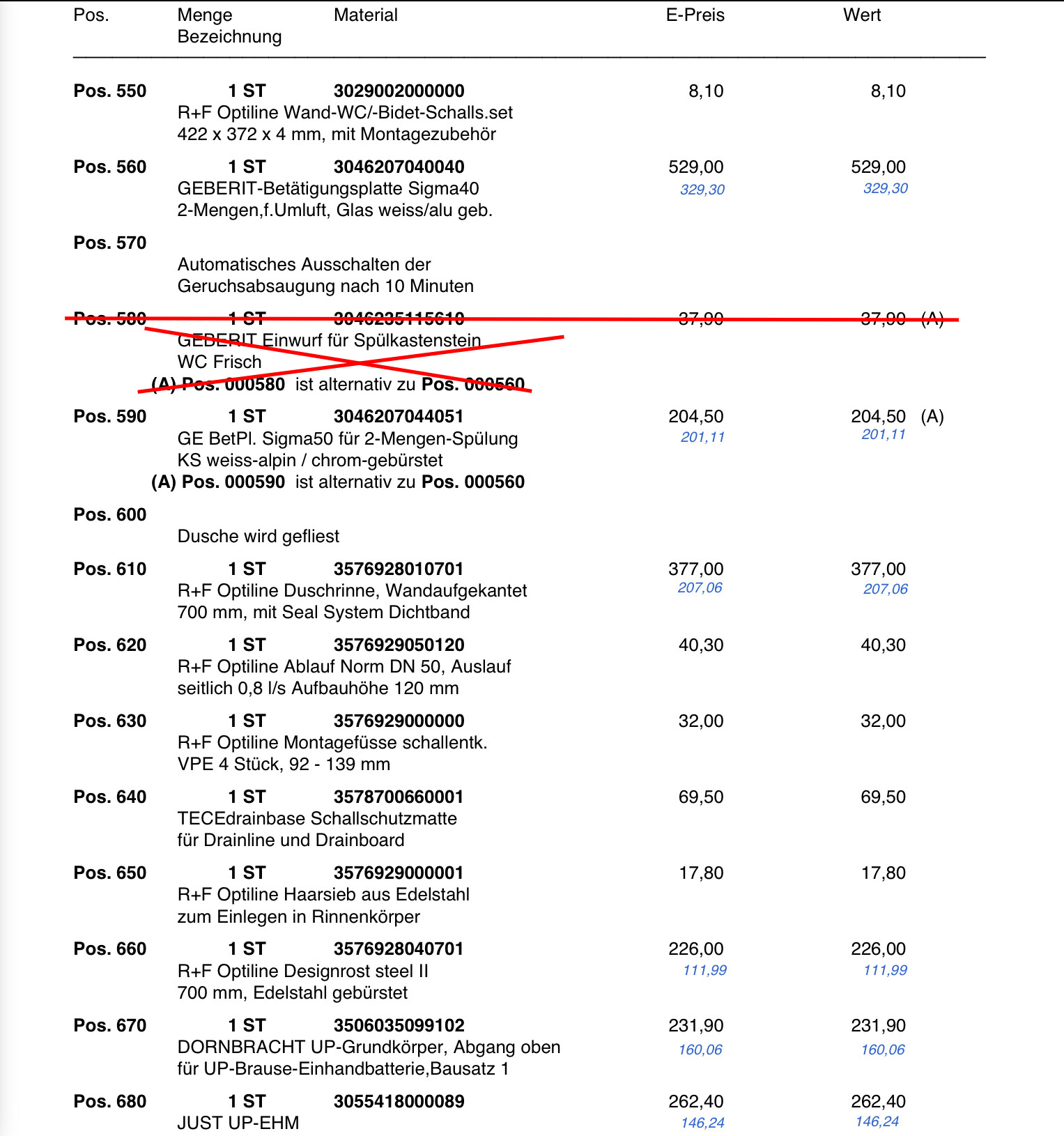

How do you manage to configure everything at Reuter for €7500? Does it include a whirlpool tub or something like that?No, nothing special from my point of view. Maybe the Geberit DuoFresh, but those will probably be removed since the mechanical ventilation system will have to handle the odors. Otherwise, I don’t see anything particularly unusual there.(Prices in blue are from Reuter, gross. Prices in black are wholesale and net!)
