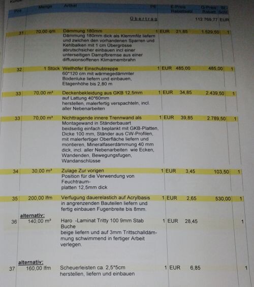

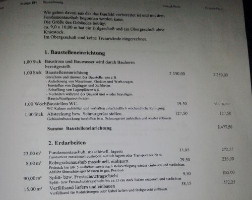

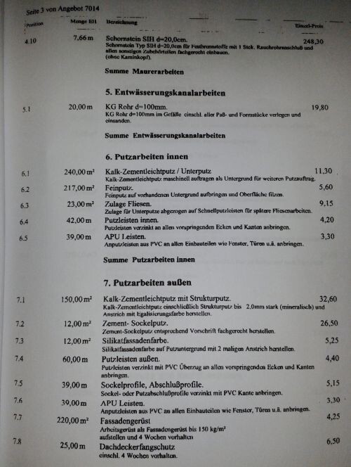

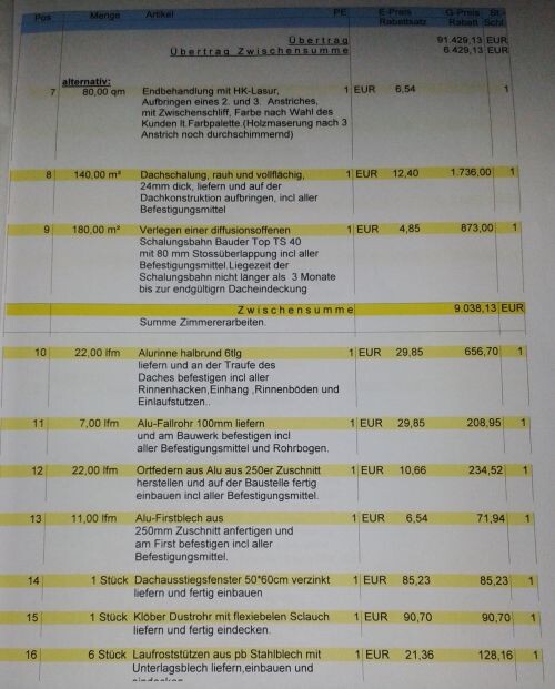

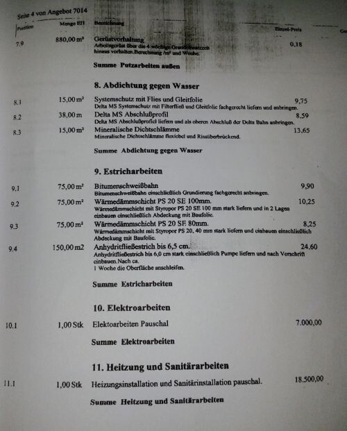

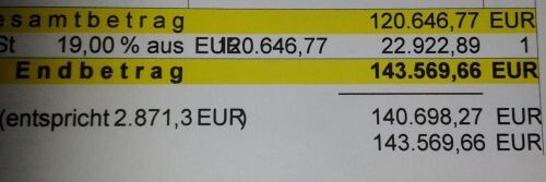

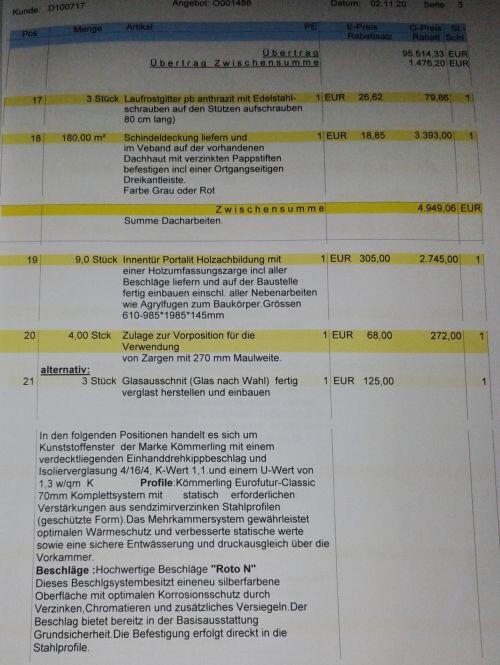

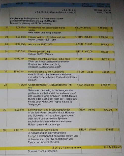

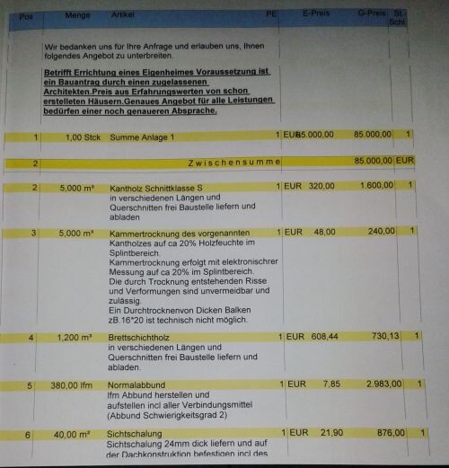

However, we now want to build ourselves and have received a "rough" offer from a local carpenter for a house (see attached pictures 1–4). He is working with a construction company (see attached pictures 5–9), and the "final price" is shown in picture 10 in the attachments.
I realize this is only a very rough estimate, but I’m sure you can give me some feedback on how realistic, expensive, or cheap the quoted amounts are and what might still be missing from the offer.

Image10 The €143,000 is the total price (for both offers).
