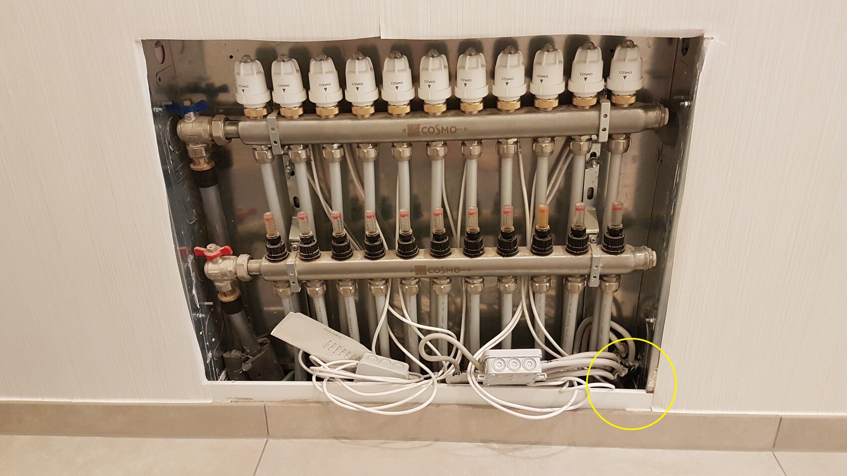

we started building our single-family house with a basement in 2017 and moved in November 2018.
Now to our problem:
On the ground floor, a musty smell comes ONLY from the right corner of the underfloor heating manifold. It is particularly noticeable when the outside temperature drops significantly. Currently, this happens in the evening from about 9 p.m. when there is more outdoor humidity/dew. The problem occurs in both summer and winter. I should also mention that there is always a slight odor in the guest bathroom. We have no pressure loss in the underfloor heating system and no visible damp spots in the house. I sealed the empty conduits once, but the smell did not go away.
We have mainly heated with our stove and hardly used the underfloor heating, but the problem exists just the same in summer and winter. Our contractors are currently a bit puzzled.
I have attached a picture.

Hältebrück19 Aug 2020 12:33And only on the right side then? We still want to check the wastewater pipe in the guest bathroom. We have no apparent issues with water from the outside.
