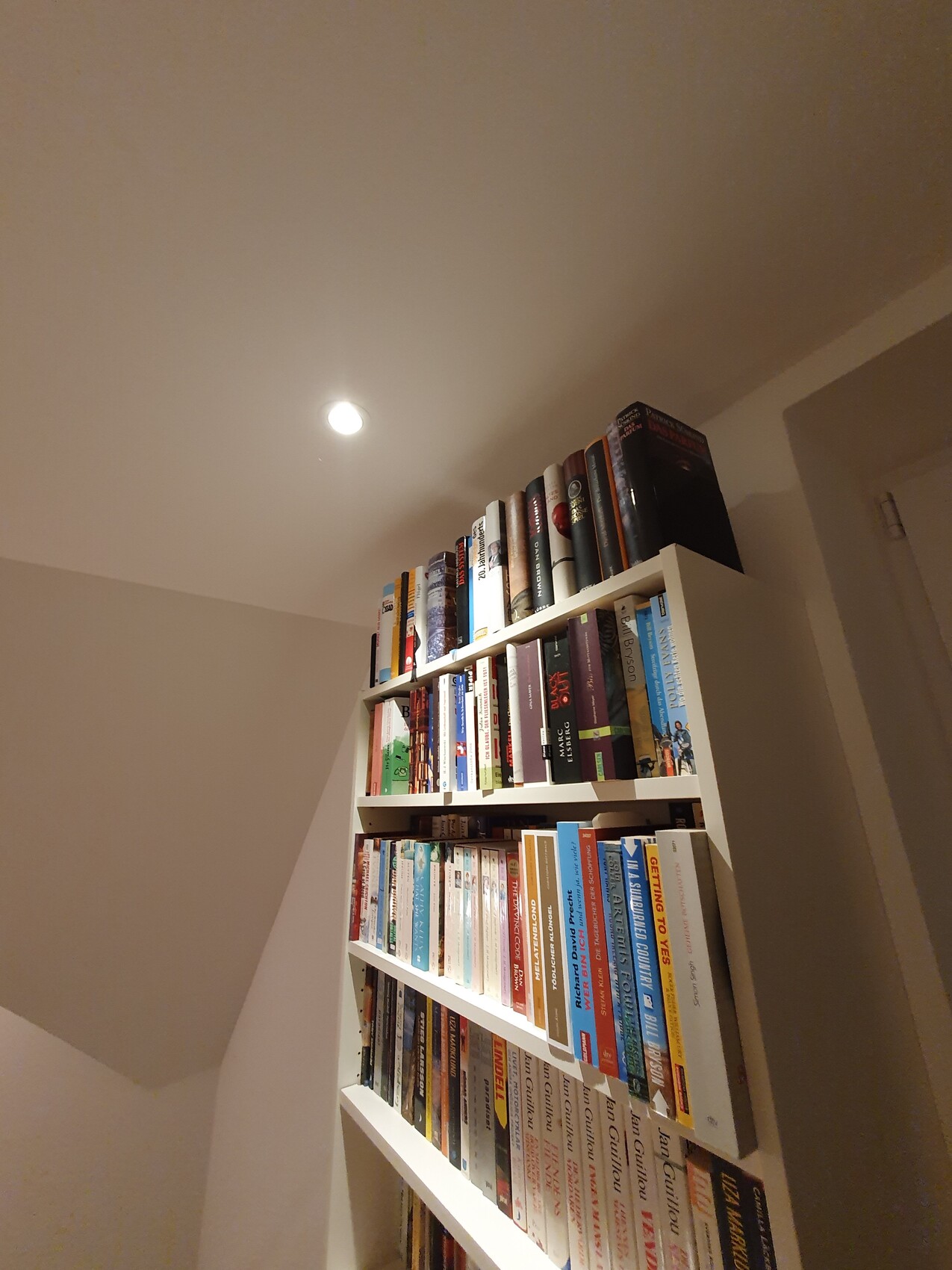

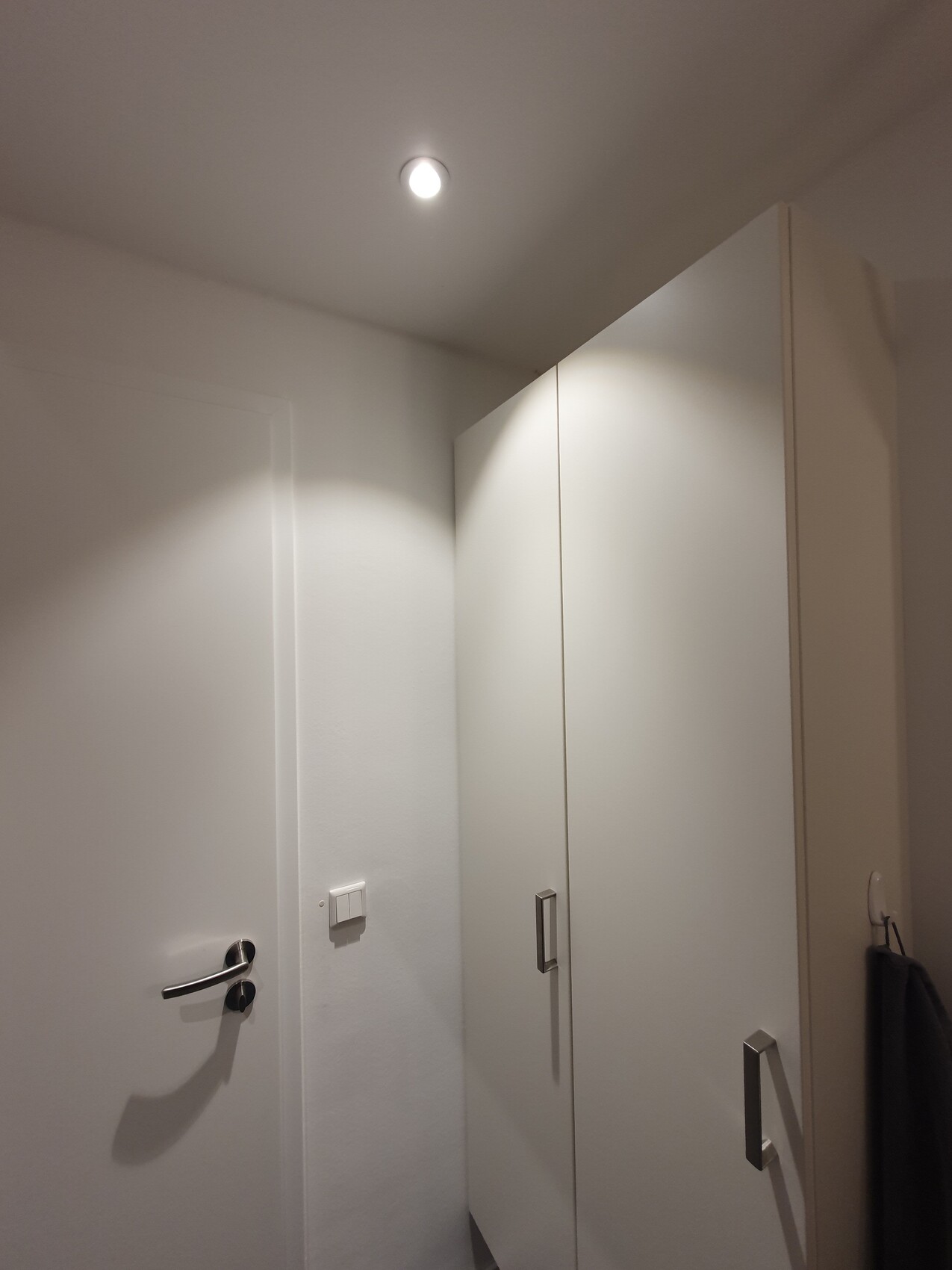

The optimal placement of radiant elements is not in the center of the room, but rather along the sides. They should be positioned 20 to 30 cm (8 to 12 inches) away from walls and cabinets, so that not only the floor is well-lit, but also the light is reflected from the walls.

This was the result of professional lighting design, and we are very satisfied with it.

From Hallway and Bathroom
Wide white bookshelf full of books on the left, wood floor, ceiling light, door on the right
White bookshelf full of books in a living room corner, ceiling light above.
White hallway: door on the left, light switch; light-colored wall cabinets with handles on the right, ceiling light above.

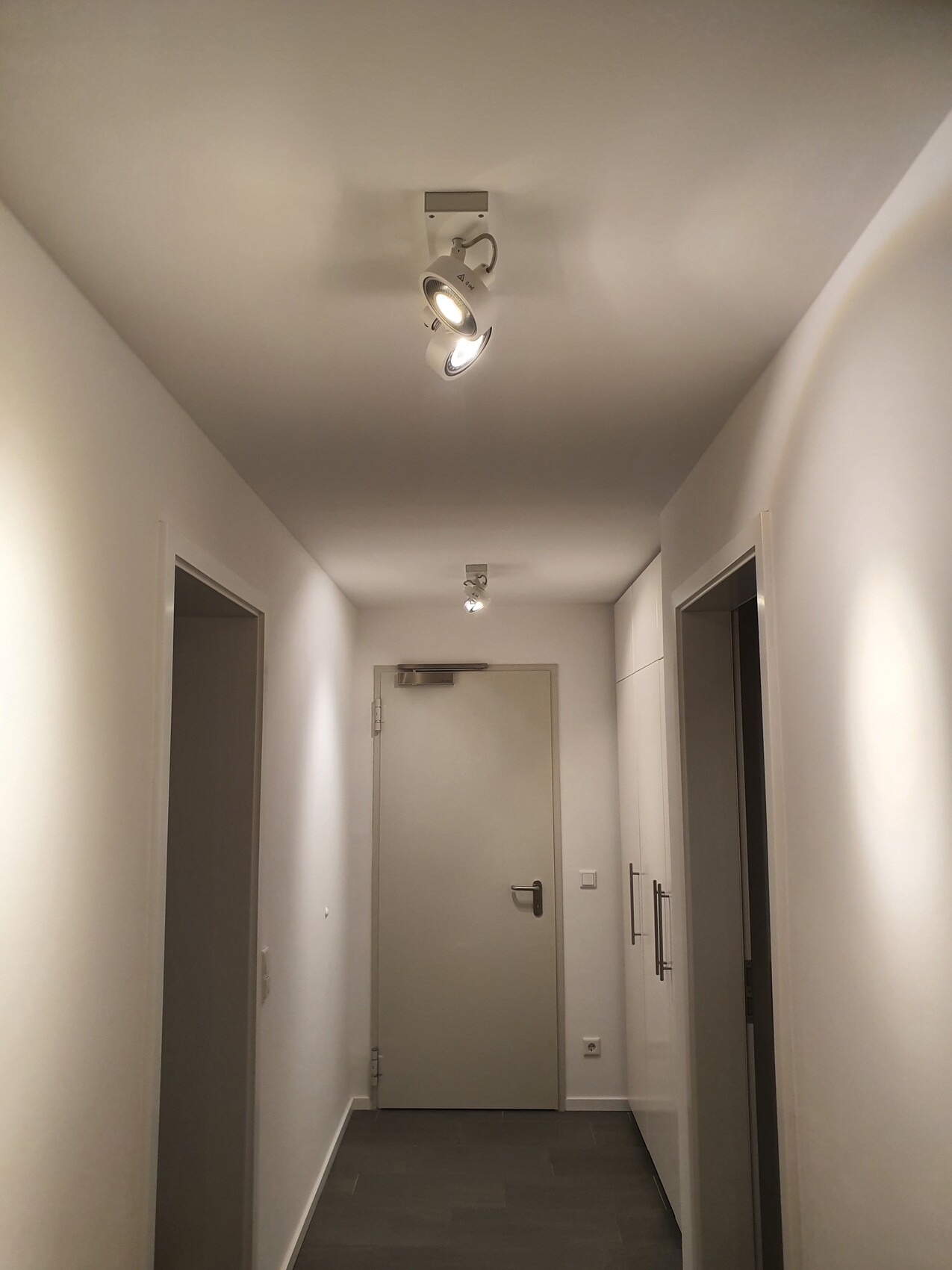

Alternatively, we used adjustable spotlights in other areas
Bright hallway with white walls, gray floor, doors on the left and right, door at the end, ceiling spotlights

What are the values in the hallway, and what diameter do you have there?
Hallway and bathroom? Are they warm white or cool white, respectively?
