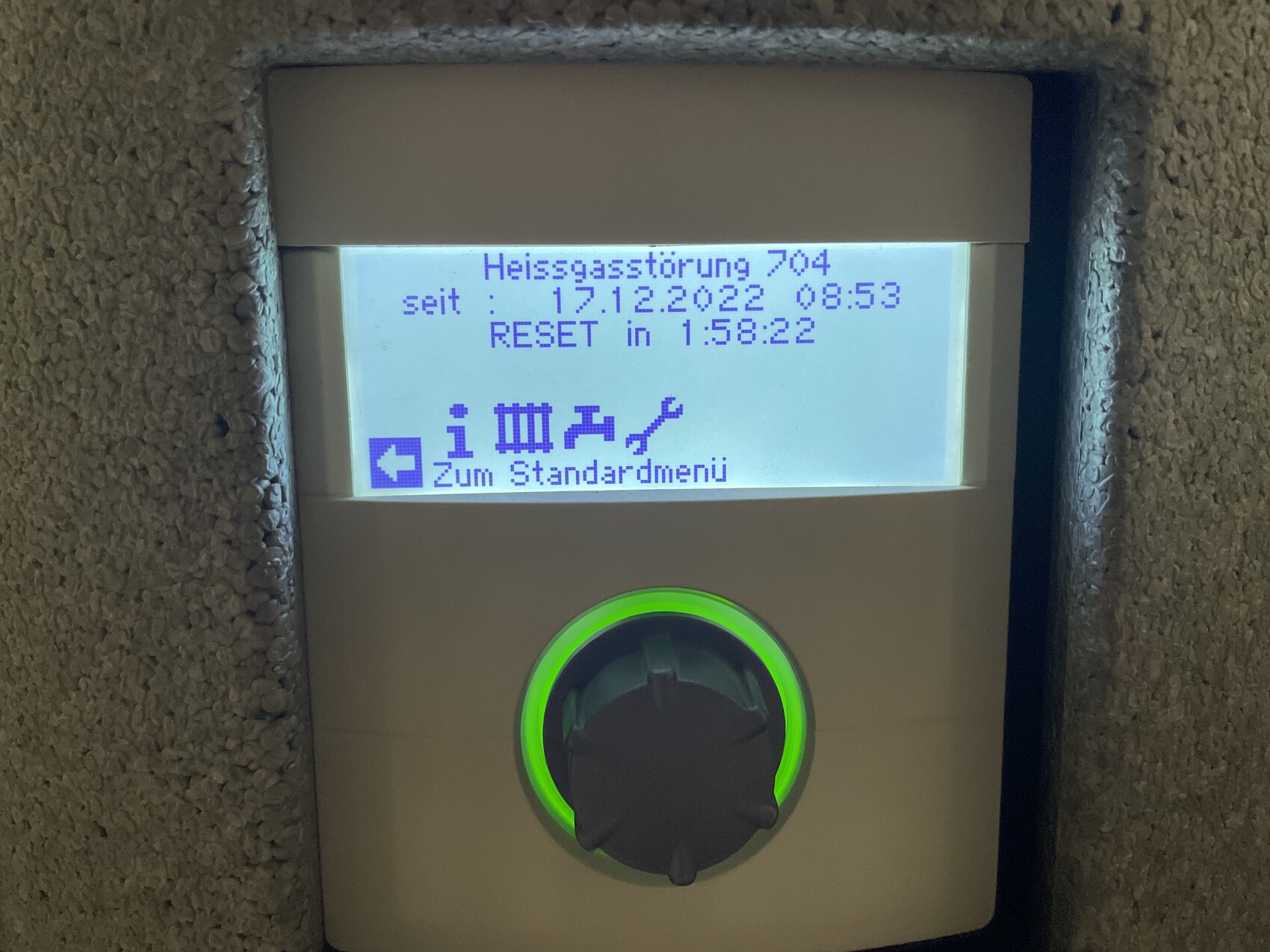

our heat pump just displayed an error message: high gas fault, error code 704. We have a heat pump from the brand Novelan. What should we do?
Would you call an emergency service immediately? I’m feeling a bit overwhelmed right now. It is -11°C (12°F) outside.
Thank you very much and best regards
Anzeige zeigt Heissgasstörung 704, Reset in 1:58:22, Knopf mit grünem Lichtring.

Hello @chewbacca123
I finally managed to review the data.
The operating pattern of the heat pump looks good. You had 22 compressor starts over 2 days. For the size of the heat pump relative to your house, this is a reasonable number. What stands out are the frequent domestic hot water cycles during the day. This is caused by the continuous circulation during daytime, which empties your hot water storage tank. Reducing this is more a matter of comfort, but it could also save some costs.
Unfortunately, I cannot give a clean bill of health. During hot water production at around 2°C (36°F) outdoor temperature, the maximum discharge gas temperature is close to 108°C (226°F). During the recorded period, the highest discharge gas temperature was 109.1°C (228°F).
Back in January 2021, at comparable outdoor temperatures, your maximum discharge gas temperature was around 85°C (185°F). I am concerned that at significantly lower temperatures, the heat pump will again face issues with excessive discharge gas temperatures during hot water operation.
What can be done? Not much. Settings to protect the system would be:
- Reduce the target domestic hot water temperature to the lowest acceptable value. In 2021 you had a target of 49°C (120°F), now you are at 50.5°C (123°F). Every degree reduction helps. Maybe you could try 48 or 48.5°C (118 or 119°F)?
- Reduce the circulation. This decreases the number of hot water cycles and thus reduces stress on the heat pump.
- Keep an eye on the maximum discharge gas temperature as outdoor temperatures fall, and if necessary, switch the domestic hot water production to the electric heating element. If you load the DTA data into OpenDTA, you can easily check the maximum discharge gas temperature in the Statistics tab.
In general, there have been many reports recently of compressor failures in the LAD series. Other series operate very reliably. Exact information from Novelan/Alpha Innotec is, of course, not available. If a compressor failure requiring replacement does occur, you should openly discuss this issue with Novelan customer service. When replacing the compressor, insist on an acid test of the refrigerant to prevent another compressor failure in a short time.
Other causes could be refrigerant loss or a faulty expansion valve.
For discharge gas temperature problems, customer service through your heating installer is usually the first contact during the warranty period. Alternatively, a specialized refrigeration technician (if available nearby) who also services heat pumps is often more competent than the heating installer.
