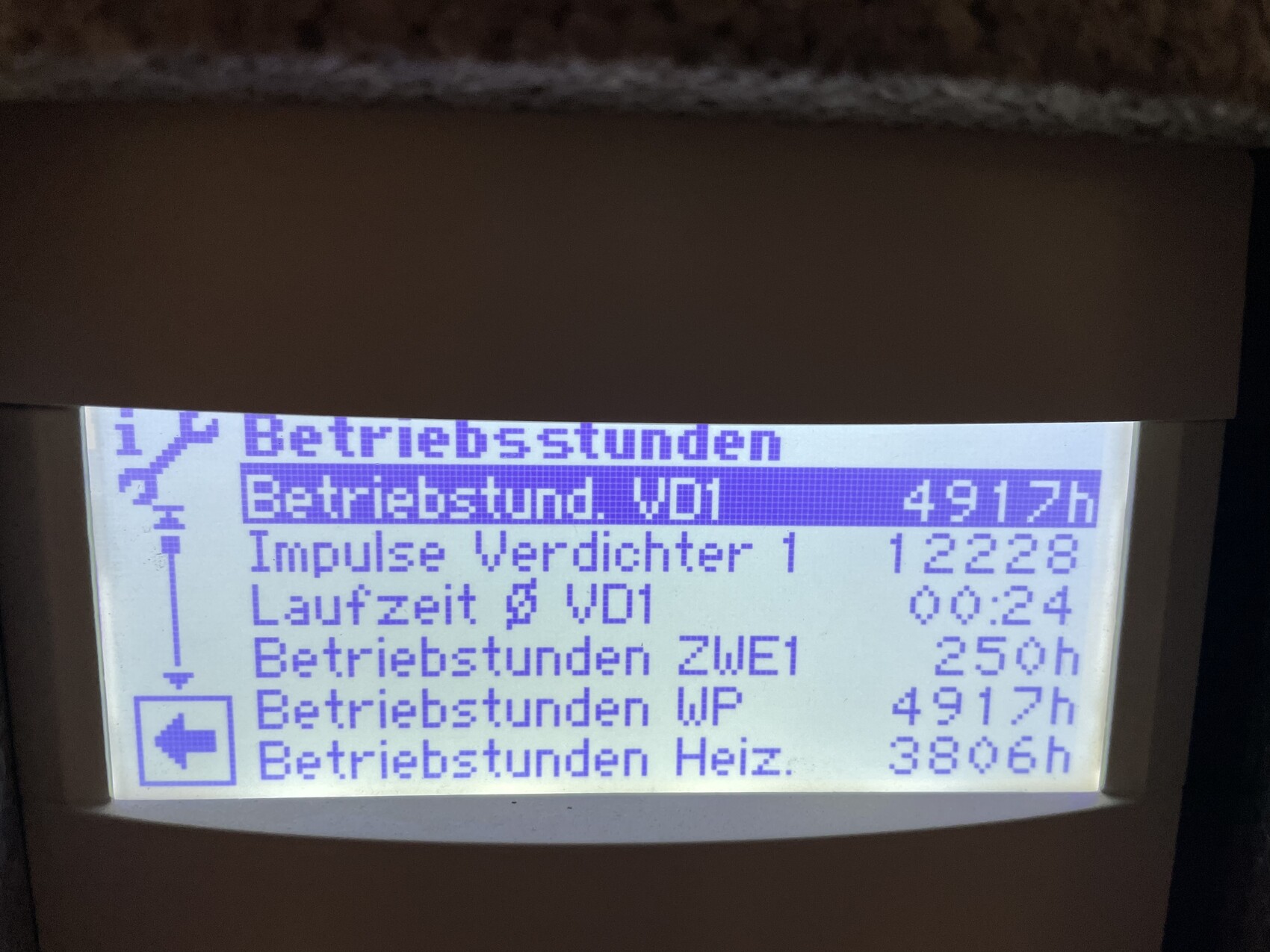

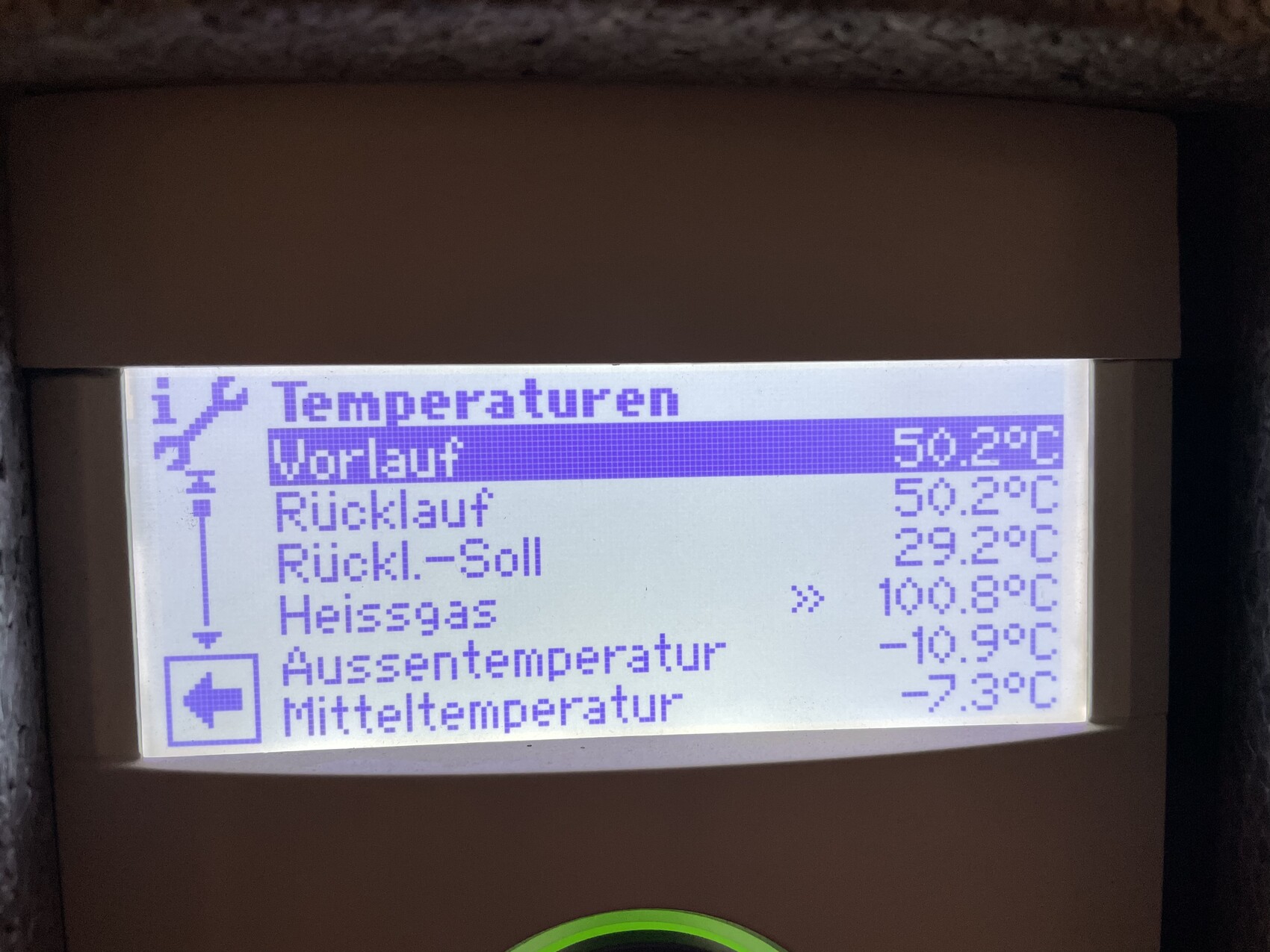

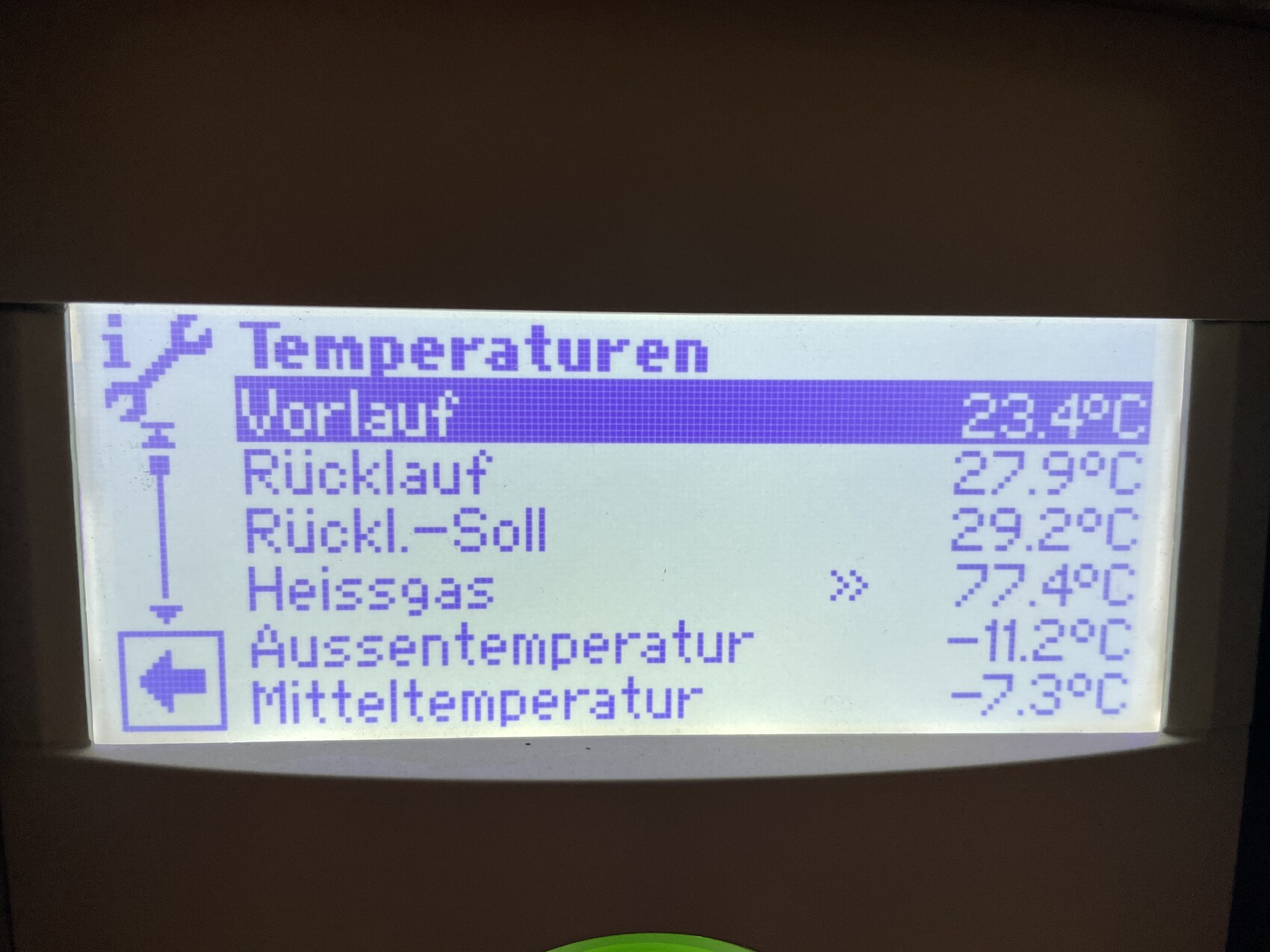

- Okay, new update: after the reset, it’s working again. What could it have been? The heat pump is currently running and heating.
What do you think it was, the sensor? I’ve attached current data in photos, does that help?
No one said that everything is broken. However, sensors can sometimes fail after just one month. That’s simply how it is, and a compressor can get damaged if it overheats, which can even happen right when starting up.
A pump or its controller failing after 3.5 years is also not unusual, even though ideally, you’d want it to last 20 years or more.
In your case, the system has now cooled down and you performed a reset, so now you just have to wait until the issue occurs again. If nothing happens, it might have been a one-time glitch or a sensor/measurement error. If the problem comes back soon, then it’s time to investigate the causes.
