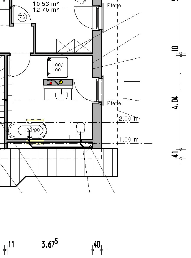

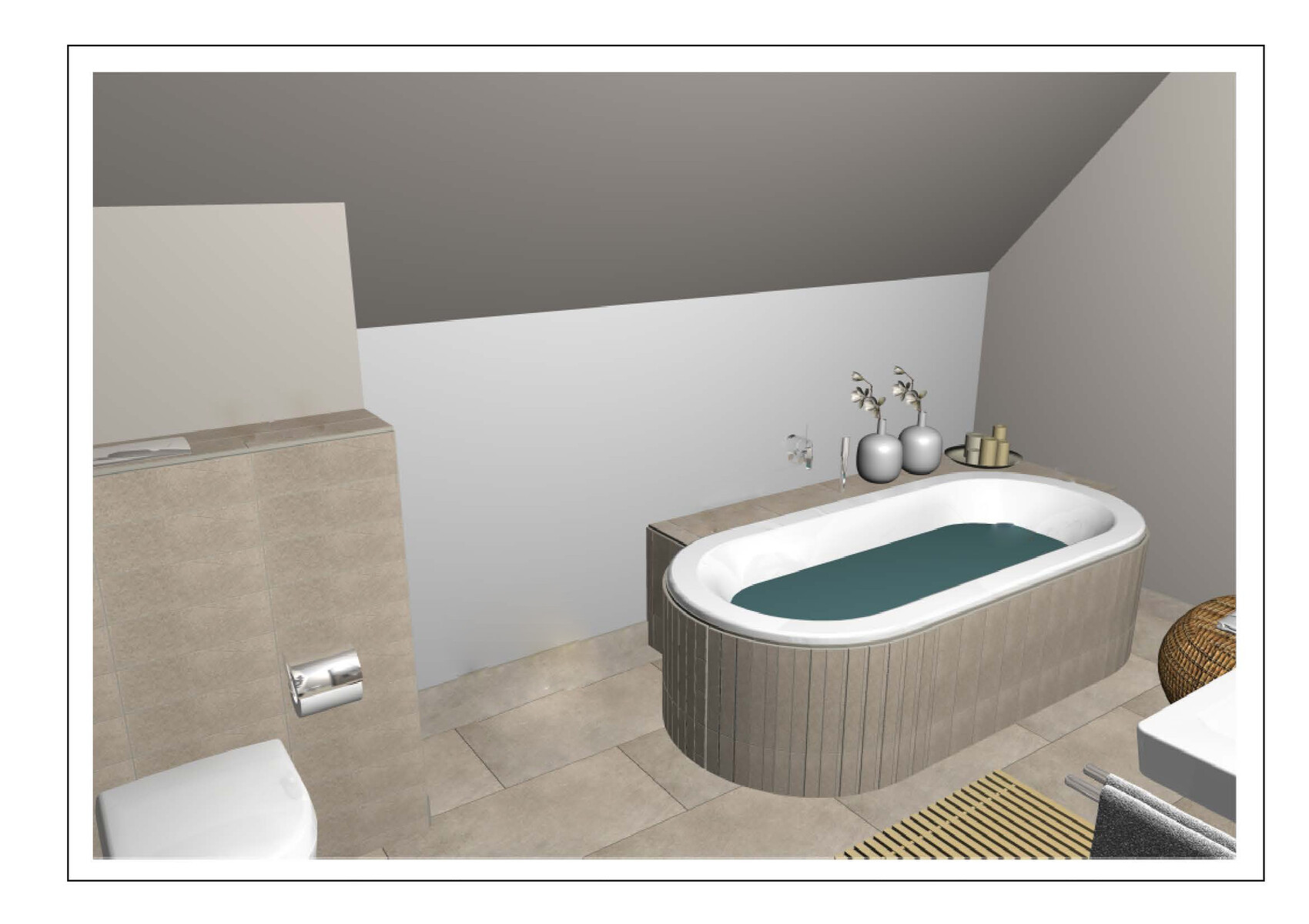

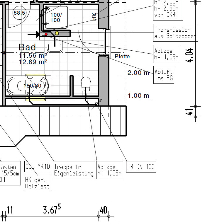

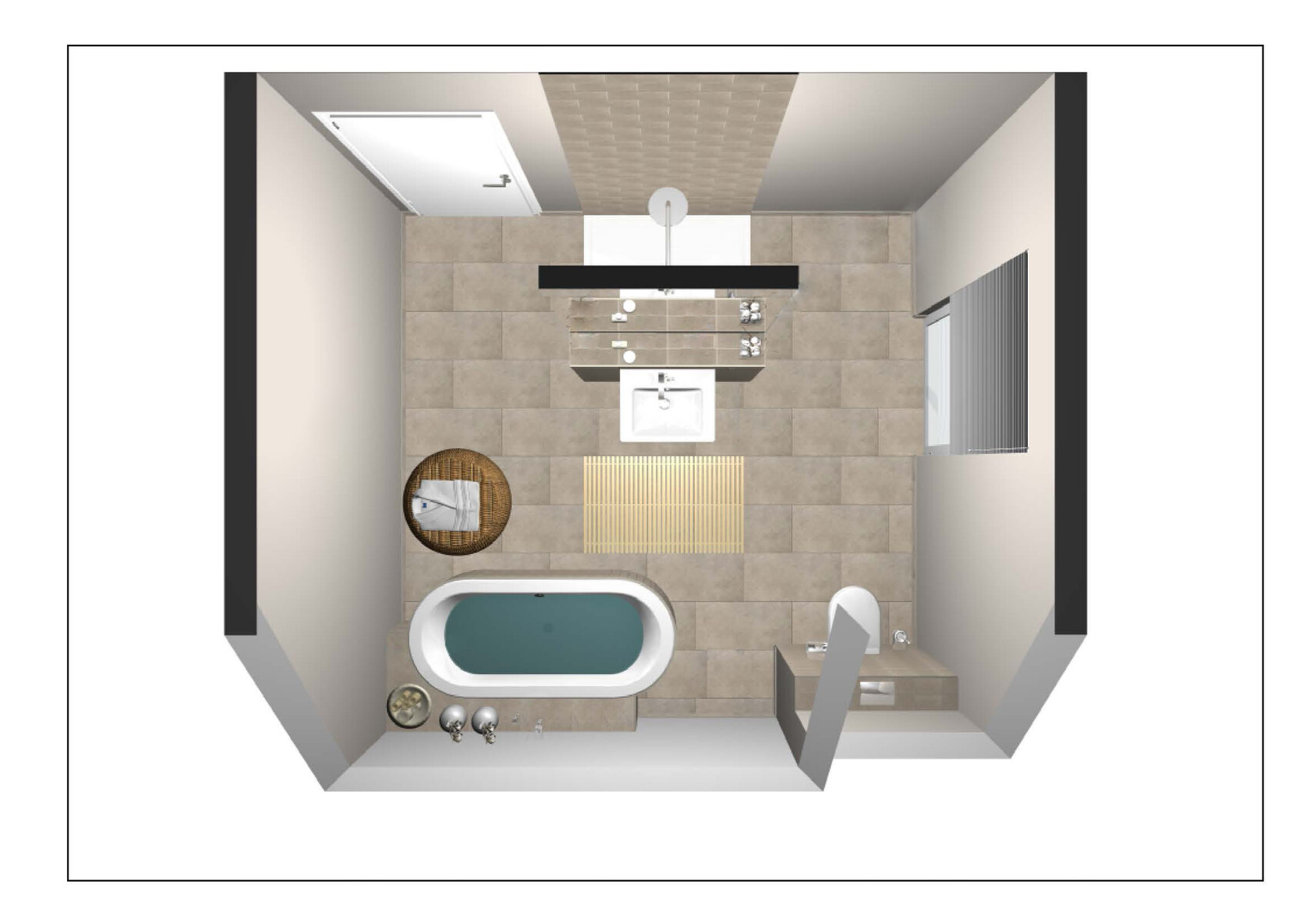

Attached are some pictures of a design we received for our new bathroom. Unfortunately, we are not completely happy with it yet.

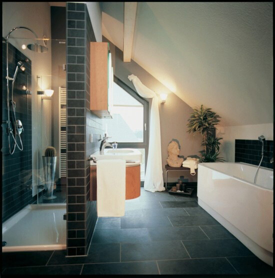

Maybe you have ideas on how we could better arrange the bathroom, or suggestions for tiles, or other details... We once found a photo (also attached) that we liked quite a bit in terms of layout. But perhaps you have very different ideas for how to arrange the bathroom.
For that reason, I have also included the floor plan (with dimensions).
There is also a roof window above the bathtub. So we have a floor-to-ceiling window and the roof window.
We actually want the bathtub to be freestanding, not tiled around as shown in the illustrations, but possibly just with a shelf or ledge against the wall. A corner bathtub might also look good, but freestanding simply feels softer, rounder, and less angular.
As I said, we would be very happy and grateful for any ideas or suggestions!

Thank you very much for the responses.
I would like to briefly explain one or two reasons behind the planning:
- Between the bathtub and the toilet, we do not want any "privacy screen" because it would make the bathroom feel smaller, cramped, and divided, which we want to avoid.
- Also, we find modern toilets quite "compact" and not something that needs to be hidden.

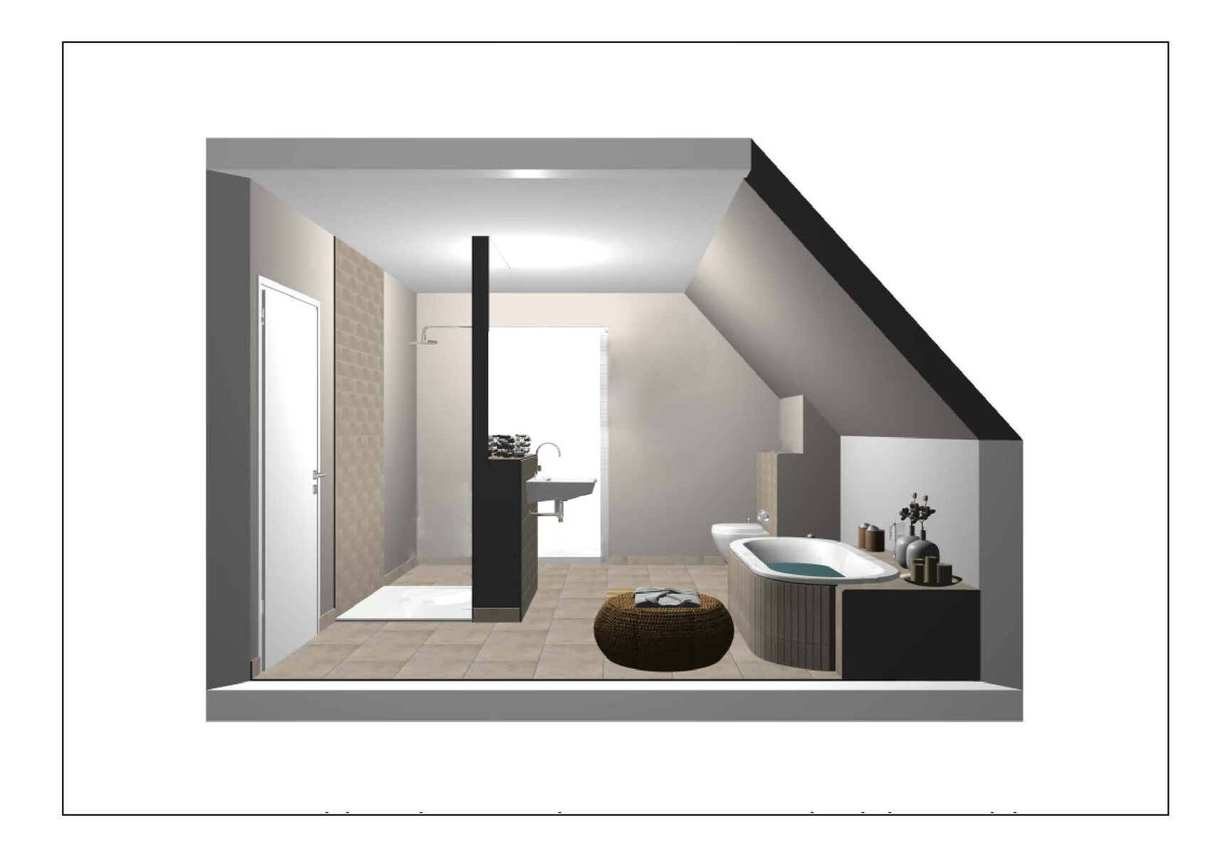

(In the photo showing the side view of the bathroom, we don’t like the wall where the toilet is installed. Why does it have to protrude so far? We still need to inquire about that.)
We actually like the floor-to-ceiling window in the bathroom, as it provides plenty of light and makes the room appear larger. Additionally, when showering, we would simply pull something in front of the window (a pleated blind).
The shower should be visible from both sides but only accessible from the window side. On the side when entering the room, there should be a fixed glass panel. We also do not want a solid wall here as shown in the floor plan, because the glass panel makes the bathroom appear larger again and allows more light to enter the room (not only from the skylight above the bathtub but also from the side). What we will change is that we will shift the shower including the partition wall next to the washbasin slightly to the right (towards the window) so that you don’t face a wall right when you enter and there is more space when entering.
We are not very fond of corner bathtubs (don’t they consume too much water?).
We are also not sure yet if we want a freestanding bathtub with a shelf area next to the wall (see 3D design) or a classic rectangular bathtub as in the floor plan. Freestanding tubs are of course more expensive, but we thought that freestanding bathtubs visually open up the bathroom and just look nicer (?).
What actually limits our bathroom design the most is the position of the entrance door as well as the roof slope.

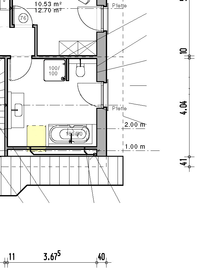

I have attached two designs that we currently favor. Unfortunately, we’re still not quite sure which one we prefer. Do you maybe have any ideas or opinions on this? That would be very helpful!
(P.S. The yellow area represents the skylight)
Thank you, Stube

In the example image, the toilet is placed against this wall so that it reaches the 2-meter line (6 feet 7 inches).
As a rule, the front edge of the toilet should be at the 2-meter line to allow standing space in front of it… for cleaning or similar tasks 🙂
I find drawing 1 quite appealing!
I would only highlight the bathtub a bit more by adding side and rear platforms (for placing items and decoration).
I’m also not a fan of the partial walls around the toilet (privacy screen), but it might be useful for larger families.
I would plan the shower to be at least 120x90 cm (47x35 inches) rather than 100x100 cm (39x39 inches); that would be too small for me. Also, I agree that floor-to-ceiling windows in bathrooms are pointless—better to have a larger regular window instead. It usually ends up being covered halfway or something similar anyway.
A corner bathtub is actually much cheaper than a freestanding one.
There will probably be something placed in front of the toilet anyway, I think. I would keep it in the corner, and when you enter, your view will be on the bathtub rather than into the back left corner.
a782290 schrieb:
- Also, we find today's toilets quite "visible," meaning there’s nothing to hide.
(In the photo showing the side view of the bathroom, we only dislike the wall where the toilet is mounted. Why does it have to protrude so much? We still need to ask about that.)
Thank you, StubeThis has to do with the pre-wall installation system the toilet is attached to... it must be anchored in the floor and also has a specific height... since you probably don’t want additional costs and a standard toilet along with a standard system will be installed, it has to protrude that far...
Additionally, water and drainage pipes have to be concealed somewhere... plus venting of the stacks...
Thank you very much for your opinions!
At the moment, we prefer option 1 (ENT_3) because not everything is placed "traditionally" along the walls, making it look more modern and open. In this layout, the bathtub would be positioned directly under the double casement window. There would also be a platform around the bathtub for placing items (which is missing in the drawing). We don’t find a “true” corner bathtub very appealing. So, it would either be an oval/round freestanding tub with a platform at the back, or a classic rectangular tub with a platform at the back, positioned in the corner as shown in the drawings. However, we wouldn’t place a freestanding (round/oval) tub angled into the corner anyway, as the bathroom is not large enough.
Ultimately, it’s mainly a design and cost decision which type of bathtub to choose. Although, I’m personally more drawn to the idea of entering the bathroom and facing a round tub rather than a corner one.
Making the shower larger is a valid point. I think this will depend on whether we opt for a tiled shower tray, a pre-formed tray with a minimal edge, or a walk-in (level-access) shower. We’re currently divided on this as well. Which option is more hygienic? (Tiles have grout lines that can harbor dirt(?), and they might also be harder to clean?)
Well, I have a tiled shower, so cleaning is understandably a bit more labor-intensive... with a shower tray, you basically just wipe over it... so any other system is more difficult to clean than a white acrylic or steel tray.
On the other hand, you gain a lot in terms of appearance, the shower becomes naturally slip-resistant due to the grout lines, and the heat from an underfloor heating system, if installed, is better transferred... making showering more comfortable and drying afterward much faster.
