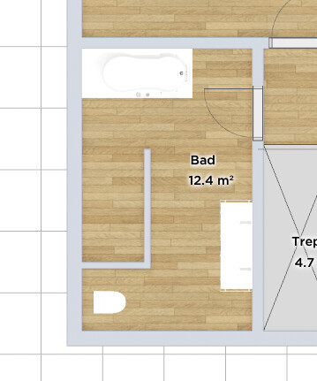

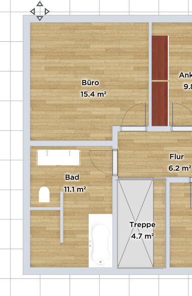

The layout of the bathroom upstairs—neither in the standard plan nor in our own design. The standard plan is rather unimaginative, and I feel it will look dated afterward. In our floor plan, I feel the room tries to be more than it is—a forced T-shaped solution.
I would appreciate your input here! Whether other ideas or arguments for or against the standard or our own design—everything is welcome.

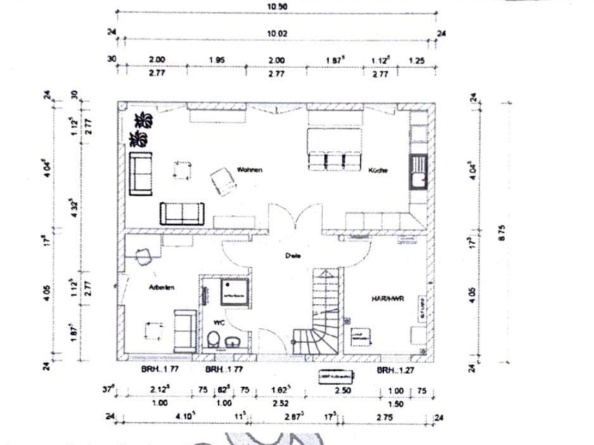

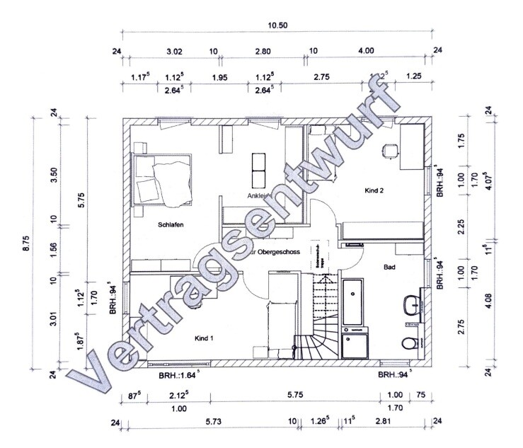

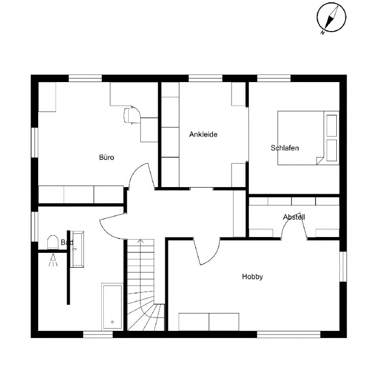

[ATTACH type="full" width="500px" alt="Obergeschoss Grundriss mit Schlafzimmer, Kind 1, Kind 2, Bad und Treppenhaus">

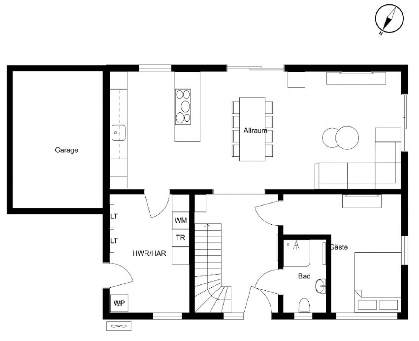

Standard floor plans (unfortunately I don’t have better views, especially of the ground floor; the Town & Country website shows the floor plans also in a “prettier” way but without dimensions)

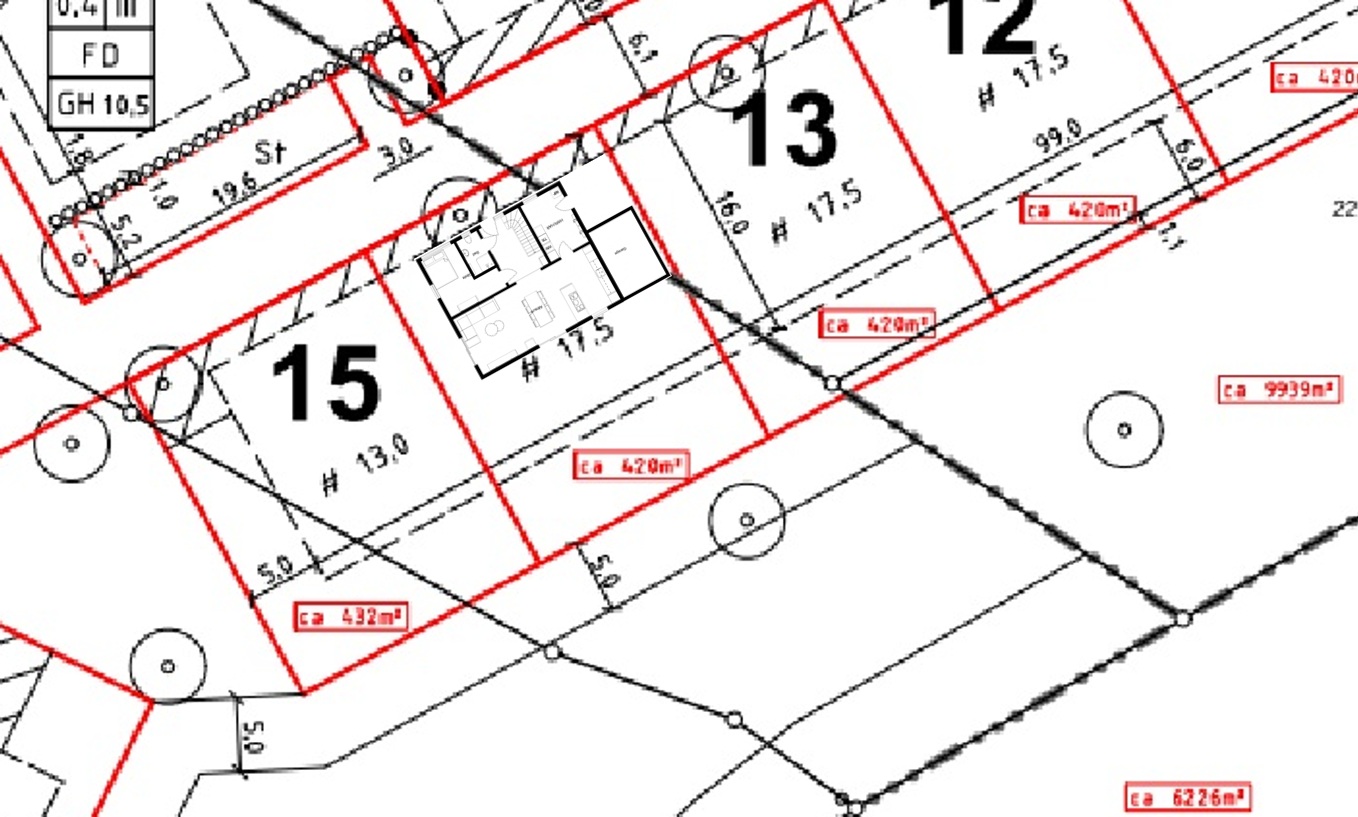

Site plan oriented north (red line: property boundary; black line: building envelope)

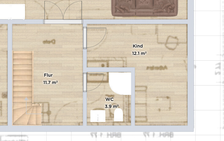

- Relocate entry door for the utility room from the hallway to the kitchen The idea was to gain space in the hallway for a larger cabinet under the stairs, which I would like to extend along the entire wall. Since the utility room will also serve as a pantry, I found the shorter route from the kitchen an additional advantage. The downside is that carrying laundry will be a longer route. Cooking to washing (for two people) seems okay to me. To avoid carrying groceries through the entire house, we opted for an additional exterior door in the utility room that connects the parking space in front of the garage to the utility room.
- Shift double window in the living room to the side of the house We have a fairly large TV, and I don’t like sofas facing away from the room. In the standard plan’s “window front” there was no glare-free wall where we liked the TV position or the sofa placement. Therefore, we gave up the small fixed glass element on the house side, “moved” the large window element over, and now have enough space to fit a large sideboard and the TV. In general, we shifted window positions in the standard plan at several places to adapt them to our layout (e.g., bathroom upstairs).
- Change from “entry through bedroom” to “entry through walk-in closet” I think this is self-explanatory—I wanted to have the bedroom at the end of the corridor-walk-in bed chain so that whoever *cough* sleeps longer has peace and quiet. This created a relatively large empty corner inside the bedroom. Since we don’t want to place wardrobes or other furniture like armchairs or sideboards there, the corner felt useless. We trimmed it off and converted it into a storage room. It is accessible through the hobby room since I want to keep the hall free for a console table or a picture on the wall (so no third door).

NiWi_NRW schrieb:
We want and will replace our 90sqm (970 sq ft) miners’ cottage from 1918 with a Flair 152 RE, hopefully built in 2026. [...] Our current living situation is characterized by "where should I put this" and "Honey, please carry all your shoes upstairs" – in short: no storage space, no entrance area, a confusing floor plan with walk-through rooms, and three very small floors on a typical narrow miners’ parcel. But that is just the background – we are talking about the untouched plot shown in the site plan; the currently occupied plot has nothing to do with the planned future (?)
NiWi_NRW schrieb:
The bank was a bit nervous about "architect and direct contracting," and honestly, we were too, so we are opting for a catalog home. What does the bank do professionally, and where does your nervousness about this come from?
I am a big fan of the well-established catalog design, but only secondly not for silly reasons, and firstly the proven catalog design is really only advantageous if the builder has already constructed it several times themselves (experiences of some franchise colleague unfortunately don’t transfer).
I will happily consider your thoughts over the next few days.
How wide is the plot? You mentioned a double garage, but I only see a single-width one.

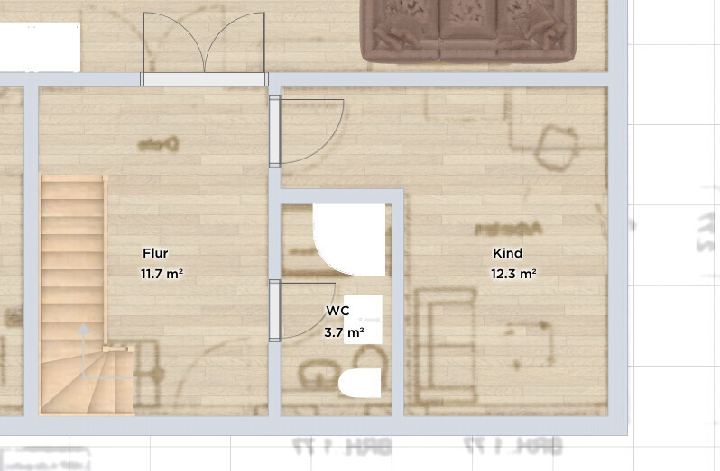

And then you have to go through the kitchen and dining area to get to your cloakroom. From here, I’d start thinking about the location of the main entrance and other floor plans.

I think the simpler a bathroom is, the more timeless it looks. Then nice tiles and furniture really stand out.
From there I wonder why you’d want to screen off the toilet with a privacy wall if you’re probably getting ready separately anyway.

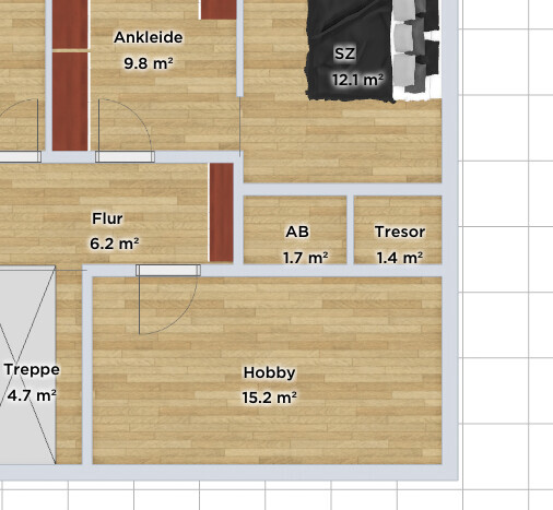

Haha, you made the bedroom narrow yourself.

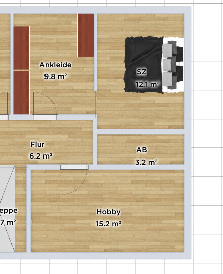

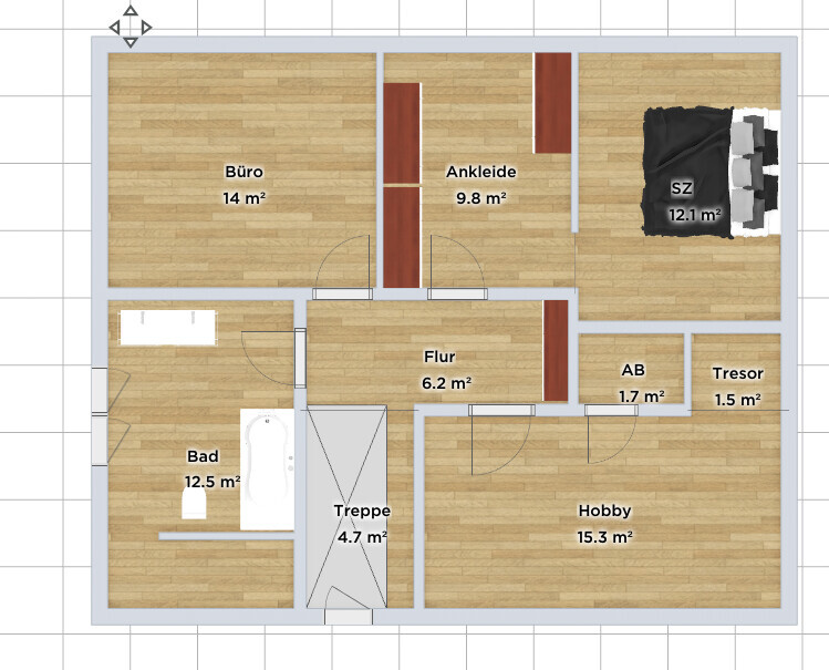

I sketched the house because I didn’t quite believe some of the dimensions. You drew the walls relatively thin and the builder’s furniture a bit small, etc.
Regarding the kids’ room with the bathroom, I’d pay attention to what suits you better.
Also, for the door to the dining area, make sure there’s enough space under the stairs on the left side of the plan, so move the door towards the right side opposite the main entrance.
Here’s the hobby room, where I’d probably create a safe niche.
And here’s the difference between a spacious bedroom and the smaller one as you want it. I’d put the bedroom door to the side to make it calmer next to the wall.
Oh, and I usually use 90 cm (36 inches) doors upstairs. I gave the hobby room a 100 cm (39 inches) door.
And here’s the bathroom, how I wouldn’t do it.

In our floor plan, I get the feeling the room tries to be bigger than it actually is. Forced T-layout. I’d appreciate some input here!
Yeah... personally, I think a T-layout is the most awkward solution. Lots of corners make a bathroom look cluttered. The width really needs to be right if you want to separate about a meter (roughly 3 feet) there.
NiWi_NRW schrieb:
This removes the “bottleneck” between the washbasin and bathtub,
The bottleneck is still there, though.
NiWi_NRW schrieb:
The standard floor plan is very uninspired, and I feel it ends up looking outdated quickly.
NiWi_NRW schrieb:
so that the one who sleeps in *ahem* a little longer,
NiWi_NRW schrieb:
the little toe is already happy...
Otherwise, you get a lot of usable space with this house—as a couple, no less.
Nevertheless, there are always sensible alternatives, e.g., reducing the size of the technical room to accommodate the hobby room (basement alternative) with garden access on the ground floor and create a utility room upstairs. There’s plenty of space to play around with daily life and functions.

First of all, Happy New Year to everyone 🙂
I'll go through it step by step:
@11ant The preliminaries are just that, and I don't think they are so extensive that you can't skip them. For individual contracting, the bank—which, by the way, runs an illegal laundromat as a main business and only operates banking for money laundering purposes ;-)—would only participate if refinancing of an additional 30 or 40 percent beyond the required amount (I don't remember exactly) could be made possible without problems, or if there was enough extra equity set aside to cover that amount. Surprise: both were tight. My own caution, on the other hand, is work-related; I have seen too many failed and endlessly delayed construction projects, with most affected homeowners reporting hefty additional costs and problems with refinancing. So, you could say the bank and I actually have the same reason. That may seem stupid to you, but since I can still sleep peacefully at night with our approach, I accept it!
@ypg A double garage is not planned—it really wouldn’t fit with 17.5 meters (57 feet 5 inches). A single garage is sufficient for the two motorcycles; they have been stored in such a garage until now and there is enough space. Our cars are surprisingly water-resistant and will continue to be parked alone, exposed to the elements on the parking spaces 😀 Joking aside, I don’t want to completely rule out the possibility of a carport sometime in the future, but it is not planned so far.
Regarding the floor plan: I understand your points, especially about the entrance and the “dragging-through” issue on the upper floor. May I ask which floor plan from Town & Country personally appealed to you more? You mentioned you would have spontaneously chosen a different one. Honestly, we haven’t considered a side entrance yet, without being able to give a specific reason for that.
If we reduce the size of the utility room in favor of the hobby room, I’m afraid I’ll run into storage problems again on the ground floor (here it is again, the storage trauma…). We basically only have closet space on the upper floor, and I wouldn’t want to store cleaning supplies, vacuum cleaner, and provisions up there.
As for the bathroom: Why exactly we want a wall around the toilet... probably just because it’s currently trendy. It feels like I see hardly any bathrooms without one anymore. But after critically reviewing our weekly routine myself, I realized we don’t really *need* it and we are more flexible without it. So we will take another look at this.
I like your side passage from the dressing room to the bedroom much better and will therefore copy it one-to-one.
